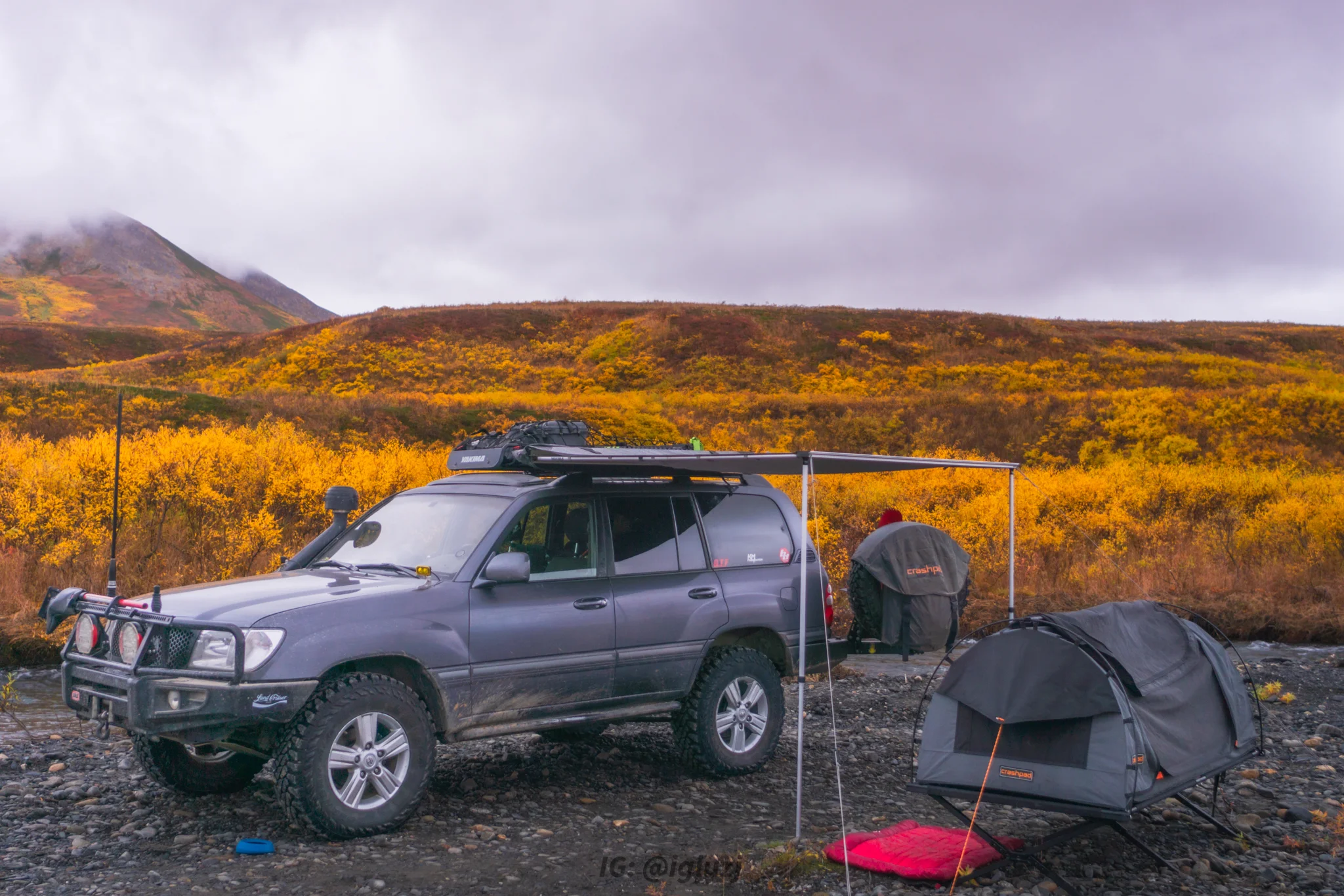

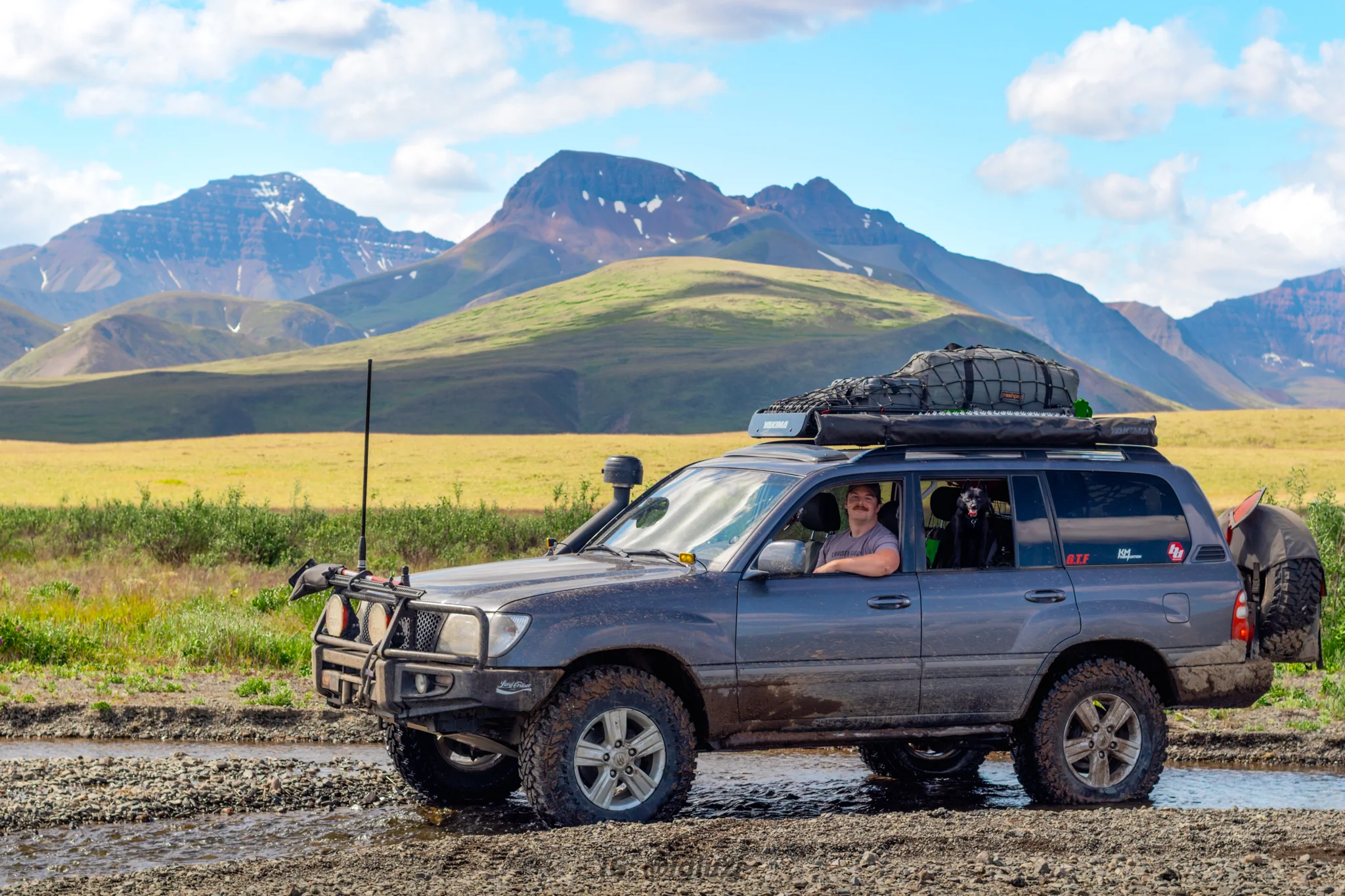

1. Exterior Setup Goals:
Summer trails in AK generally involve small to medium sized rocks, steep descent / ascents, occasional ruts, mud, and water crossings that can be over the hood. For my use, touring is mostly summer oriented, with longer trips in Alaska both on and off the road.
Off-roading in the winter includes driving in the dark, so lighting is more important here in the winter than most places #lightbarsbeforelockers. The flip side is they don't get used at all in the summer unless conditions are dusty. Tried to organize this list front of the rig to back.
- Summer Tires: 285/75R18 Yokohama G003 MTs on ~2012 200 Series wheels.
- Winter Tires: 295/70R18 Falken Wildpeak AT3W on OEM 100 Series wheels
- BORA .75" Wheel Spacers (front only)
- Regeared w/ Nitro 4.88s
- Eaton E-Lockers F/R
- OME Nitro Sports ~2" front lift w/ 2864 Rear Springs lifting ~3"
- Wheelers offroad extended bumpstop F/R
- ARB Front Bumper (PO installed)
- Smittybuilt 9500 Winch
- Upgraded X-Bull Synthetic Rope from Amazon with one spare since it's a cheaper line
- 2x ARB Solis Spotlights
- Southern Powersports Hi Lift jack Mount on ARB hoops with 60" Hi Lift Jack
- Alamosa Antennas, 1x UHF and 1x VHF
- LandCruiserGrilles Grille, powdercoated locally, letters painted matched
- Some LED headlights from a friend's shop, don't recall the brand
- 2x Baja S2 Sport Ditch lights (pointing down and out) on Massive Metal Works hood mounts
- Ebay Snorkel (PO gave to me uninstalled)
- Snorkelupgrade.com precleaner
- Trail Tailor Diff Drop
- Trailer Tailor Extended Sway Bar End links F & R
- White Knuckle Offroad DOM bolt on sliders with top plate
○ Spray painted black, with Herculiner for grip on the top plate
- ASIFR full set of skids, slight cut on front to fit ARB bumper
- Dissent Offroad v3 Rear Bumper with jerry and tire swingouts
○ Powdercoated black locally
- KC Overland MCL w/ 2x Amber and 1x white Baja S2 Sports
- Upcoming
○ Panhard drop from Eimkeith
○ Trail Tailor Recovery points up

Roof Items:
- Yakima Skinny Warrior Basket w/ extension
○ Yeti Go Box 30 for Shower
○ Drifta mesh shoe bag for wet shower gear
○ Kickass shower awning
○ Crashpad Swag, single or double
○ Splitting Maul
○ Cargo Net w/ carabiners and zip ties to secure
- 4x Maxtrax on semi-DIY roof mount (also on my YT channel), quickly removable for garage height restriction
- Yakima SlimShady 6.5' Awning, also quickly removable to fit in my garage
