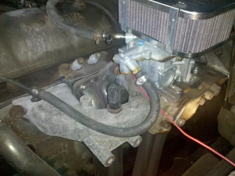

Here's the EGR cover plate and air rail plugs. Seem to be working fine:

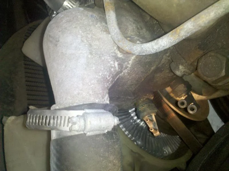

On the T-stat housing, I am missing all vacuum lines. Aren't the top two lines supposed to be connected to something?

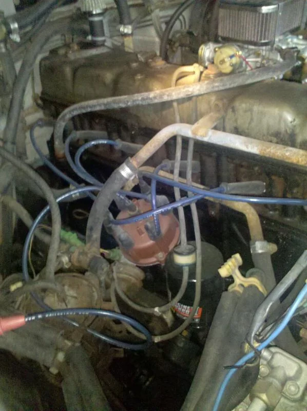

No vacuum lines from the top of the dizzy. There are two lines coming out of the Vacuum Advance Assembly (at least this is what I think it is) on the side of the dizzy. These two lines T into one line and connect to the Weber carb. This is the only vacuum line attached to the carb:

According to this diagram, the one closest to the radiator (BVSV - whatever that means) should be connected to the VCV coming off the charcoal canister and the EGR R Port (have no idea where or what the heck that is :confused:):
The EGR R port is on the factory carb but not likely your Weber. Looks like you can install a tee fitting in the vacuum advance hose and run it to the BVSV on the t-stat housing (either one) and then on to the VCV for the canister.

You don't need any of the connections on the T-stat housing, don't worry about it. On the distributor, there are two vacuum advance diaphrams, one advances more than the other, but as I recall, they perform poorly when hooked up to the same line. As I said before, test them both to make sure they don't leak, they are pretty old. Try one vacuum line on them individually and see which gives you the best performance. Your air cleaner needs to be replaced with something larger. Those stupid little square things are fine for a 22R, but not for a 2F. Chances are good too that you could go down on the either the pilot jets, or main jets or both. Out of the box Webers (and all other after-market carbs) tend to be on the fat side. I see that you do have a header and the EGR port on the intake is already blocked, so no worries there. Your mileage should be better than what you're getting, start checking stuff.
