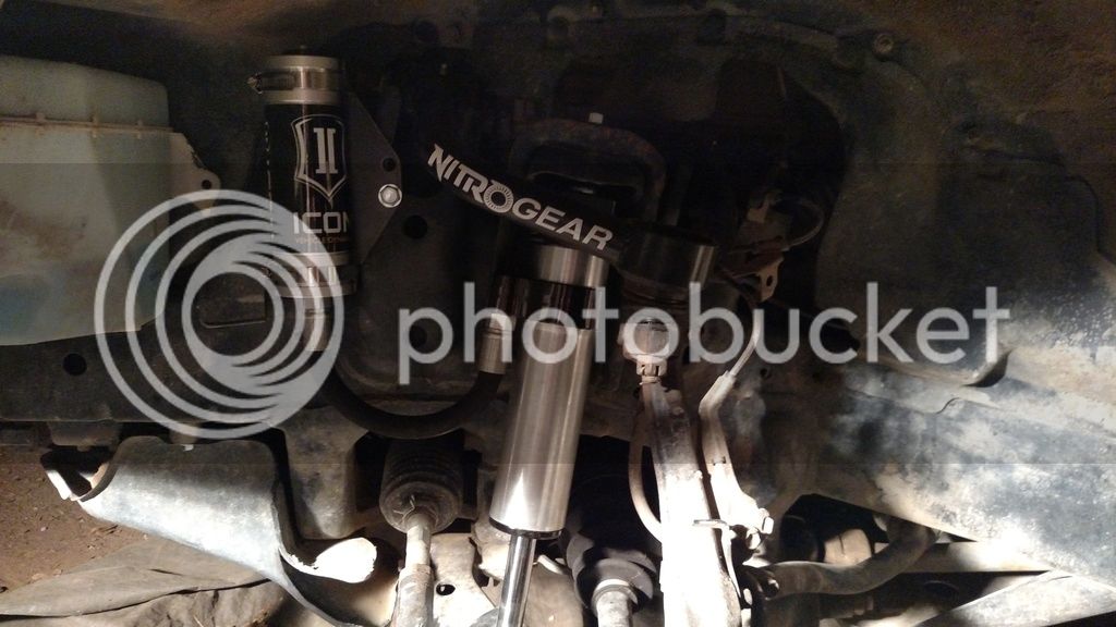

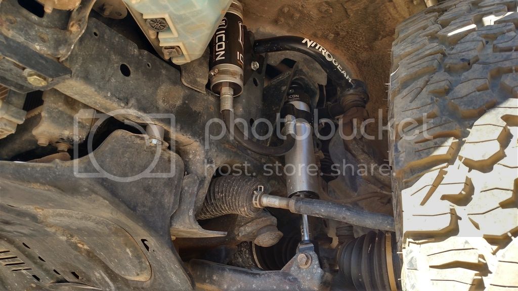

Having driven Elsey through 18 different states, wheeled in brutal environments it was time to upgrade the OME shocks to something that could handle the 7,500lbs of weight, I also like many of you got fed up with the shock bottoming out under full extension (even the most minor of bumps). This led me to Just Differentials for a new solution, I felt very good dealing with these guys and they were very helpful with my inquiries, and for my usage they recommended the Icon 2.5 remote reservoir shocks. Installation proved to be somewhat time consuming (about 3.5 hours). In order to install the front shocks I jacked the vehicle up to the point both front tires were off the ground, secured the vehicle on jack stands, removed tires, removed shocks but did not relieve tension off the torsion bars per the instructions. The lower control arm had to be pried down.. a lot.. in order to fit the new longer travel shock in. To be honest I felt a bit uneasy about full droop binding the new Toyota cv axles I had just installed too, but after a call to Murph at JT he reassured me that with my 1" diff drop there was nothing to worry about and they have not seen any failures due to overextension. I mounted the reservoir in the location the recommended, parallel with the shock.
The rear was a slightly different story.. The spherical ball end proved to be very difficult to line up with the lower shock mount. The directions said to use a terry cloth to clean up the mount as the ball end was tightly machined.. and I mean TIGHT! After wrestling with this for a while I managed to get it on. The next fun step was mounting the reservoir, the directions wanted me to mount it on the outside of my frame. This wont work for most of us as that's right where the slider attaches to the frame! I ended up mounting it just behind the last leg of the slider, this will work for now until I find a new location.

Pics?
This site is not phone friendly... I thought I did post pics, I'll try again
Edit:
More to come of the rear shocks and its flex, no installation pics though
