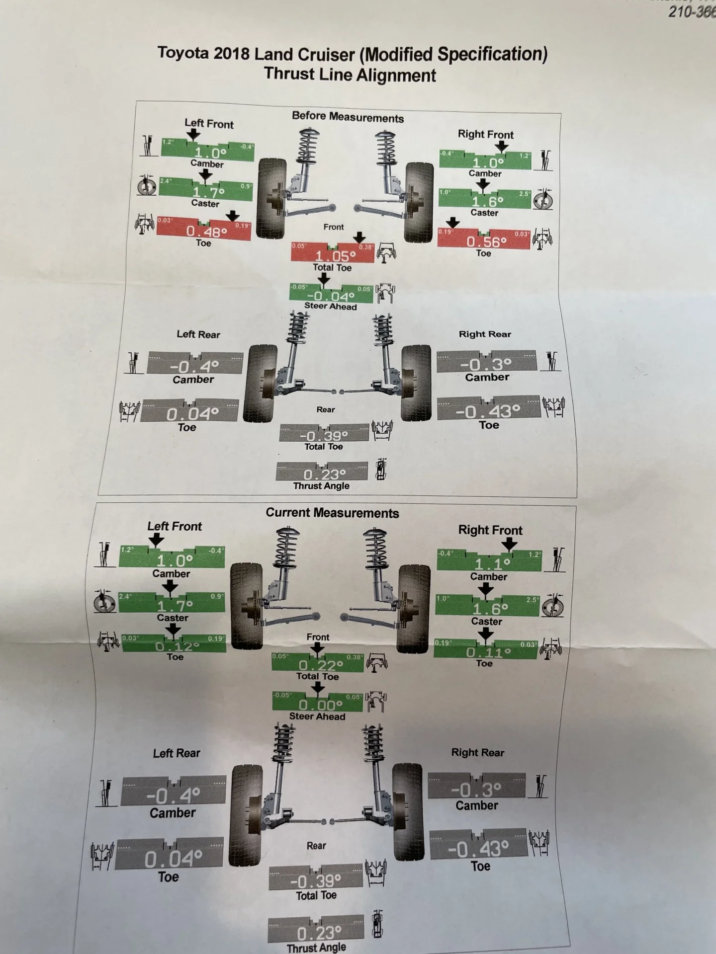

Great! Thanks! Here are the alignment results.
Yeah push caster closer to 3 or at least 2.9... there are some good posts in here about this that helped me

Great! Thanks here are the alignment results… I appreciate your help.
