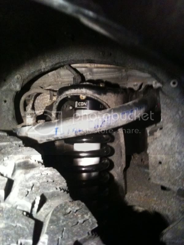

I've had a few different suspension setups on my rig since I got her :o. I think I got carried away, but now I'm done:
I've only driven it back from the shop, but wow! Feels great!:bounce::bounce::bounce:
looking forward to hearing your experience with these. also, what all have you already tried?
I've had Stock, Radflos and OMEs in that order...these are by far the nicest valved shocks yet. The springs are good too...even with the ARB bumper it doesn't dive that much, but yet feels plush.

For pure ride quality, so far the Icons are nicer than the OME, who knows about long term though.
The ride is less jarring but just as stiff, if not stiffer. The coilovers do a great job of giving you road feel, but there is no harshnes that I have noticed with OMEs in the past.
The other great thing is I was able to adjust the height of the Icons, I always had a front dip, just the slightest, but now it's gone. I have yet to check the side to side lean, if any, as I did also have a touch of lean prior to the install.
The front feels so great, that I may look into upgrading the shocks in the rear, something that is valved similarly to the front, perhaps Icon could suggest something they have, but I haven't asked yet.
I would definitely recommend this front set-up over the OMEs, they are pricier, but if you can hack that, go with this. The beauty to some is that you could throw these on first, do a front bumper or not, do rear shocks or not, and they will be adjustable to all scenarios. Just putting these on, and not doing wheels, tires, bumpers, sliders, or rear suspension is probably where I would have started modding this rig in the firstplace, had I known.

Icon had advised me that they are rated to run with the ARB front bumper (I wasn't sure if they use a spring rated for the bumper on all, or if you need to specify it). When I installed them, there was minimal droop, which was adjusted promptly with the spanner wrench you need to get from them.
I went as far as adjusting it a little further, and now my truck sits level...which it never did with the OME springs. So to answer the second question, you gain lift with the Icons (or you could loose it if you want to reduce the height). It is great having the option of being able to adjust them and the ride height.
In fact, I'm hoping I could adjust it enought to fit a 34" tire or larger under there. There would be some trimming of the mud flap, but that is nothing.

That's it, jack her up, take the wheel off, and adjust. You need thier tool though. The only other alternative would be to make one.
