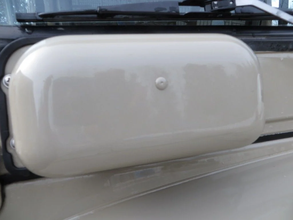

ok I feel like this is something that has probably bin beat to death but here goes.
Why is there a little hole in the windshield wiper motor cover?
there doesnt seem to be anything behind it you would need access to.
its right in the line of fire for rain to get in!
Great question. Cant wait to hear what the experts have to say.
would it be to let heat escape from wiper motor? reduce rust potential from humid air?
Never really noticed it until now but not all had them apparently. Beige has a plug in it and is on my 1980 45 and red is off my 1977 45 and no hole.

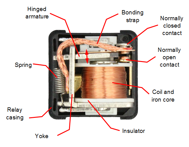

.Ever seen a vent hole in a small electrical part a relay for example ????
They don´t have.
I drove my 43 thirty four years with the plugged hole in the cover ... never opened it .
...pretty sure the hole has no function......
... ever seen a vent hole in a small electrical part a relay for example ????
They don´t have.
Beg to differ. Worked on machines all over the world, different climates and different altitudes. Relays DO vent.
Copy part of your link:
" Conditions where sealed relays are not vented:
Under special conditions for specific applications, it may be recommended that sealed relays not be vented. Such conditions include (but are not limited to):
 Much less than full rated contact current. Low level contact voltages and/or currents Low ambient temperatures
....operation at low to medium contact loads in a dirty environment (dust, grease, salt air, urban pollution, etc. "
Sorry . ...just an example these relays all have no vents in & they know why...

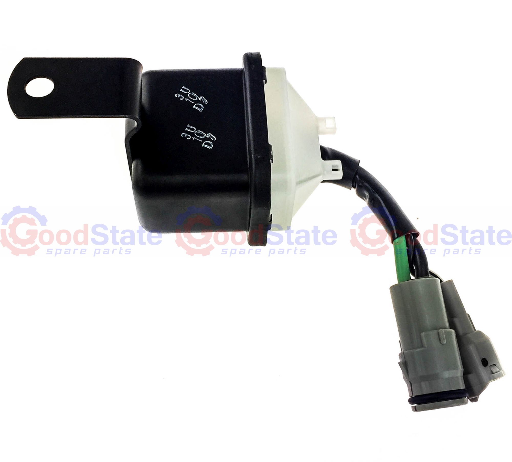

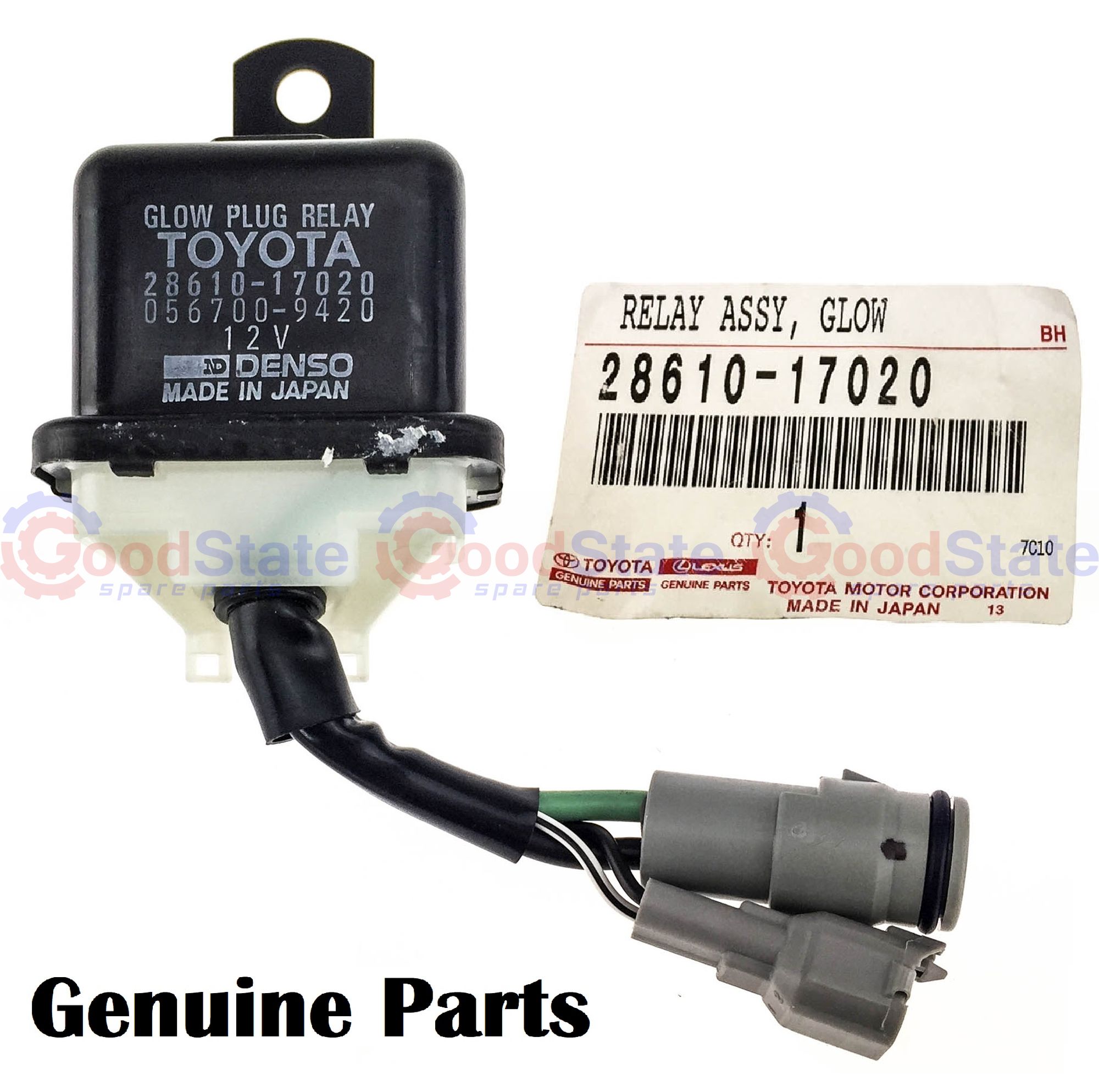

picture not for the 24V B engine
To explain a bit more
The glow blug relay for the B4´s are on the inside of the cabin on the right side on the bulkhead fixed.
One day we came home after a longer trip about 6 weeks & I wanted to start the engine .
You know the noise when moisture meets electric & what happens .... haha
and a hole would let moisture in !
