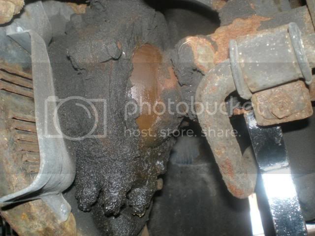

I was doing the knuckle rebuild on my FJ62 and noticed some surface rust on the knuckle. What are my repair options?
Mine was just as nasty, maybe worse before I did my knuckles. I just cleaned the knuckle real good and hit it lightly with some emory cloth, no pitting at all so I figured no worrys. With the felt and rubber I don't think you need a micro finish.
Are you talking about the knuckle or knuckle ball??
If its the knuckle then it doesnt matter.
If its the knuckle ball then.... If its not pitted then you could use some sand paper to remove the surface rust. If it is pitted then you could just run it (my first housing was pitted) and it will leak some gear oil out of the felts. Or some guys fill the pits with a filler (bondo....) and sand it down to the metal.
Just depends on if you care to lube the inside of your tire....
