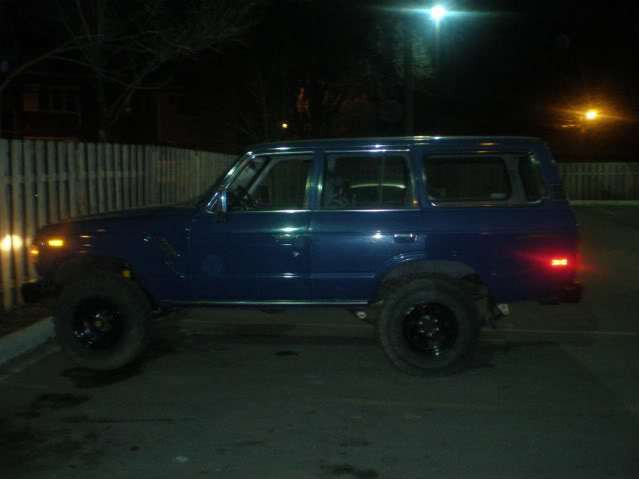

It lives....
Compared to....
Finished up a little bit ago. I'll post better pics tomorrow. I finished the birfs then did the 4Runner calipers. I still need to bleed it a bit better. Also found that I need TRE's and sway bar extensions. Not bad for a day of mad wrenching.
You been a busy man. Looks great Phil !!!
Lift, wheels and tires......looks completeely different!
Can't wait to wheel with it.

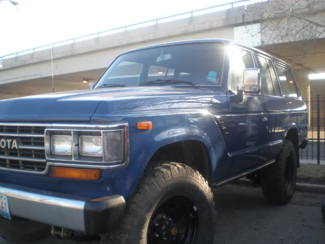

Thanks for the compliments guys! The pain was definitely worth the outcome! I'll take your advice on the bleeding Todd! I'll get back under it today. So as promised a couple more pics for you!
A little bit of a stinkbug stance but I like that.
It wouldn't be an LC without a little lean to it!
I know you did the tires kind of at the same time but did you get acurate measurements on how much lift you got?
Looks great!
