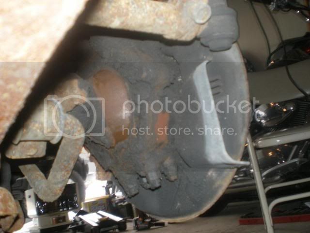

Since I had today off, I spent a few hours with the 62. I went over a bunch of stuff and am certain that the only thing needed in the engine bay so far* is a valve cover gasket and a smog check valve. The suspension and diff's are another story. I'll need diff' gaskets, a birf job, springs, shocks, brakes, and maybe a couple of steering components. I also took a few pics to document my starting point.
The offending check valve
The gooey Birf's

I broke down the knuckles over the last few days and am confident I can finish the birf job without an issue. I ordered up the birf parts and they should be here by Wednesday. I also talked to Kurt at CruiserOutfitters and am going through him for the OME medium lift. I'm impressed with his contributions here on Mud and it's more than evident he cares about his customers.
I'm also upgrading the brakes since I've got things broken down already. I'll be doing the 4runner calipers and FJ80 master cylinder. I'll upgrade the rear to disc's at a later time to hold my budget in line.
The only other concern I have is regarding tires. I have a line on 34" Maxxis Bighorns and a set of 16" black steel rims. Would going with a 34" tire be too much on the axles? I'd like to order the tires in the next couple ot weeks so I can get the rig on the road by the middle of March. What do you guy think? Am I going to push it too far?
34s are no big deal on 60 axles. The birfs are the weak link. If you run unlocked in the front they will last pretty well. Once you lock it, any size tire can break them. Buy longfields and an aussie at the same time and you'll be golden forever.
