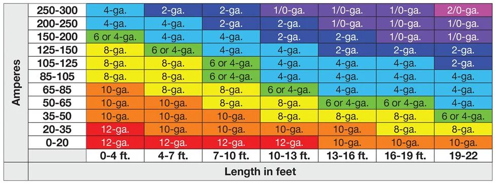

These big inverters would be pulling some serious current. What gauge wire are you using? And how long a run? Of wire.
I use a chart like this. I run a 4 awg of 9 feet, pulling 85 amps for 1000 watts

4/0 and appropriate fuse for the 3000w inverter (5' each way from battery to inverter).
