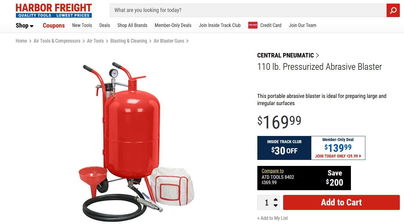

I wanted to pick your brains on this topic so that I can figure out the best way to spend my money. Long time ago, I got a quote for $300 for blasting four bumpers and now I have six of everything. I have a 5hp/80g/dual stage IR comp so I've got plenty of air at home, and wanted to know if I should get one of those HF sand blasting pot.

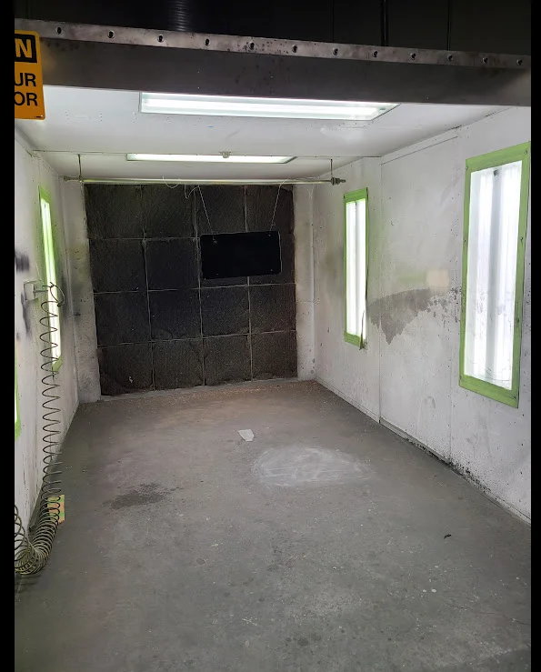

My work has a paint booth that I'm going to use to paint all these things, so I don't mind spending a little coin on the prep stage. Paint booth is not real fancy like a body shop and it's open one side but it does have a helluva air handler with lights. It also has no heating capacity so I might have to buy couple of those halogen work lights on stands as a heat source.

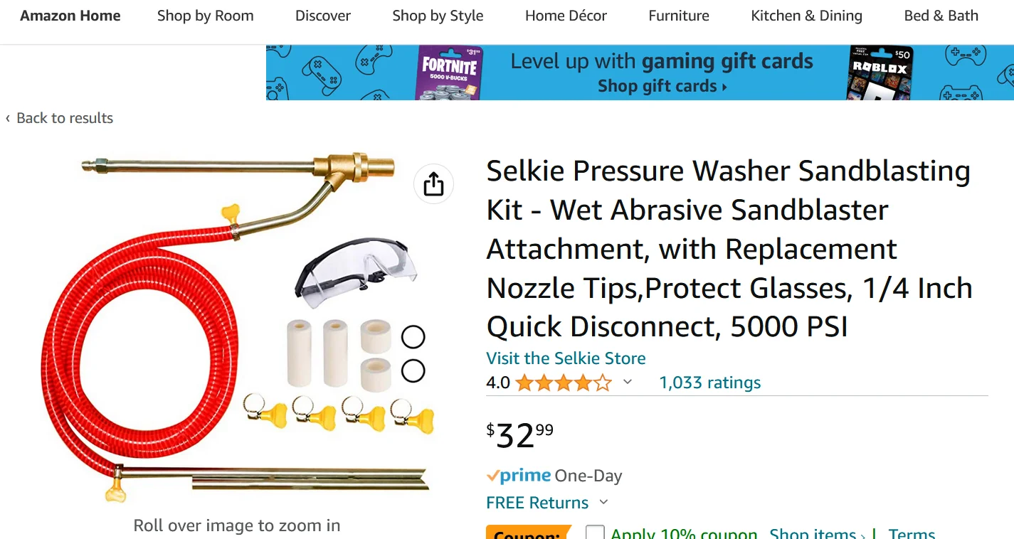

interesting concept. Use water to remove paint, then get flash rust? Of course I'd need to rent a pressure washer.
I don't know what the average humidity in your corner of the world is, but here I get flash rust out of the blast cabinet. I'd be glad to loan you my PW, but you'll have to pick it up.

That's the route I would go with a HF blast pot. A couple large tarps, maybe a 12x12 car cover and plastic sheeting to "enclose" it and would allow you to recover your sand. Also look at your blasting media. Black Beauty will give a faster clean but a deeper cut requiring more paint. Sand will give an even blast with medium paint. Glass bead will give a great looking finish, much smoother, and will require less paint, but may have slight adhesion issues if not cleaned well enough after blasting. Also, disposal of the blast media afterwards could be an issue.
Glass beads is not going to "go away" and could build up in your driveway, lawn, or wherever. Also a slight silica risk.
Sand will "blend in" but poses a silica risk.
Black beauty will fracture, but remain and will discolor your work area and will always be noticeable.
You could also consider walnut shells which will take a LOT more product, but is "biodegradable" and may work itself into your lawn over time, but you will have piles of it. It will also take longer but will give a very nice smooth finish, but will not create a surface profile for the paint to "bite' into.
This is GREAT feedback, thank you typing all that in. I live out in the boonies, got no neighbors so I got some leeway there. I needed the education on the blast media and this was uber helpful.
I recommend looking at "surface profile" information so you can get familiar with what different blasting profiles are and do.
The deeper the profile, the better the bite for paint.
The deeper the profile, the thicker paint must be to fill the peaks and valleys.
Definitely solvent wipe EVERYTHING before you blast. This way if you miss an area with blast, the paint will still stick.
The "whiter" the steel is after the blast, the better the adhesion, but you will use a LOT of media to get there. it may also stretch and deform the flat sheet areas of the bumper, depending on the thickness.
Get a "Wet Film Gauge" from the paint supplier to measure how thick the paint is that you're spraying. Then you can calculate how thick the dry film thickness will be by subtracting the solvents. (A 67% solids paint will dry down to about 67% of what your wet thickness is.) You want to end up with 4-8 mils Total Dry Film Thickness (TDFT) Part of that is primer and part of that is top coat. Primer is what attaches the paint to the steel. Top coat is what make it look nice. The primer is the most important to keep it from rusting or having the paint delaminate.
WEAR A REPSIRATOR WHEN BLASTING!!!
(Preferably a forced air type, but a HF twin silica pack will do OK as long as you are clean shaven at least where the mask contacts your face.)
