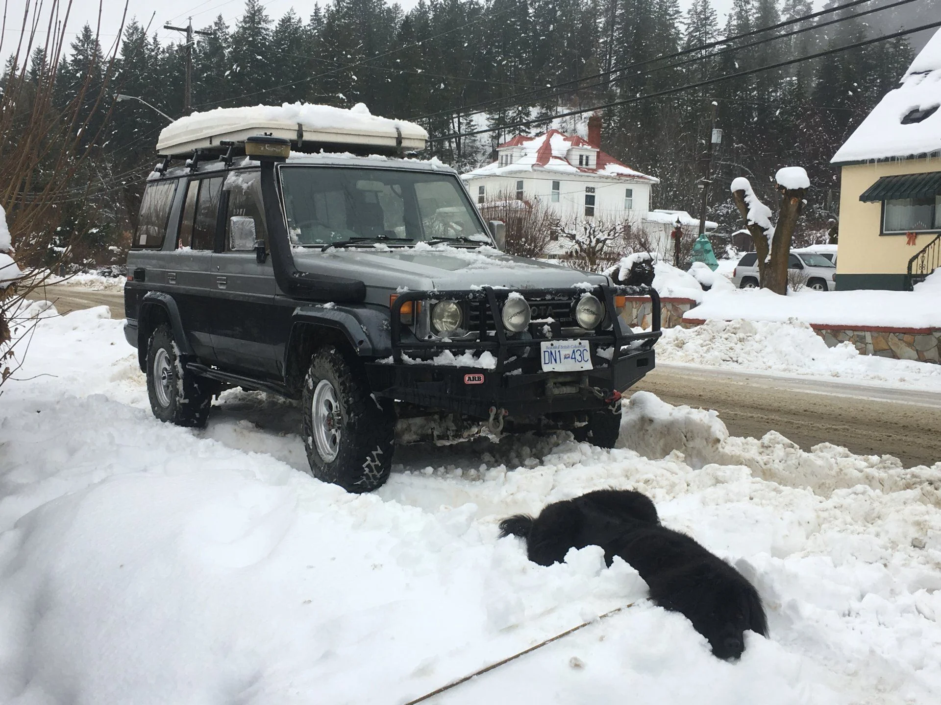

Mickey Thompson classic III aluminum rims with 3 5/8" BS. Chose the rims for lower rolling resistance as they are aluminum and cut unsprung weight, easy to get locally, and cheap enough considering they fit without a hiccup. Tires are 255/85/16 Toyo MT.
Probably going to end up running spacers for more stability at some point.

Is that a Bigfoot baby in front of your 77 ?
