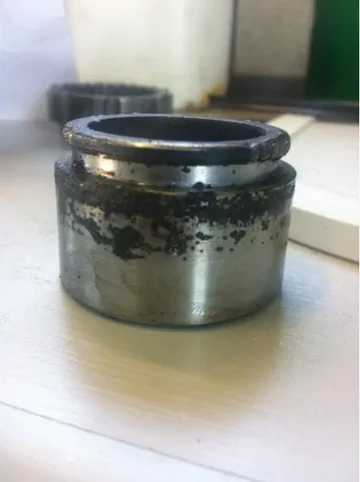

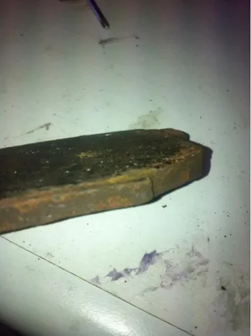

4. Hawk HB311 F.591
Here a picture of all 4 pads, on the left the Ferodo I am using right now, then pad 2, 3 and No. 4 on the right.
Attachement PICTURE 3
Now, the comparison:
A. The Ferodo got the max. surface since the left and right boarders are not chamfered at all. No idea if that helps in braking...
B. Pad 2 and Ferodo are totally alike in form and dimensions except that the Ferodo is 14.3mm thick while pad 2 is 15mm thick (in reality 16mm but I removed 1mm for the anti-rattle-shim that is already glued to Pad 2-4! Ferodo got NO shims included!) I guess after brake-in the special red coating will be gone and the measurement will rather read something like 14.6mm or so. I HOPE I can fit them since they are thicker! But otherwise they look like a perfect match!
C. Pad 3 and pad 4 got the same dimensions BUT are not exactly the same as pad 1 & 2. The lower pads on the picture look the same but stick 4mm more out as you can see on this picture:
Attachement PICTURE 1
This might already touch the disc, I will have to give it a try or remove some metal there.
D. Pad 3 & 4 are also on the upper pads (see overlook picture) different than pad 1 & 2. They are again roundish versus the pad 1 & 2 that are not. This should work fine. What bothers me more is the fact, that the brake material seems to be 1-2mm shifted lower! That means it will work on a smaller diameter on the disc and that means also it will have a little bit less of grabbing power since they radius where it grabs is smaller! Not sure if this will be noticable but still... here the comparison of pad 1 and pad 3 side to side:
Attachement PICTURE 2
I will keep now all 3 sets and am going to test them soon in Mexico and HOPEFULLY they will fit with more or less work. But I will post here any news!
