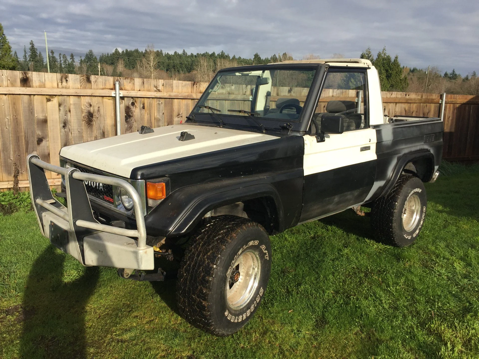

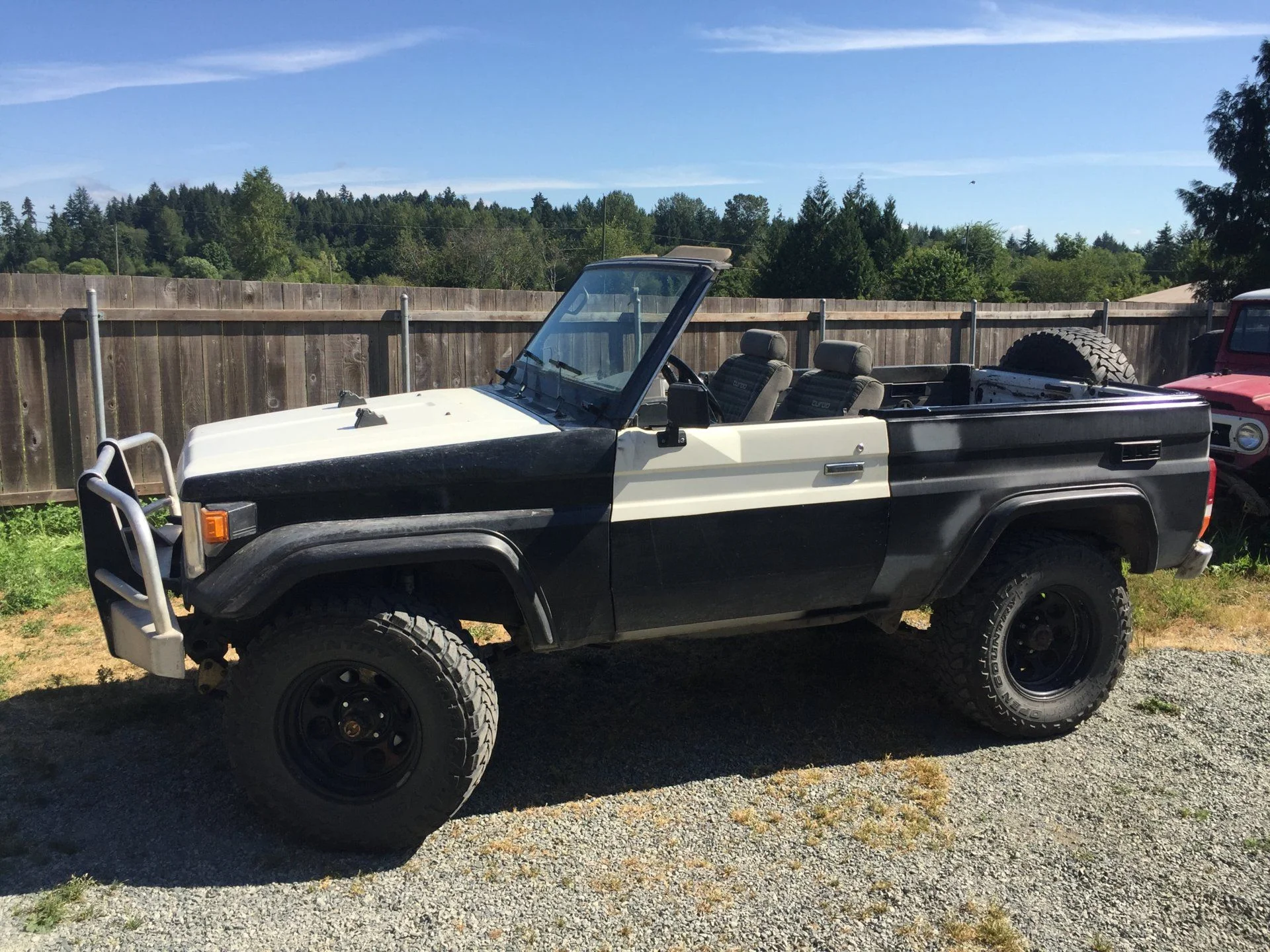

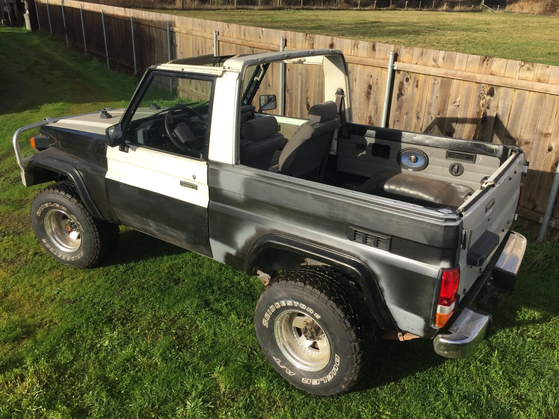

Here's a couple of shots of mine while being restored. It has just the hoop and spreader bars on. It looks ok.
A simple bikini top using Bestop FJ40 brackets on the windshield frame can be installed for less than $100.
I got lucky and came across a pair of convertible doors for the rear. But I also have a couple of sets of junkers
that can and will be cut for summer use for some friends rigs here.
Here is a pic in full convertible mode. My truck loses the top in April until October.

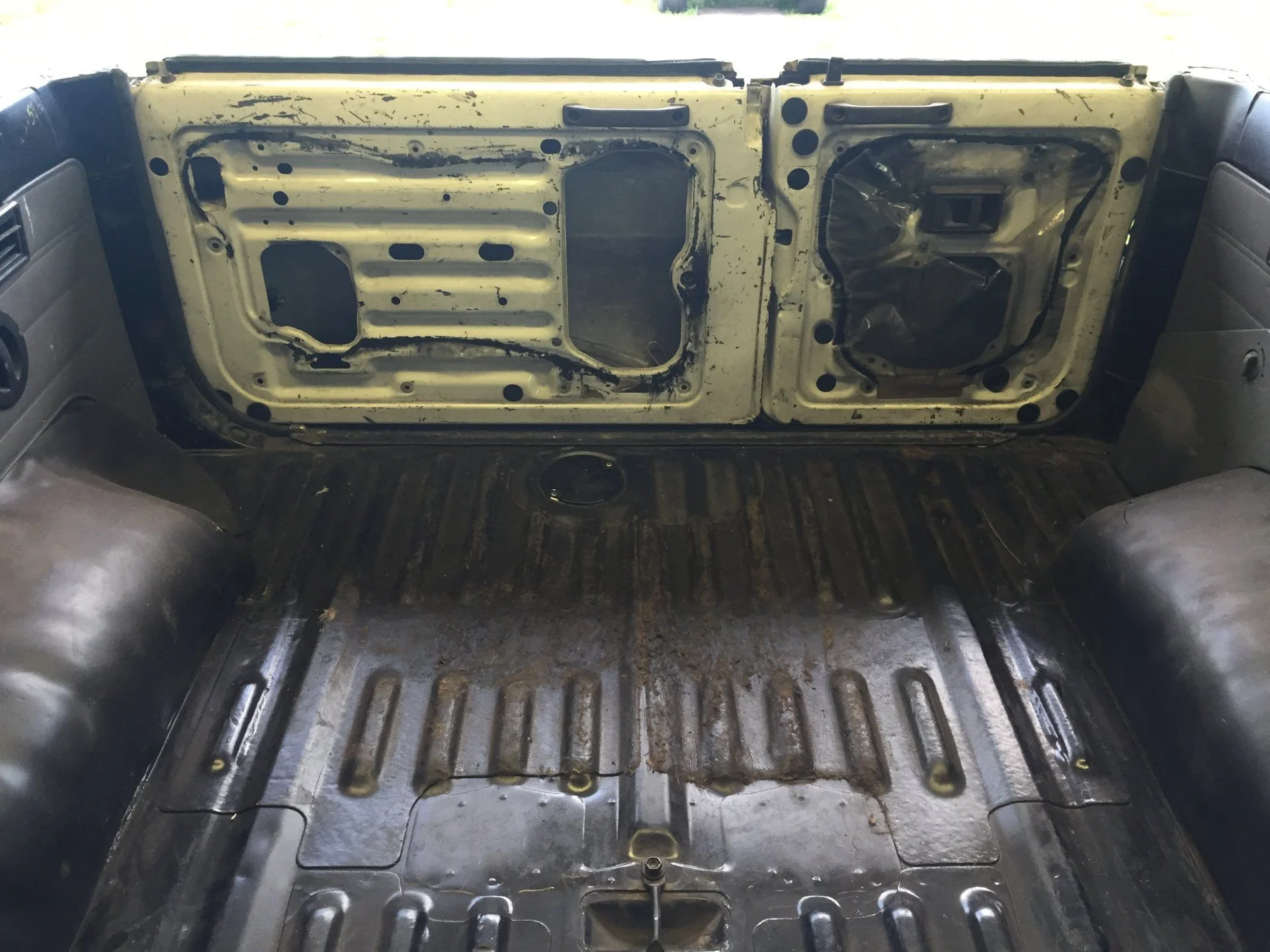

There are rubber grommets in the backside of the doors if you look that indicate the bolt positions that hold
the window frame on. So on the smaller door, there are the three on the left side, one on the right side.
On the larger door, only one grommet is visible on the left side, the other go in through the jamb.
These are from a 1989 BJ71 that had a 3B and was in fact a factory convertible vehicle.
