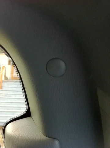

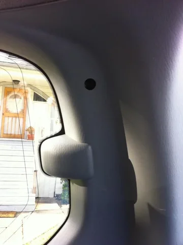

That part is all easy, I almost pulled them out when I fixed my subwoofer but didn't have anything handy to plug the hole up top. Anyone else take out the belts and can show a picture of what they plugged the hole with?
I used these - Krazy Glued.
I partially removed mine, and the belts are stowed behind the plastic panels on both sides. I just put the bolt that anchors them back in the hole and thought it might come in handy to tie off a clothes line for drying dish towels or swim suits sometime, if on the move from place to place.
CohibaDream said:

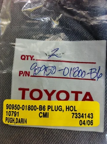

RobRed, thanks for posting the pics of the part number for the plugs. I was wondering what i was going to do with those dang holes.
Sure. Keep in mind they are not precise but cover the holes. I krazy glued them.
