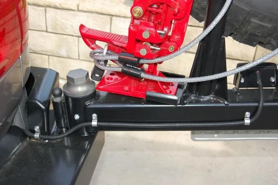

HD cable lock, big fat one, that barely fits through jack holes, and long enough to wrap around tire also.

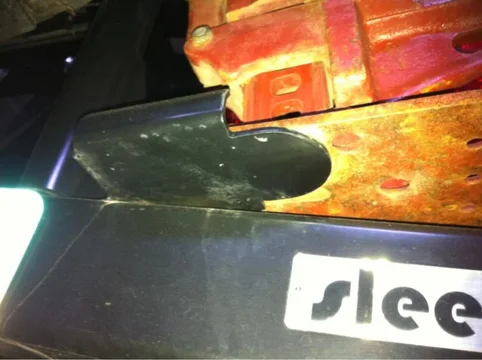

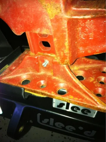

Te Slee carrier has a tab on it for a lock. Replace the Clevis pin with a difficult to remove nut/bolt and lock the base plate to the rack. Cleaner looking than the cable lock method.
Nice!
That is very helpful indeed.

Here is what I have on my Hi-Lift
the cable also runs through my spare to lock it as well.
