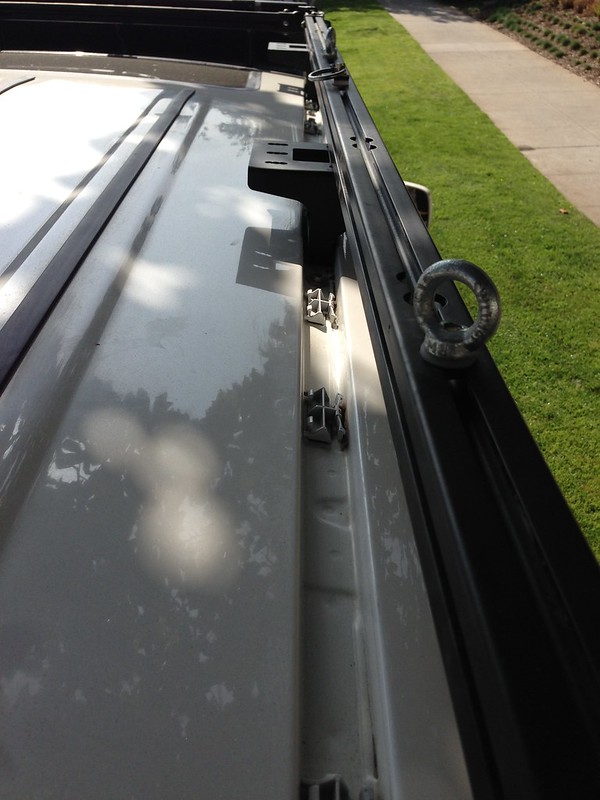

I have a lot of fir/hemlock trees around my house, and by taking the rubber weatherstrip out of my roof I think it would be a nightmare to not only keep clean, but it would hold moisture which isn't good in the Pacific Northwest. Do your roof brackets fit into the slots without taking said rubber out? I would want a bracket that you could install without removing rubber which included a flashing at its base.

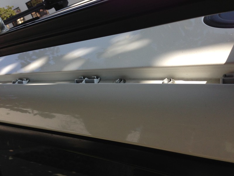

The weather stripping on the 100s rain gutters seems to be purely cosmetic. It's a piece of thin metal with rubber on top. It doesn't appear to be water tight. Based on how disgusting it was underneath the weather stripping on both my 2000s, I'd say dirt and rain water gets trapped there between the flashing and roof.
If you want, you can reinstall the weather stripping to hide all those clips. Each weather strip would have to be cut into 4 pieces to fit around the LabRak mounts. (Windshield to 1st mount. 1st mount to 2nd mount. 2nd mount to 3rd mount. 3rd mount to lift-gate).
I might do that because the clips are ugly. But they're set so low in the rain gutter of such a tall vehicle that no one would see them but you.
I don't think keeping the gutters clean would be that hard after the initial cleaning. Some Simple Green or Castrol Super Clean keep them pretty clean. This is what mine look like now.
To answer your question, no. The LabRak mounts can't just be installed on top of the weather stripping. The OEM rack's mounts go through cut outs in the weather stripping. The load is distributed through those rectangular metal washers to the roof.
The LabRak mounts distribute the load to the roof through a much larger foot print. So you'd have to make a large cut out in the weather stripping for the LabRAk mounts to go through. It seems easier to just cut like I said above.
