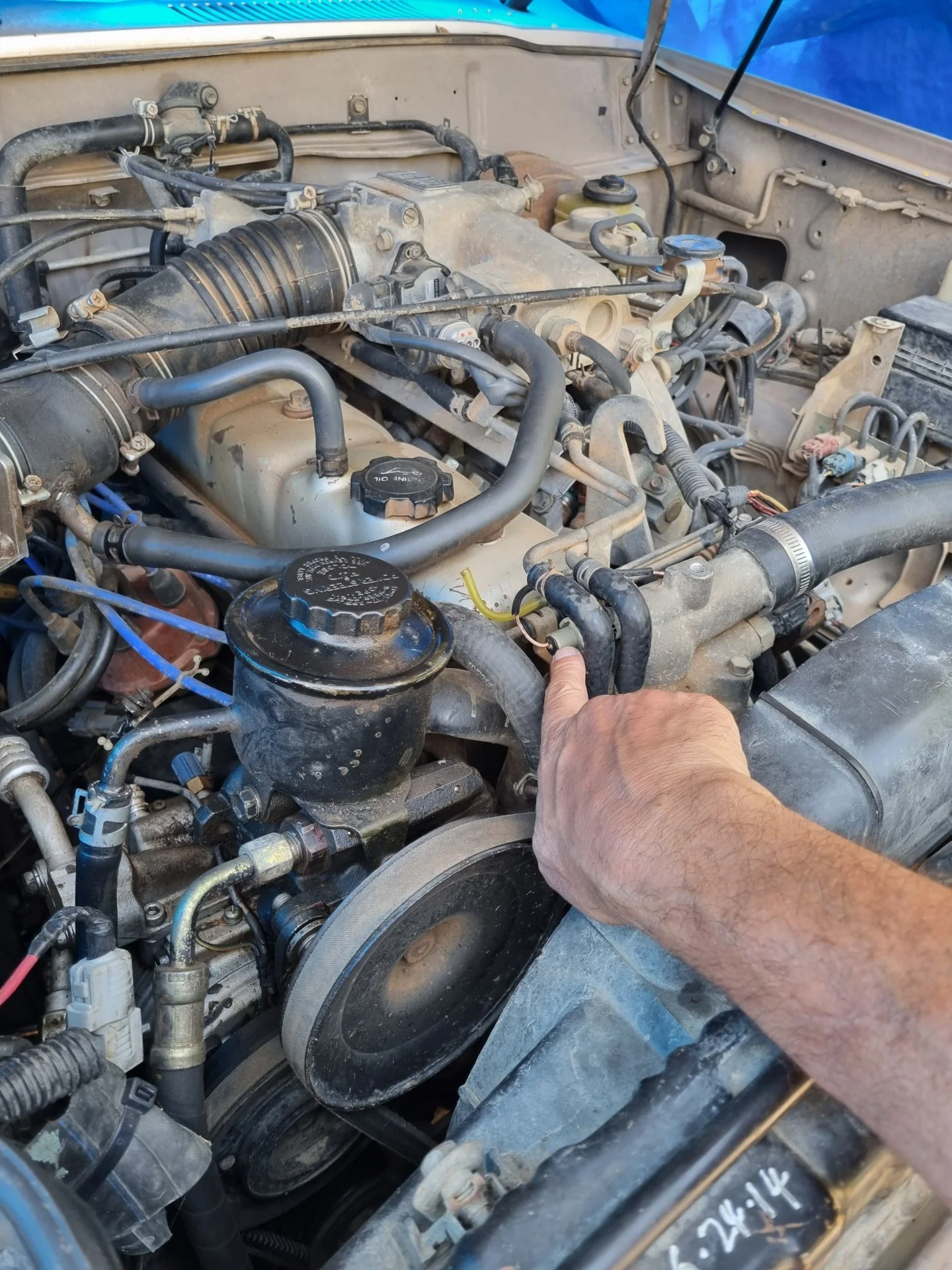

just bought fj80 1991 3fe. what is the way to identify p/n? see pic of broken sensor for example.
i do have the hard copy repair manuel . so how to locate this sensor? thanks

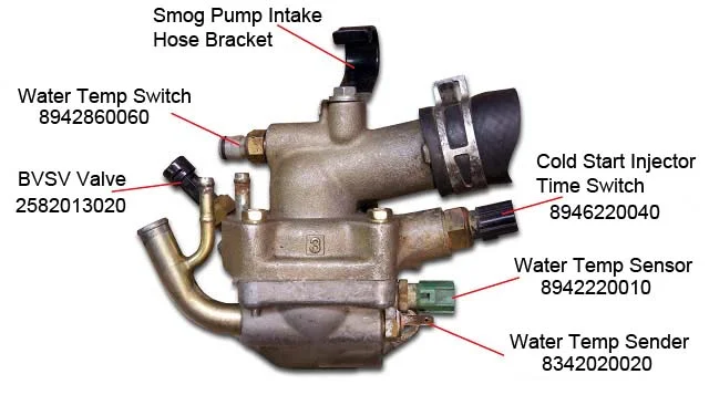

Yes.
And that's in the thermostat housing. So it's cooling.
