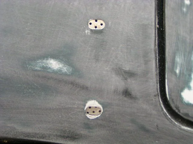

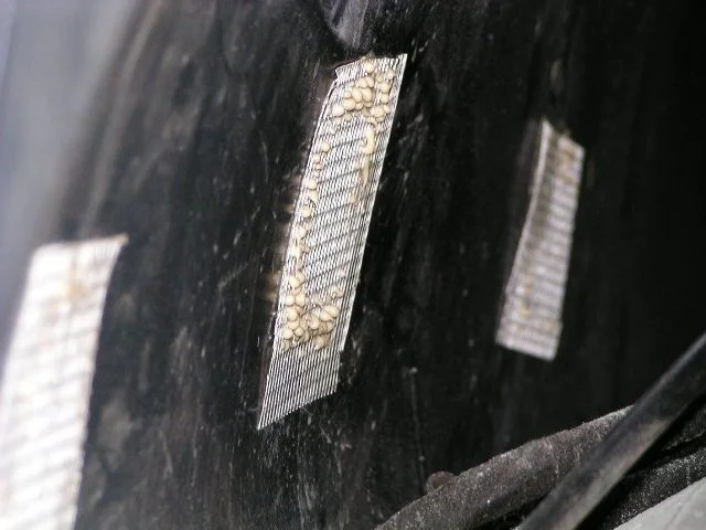

Not being a good welder I used an aluminum drywall patch adhered to the inner fenders with a high strength epoxy then used a premium filler, sanding, more filler, more sanding and then self etching primer prior to coating with U-Pol bedliner.
