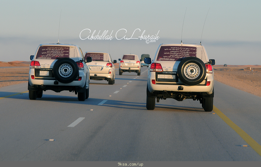

I'm by no means a mechanic , but i always wondered how similar are the rear axle's of an 80 and 100 .
They look identical in this photo ?
But i know they can't be because the 100 is wider .
the 200's rear end seems much bigger , i wonder if it can even fit on an 80 ?
This was discussed somewhere around here recently... The 100 axle probably is wider and the shafts are 32-spline whereas the 80 shafts are only 30. They do use a similar suspension linkage and I've heard the rear springs are cross-compatible, but someone else will have to confirm.
While the axles look sort of similar, they are completely different. Biggest difference is the Full Float vs Semi float, but also different in the oil seals, bearings etc. 80 is a much more user friendly design.
