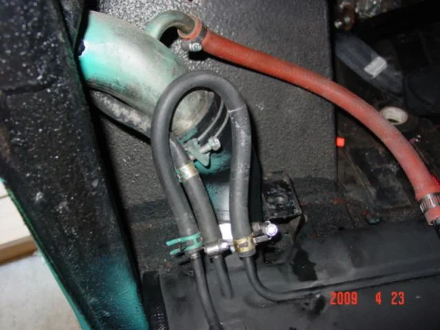

Think some of you might be interested in seeing this problem. My 78 FJ 40 always seemed to have a interior gas smell, and I assumed it was just the usual cheap poly tank problem commonly complained about by others on this forum.

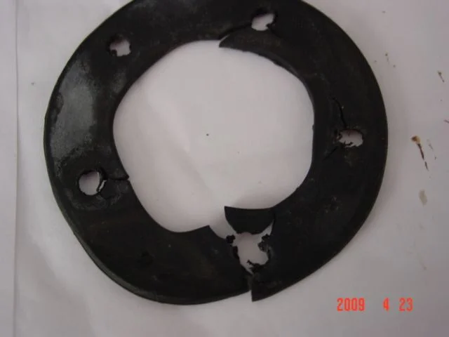

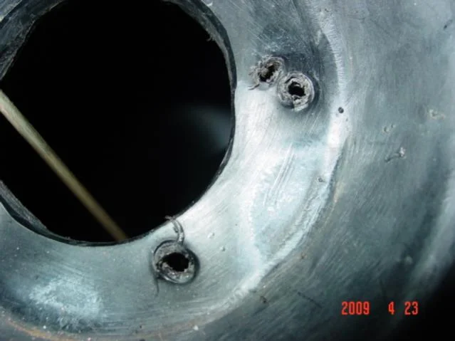

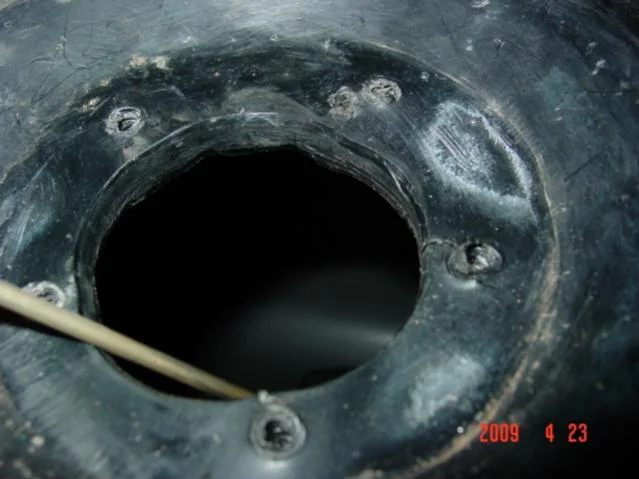

Recently, I decided to just get an OEM tank and fix the problem. With taking things apart I discovered the PO had removed the fuel separator, closed all the openings and left no vent for the tank. The poly tank appeared to be venting though the sending unit gasket which was in terrible condition. Some of the screw holes had been stripped and new ones drilled, and the opening was badly warped. Here are the photos:
