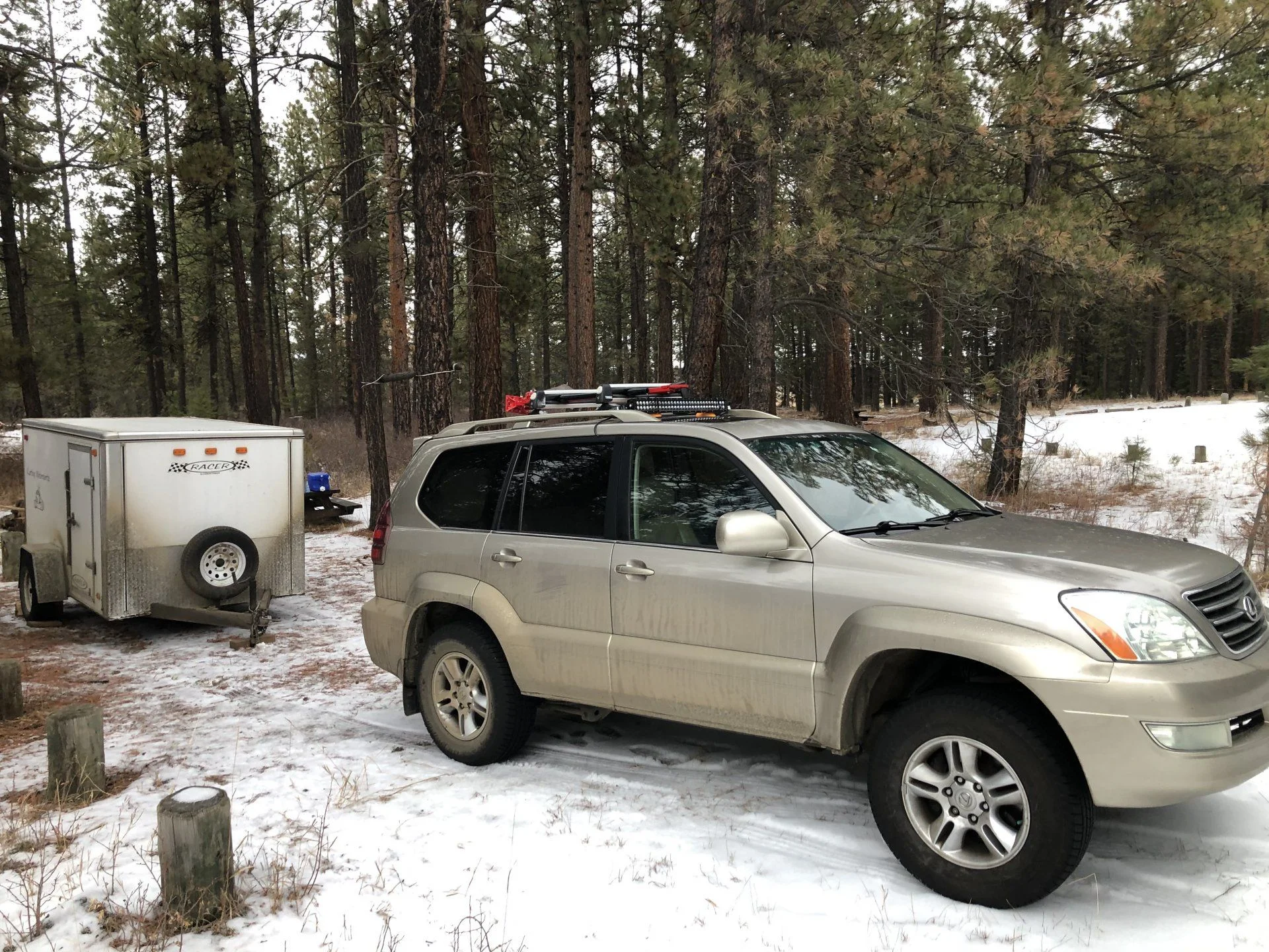

@LCT - This is what it looked like once complete, at "normal" ride height (my airbags still work.)
I can report that the TRD OR shocks work awesome! I went out in the snow and BLM high desert here in Oregon this weekend and had a lot of fun. It wasn't muddy, but lots of rocks and dips and drops, it rode great and handled it with ease.
