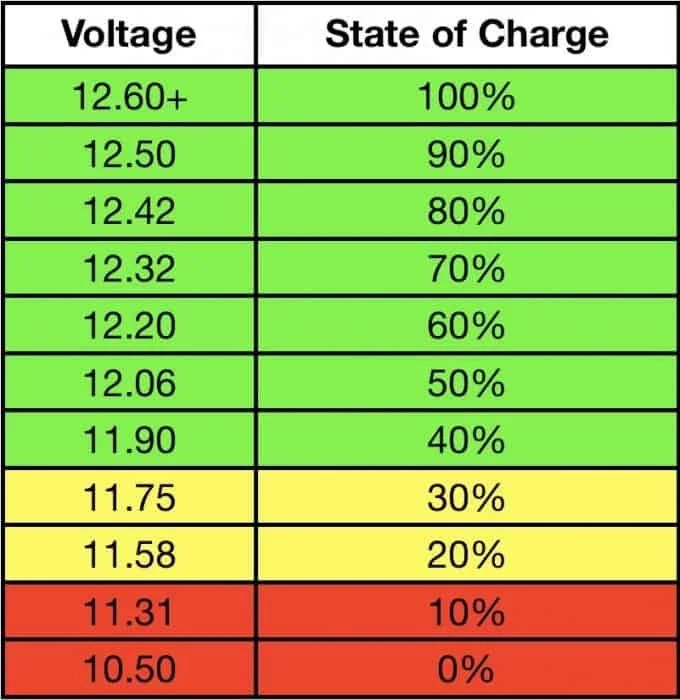

Indirectly you can monitor the voltage to estimate how drained your battery is. You'll want a multimeter as the little gauge in your dashboard does not have sufficient resolution. As to how low you can go before starting becomes a problem, I'm not sure but I'd definitely be concerned at 50% if not sooner, as you don't want to discharge a lead acid battery below 50% (and if it is discharged that far I don't know how many crank amps it's really producing)

To answer your question, easiest way is to use a cig lighter adapter that has a voltage readout. It's better resolution than the dashboard but also has its limitations. Particularly that there is some slight voltage drop at the cig lighter position, depending on draw. These readings always has the battery under some minor load so it's never completely precise (always a bit under) relative to the SOC table posted by @linuxgod. Mix in temperature as another variable. That said, measuring battery reserve is not a perfect science anyhow and it's best just as a general reference.
I would be comfortable running down to ~11.9V (with loads turned off) and having enough reserve to start the car. I personally would even go lower but that can start compromising battery life. Yes to the lithium jumper as always a great backup, if not for yourself but even others. Many also serve as a USB power bank.

I would suggest buying a simple battery tester like a Topdon. It’s manual but easy to use. FWIW, I used my Topdon last weekend to test my boat batteries. The voltage table @linuxgod provided above lines up pretty well. I had batteries with about 12.1 volts and the tester said 50% charged. Plenty to start the boat. I like the other data the test provides too though I have to admit, I don’t know how accurate any of it is.
