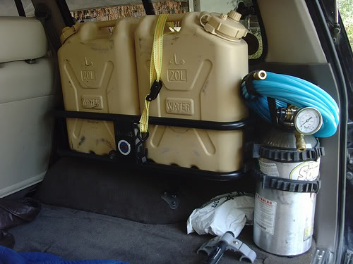

I guess this is the "other" option. In addition to this, I'll be carrying two wedco water cans inside the 60. I'll post the set-up once it's completed.
good luck
good luck
