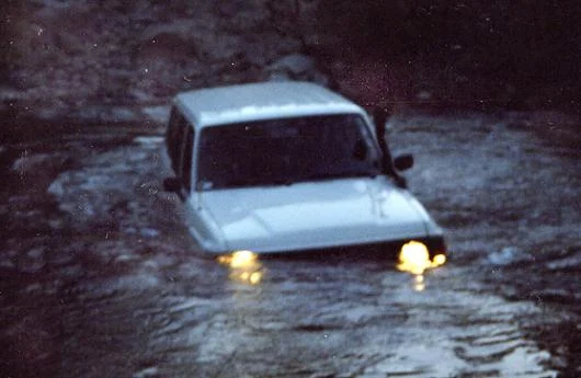

This is my cruiser sprung over on 37 MTR's, at one point I dropped into a hole with water on the front of the hood and most of the time I had a fountain of water coming in through the tranny shifter hole.:cool:
That picture reminds me of some of those old photos of the Loch Ness monster. Pat, Have you been Cruisin' aroiund Scotland? ;)
I hereby dub your '60 "Nessie". ;)
