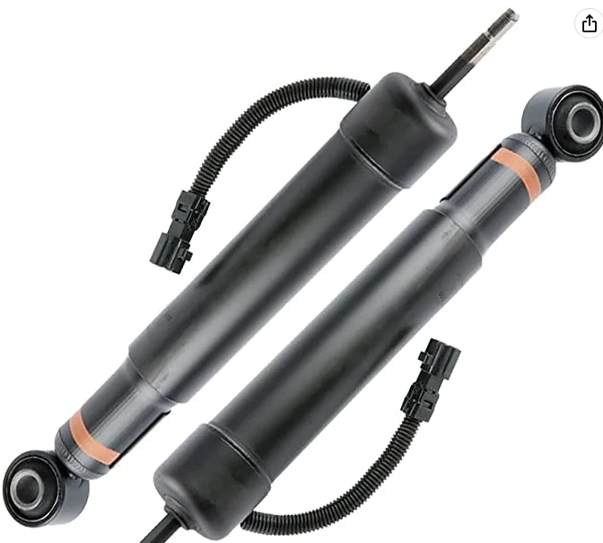

If the electrical connectors in the wheel-wells are not attached to the shocks(typically all black with a connector hanging off the end, like below picture), they have been swapped out for "dumb" units. Assuming your front dampers aren't blown, stiffer springs up front will reduce nose dive under braking.
Even when mine were at 150k I could tell the difference between sport and comfort. Maybe not one setting over, but all of them over I could tell.
I don't see loose connectors and the shocks don't look like dumb aftermarket versions so I'm pretty sure we're looking at original or at least original replacement units in place.
