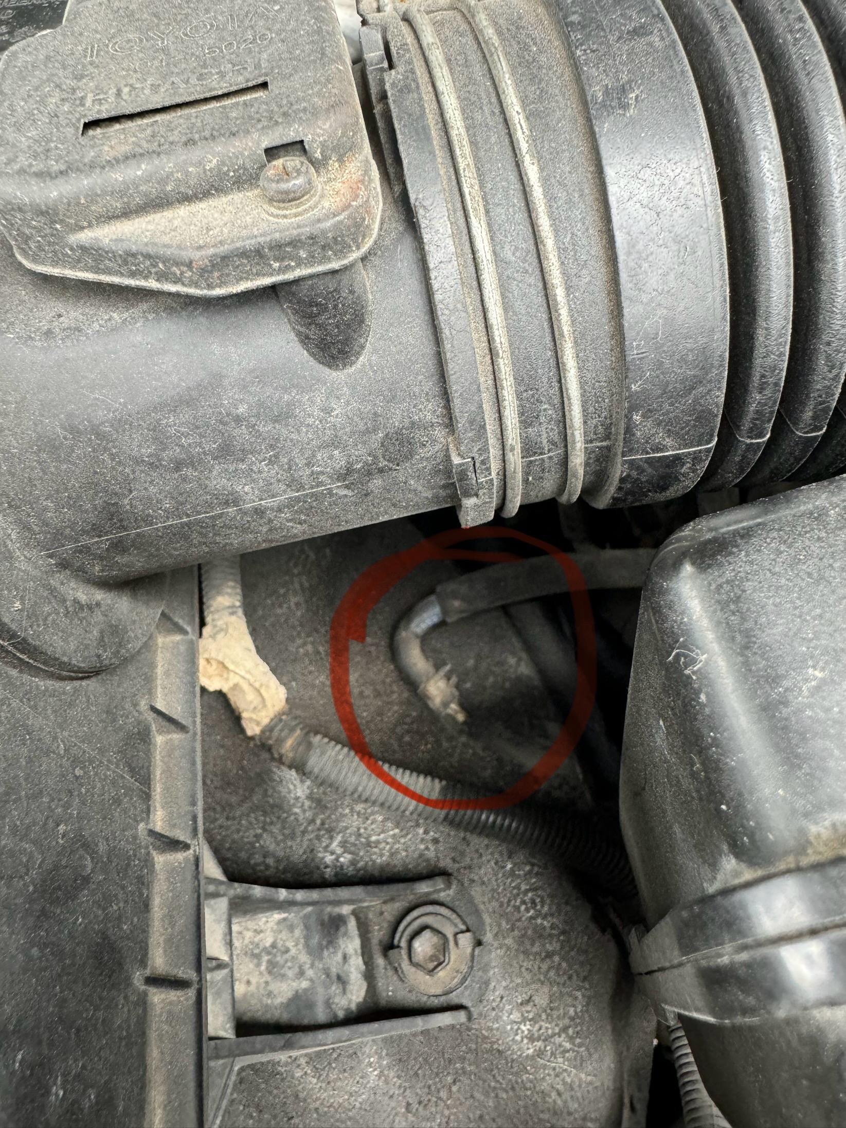

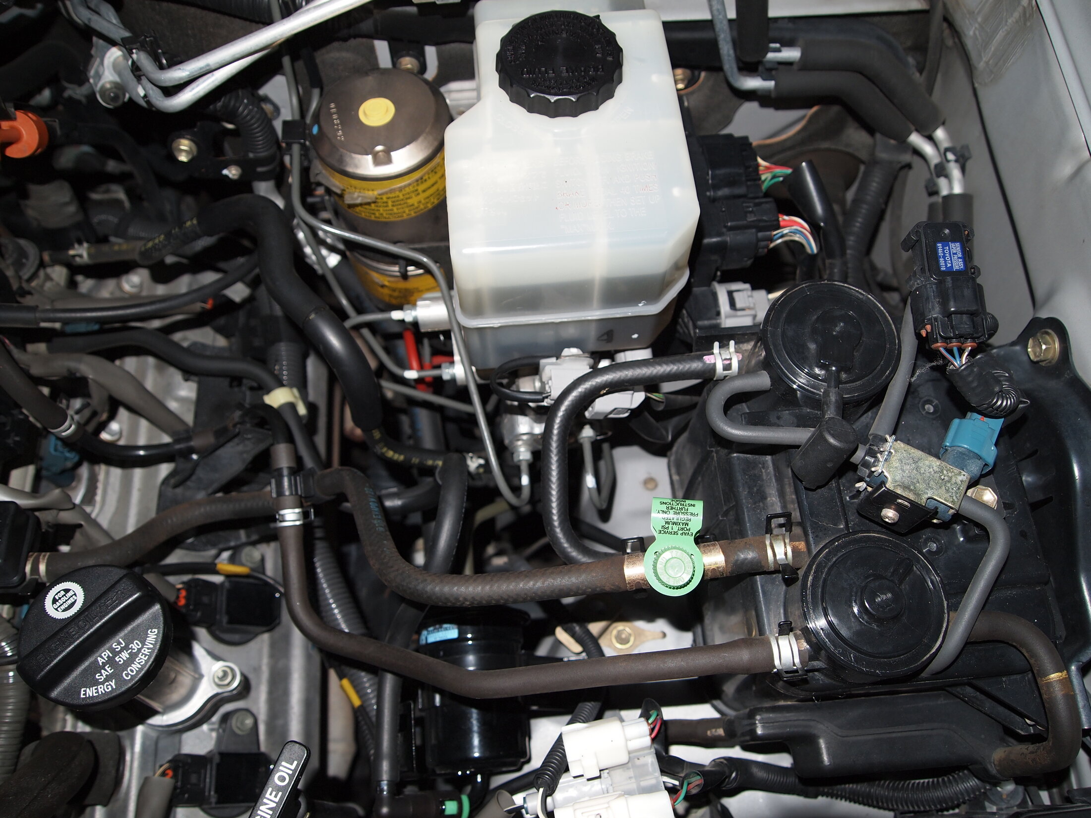

Hi,
Does anyone know where these hoses go to?
TIA

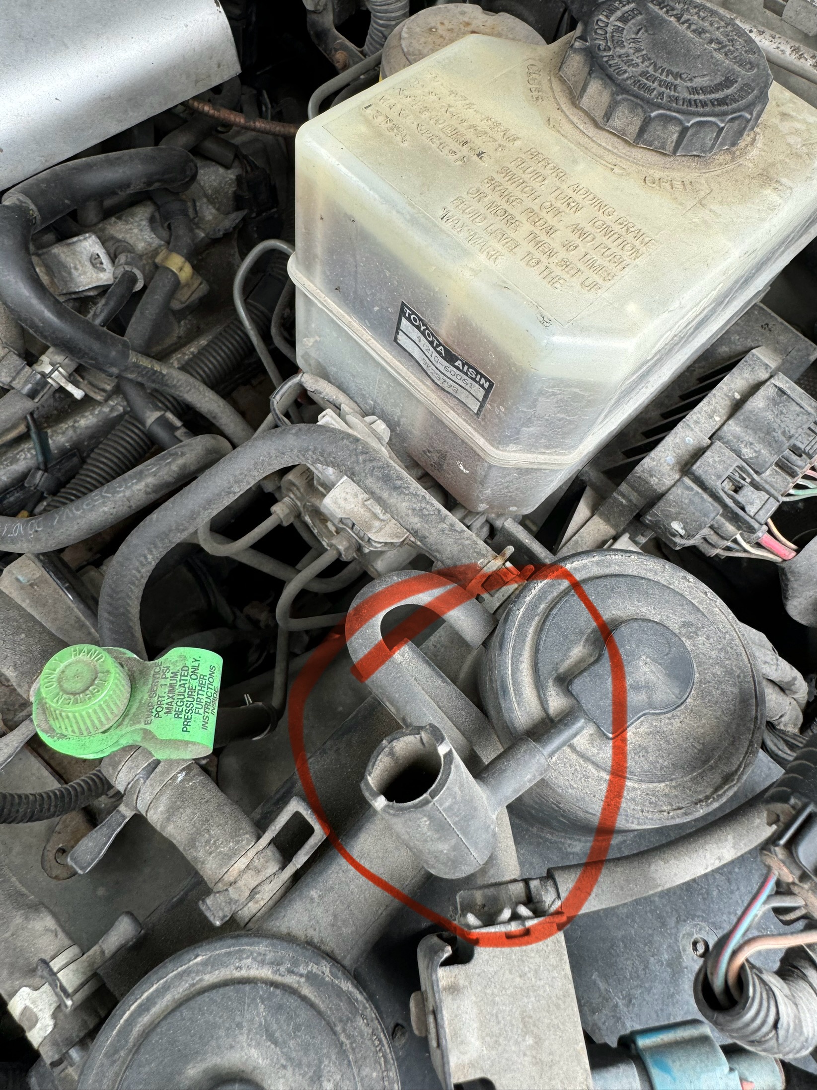

I'm guessing you have a 2000 - 2002.
The second hose pictured, near brake master on LH side, is just a vent on CC. It's fine as is.

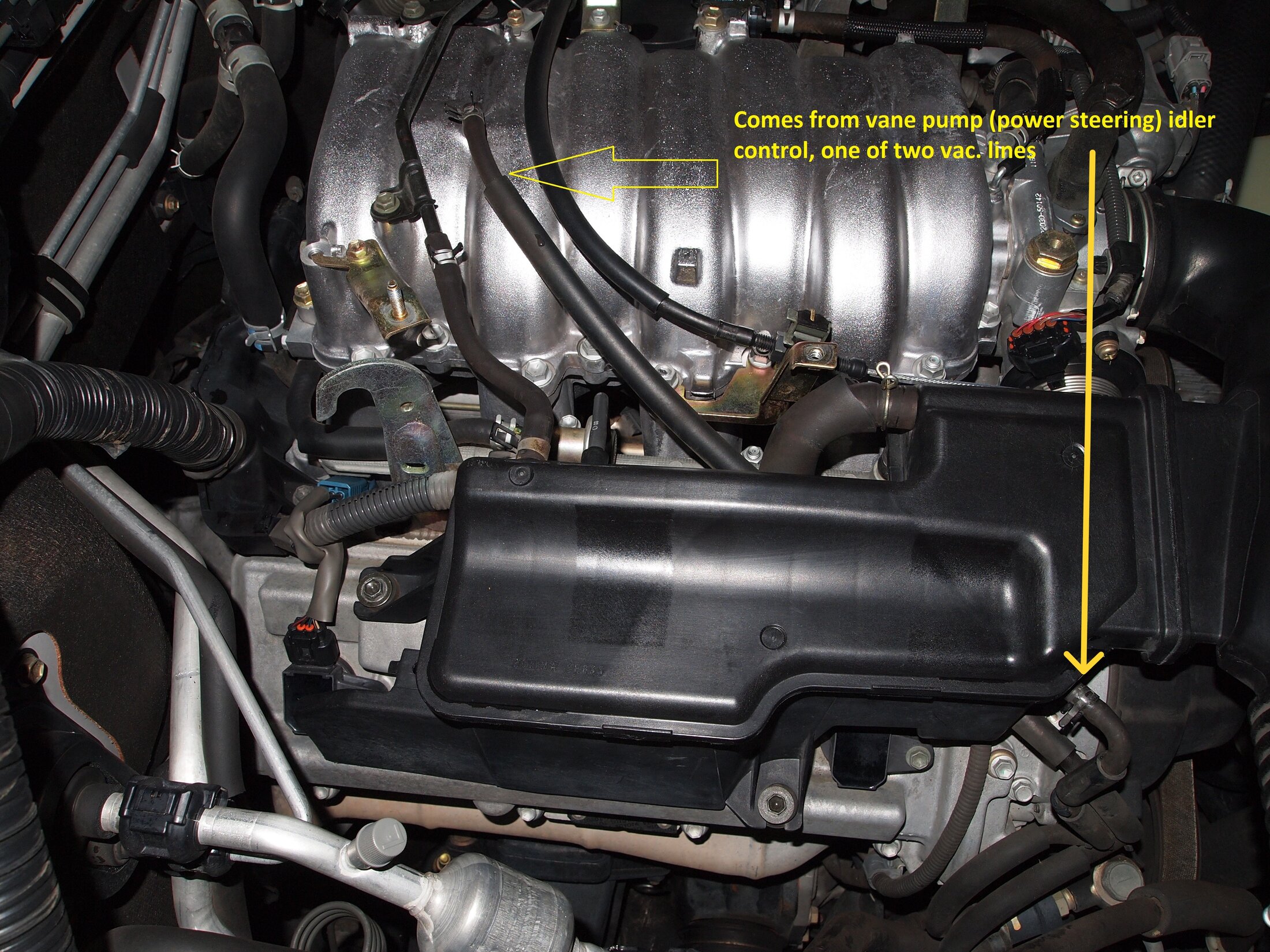

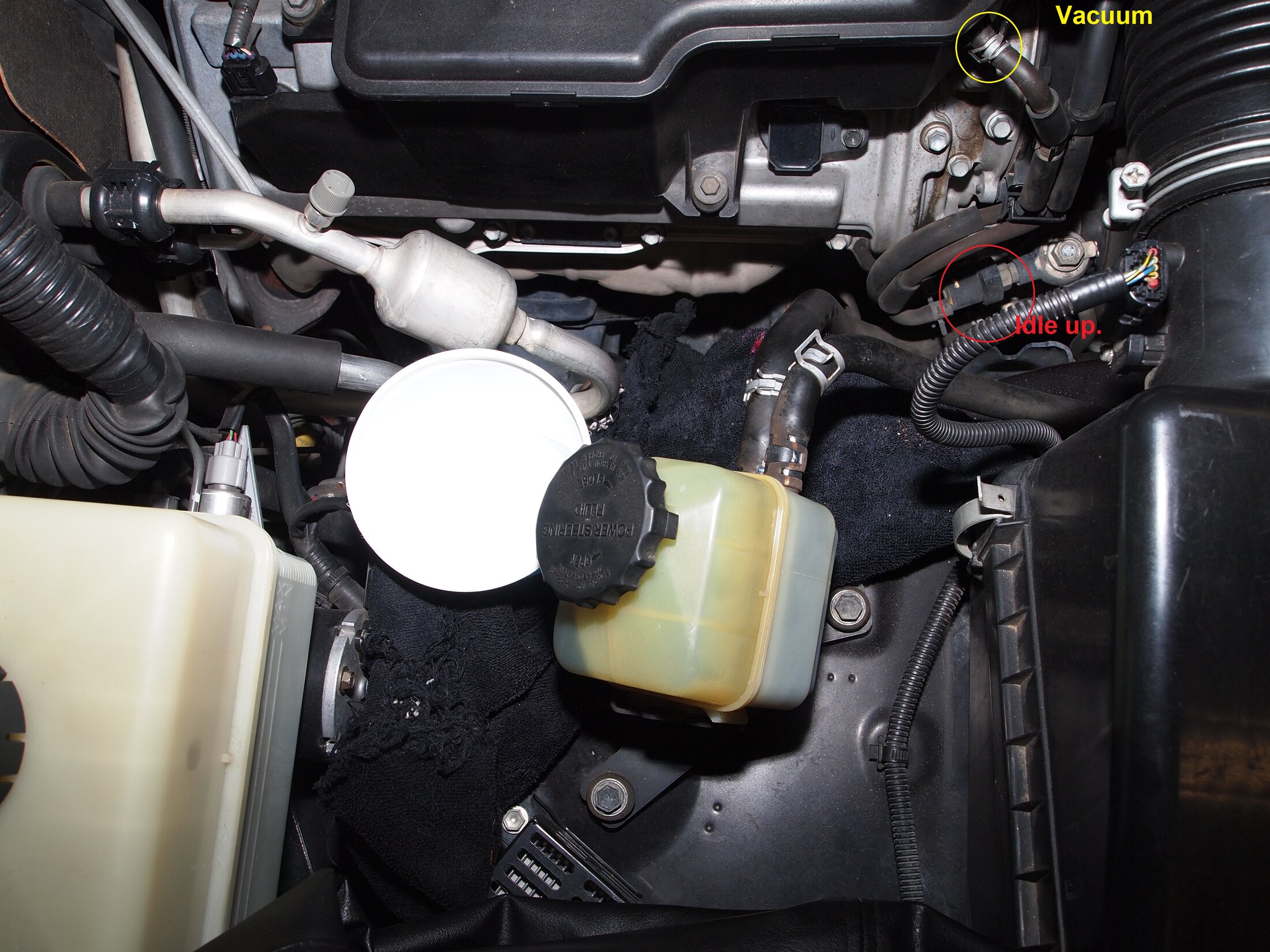

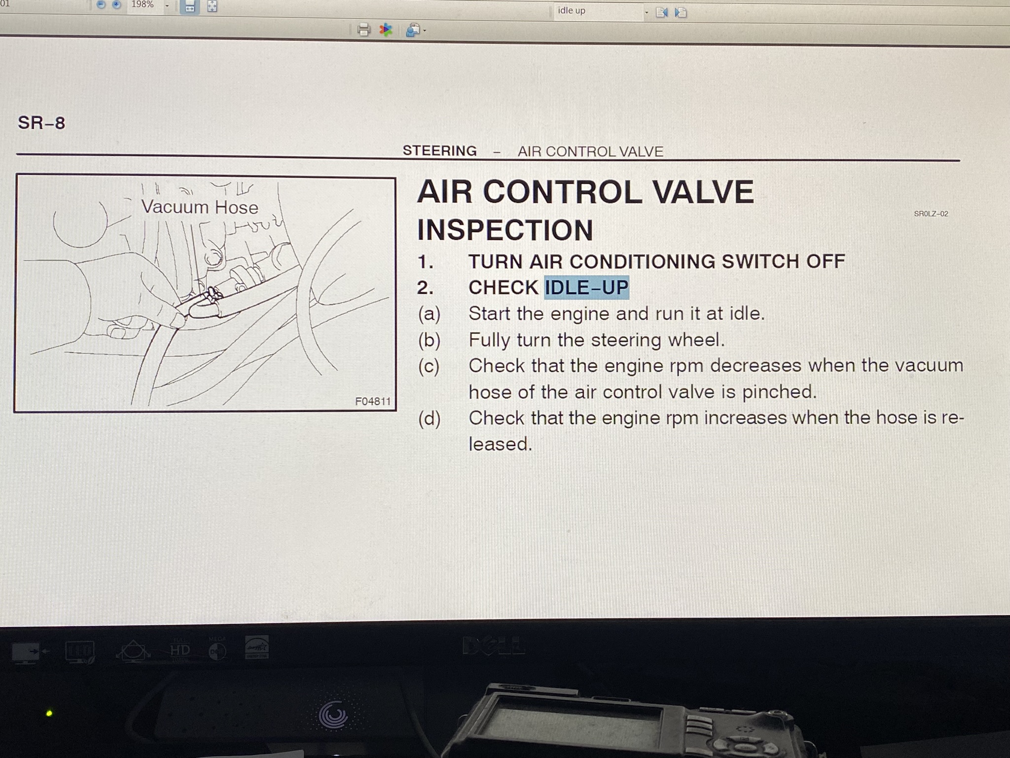

The first picture of vacuum line/hose, on RH side inner fender well. Is, the idle up control vacuum line. It's one of two connect to vane pump (power steering pump) idle up control valve. The other ends go to: 1( air box resonator tube. 2) Intake manifold. The end lying on fender well, goes to the idle up control valve on vane pump.
These vacuum hoses/lines as with any, get old, crack and loose. Replace any of them, if loose fitting or leaking in anyway.
