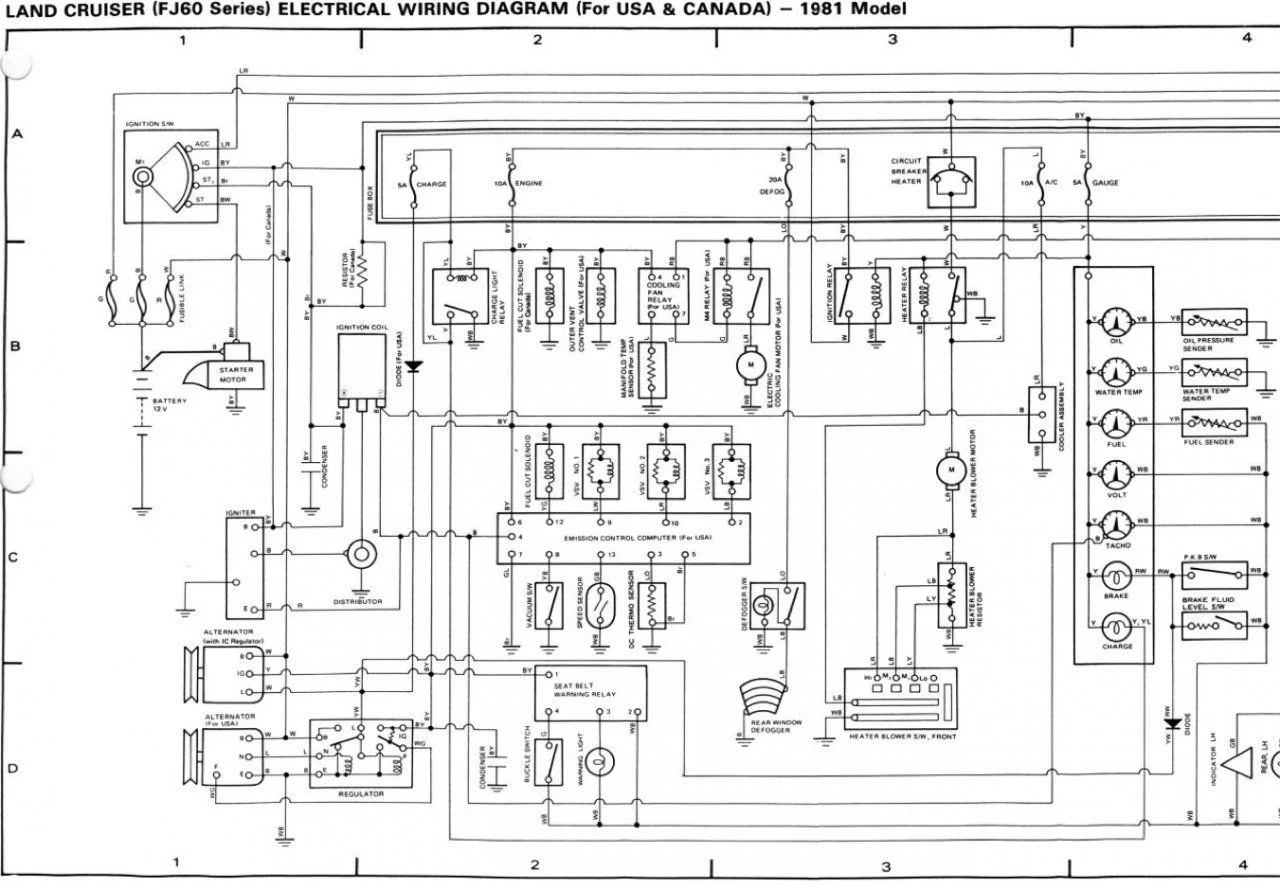

The horn and the headlight circuits share the same fusible link.
If you look at the wiring diagram and trace the Red (R) wire that comes off a fusible link on the positive terminal of the battery, you will see that it leads to both the Horn-Hazard fuse and then onto the Headlight Relay.
But other than that I can't see that there is any cause and effect relationship between your horn and the headlights.
I would suspect that if you pull the steering wheel and inspect the horn pin and the contact plate for the pin on the back of the steering wheel you will see that the horn pin has worn down.
If so, replace the with a new horn pin and flip the contact plate on the back of the steering wheel around (or get a new contact plate as well) and then rerun your experiment to see if the correlated effect goes away...

The Horn/Hazard circuit shares the same fusible link (labeled R on the wiring diagram - so the fusible link with a red wire) as the Headlight circuit.
It also might be that you have a fusible link that is intermittently shorting, so by coincidence, when the lights are working then so is the horn.

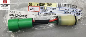

You can check to make sure that you are seeing 12V+ on the far side of each fusible link (specifically the Red one, since that is the one that the circuits are on).
This is what happened to me, I had a corroded fusible link connection on the outside of the connector that attaches to the positive battery cable. This "occasional" short caused the metal spade inside the connector to heat up and burn/melt the plastic inside which had me on a hunt to find another terminal connector for the positive battery side as the original was connected to the original battery cable. Go check those connections ASAP as it can be a B#%*@& to get everything afterwards (the fusible link itself is still available by Toyota).
