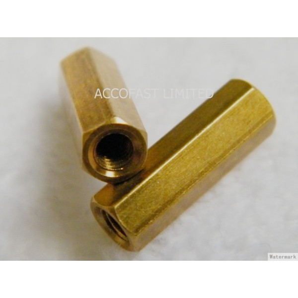

Also, a 50 cent threaded brass hex offset works great. Just thread it over the old plunger.
