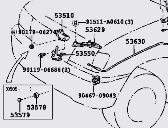

Hey how’s it going my name is Jerry from New Jersey, this is my first post here at i h8mud, I just purchased a 2002 100 series and could use a little help, the hoodlatch is busted I can’t seem to get the old one out to install the new one, I’m wondering how many bolts hold it, and if it’s just pops right out with the cable, having a difficult time here.
Looks like it's just bolts behind the grill.
I've had the LX off without much(i think it was four 10mm books), but I've not taken off if the LC. It's probably due for an adjustment though.

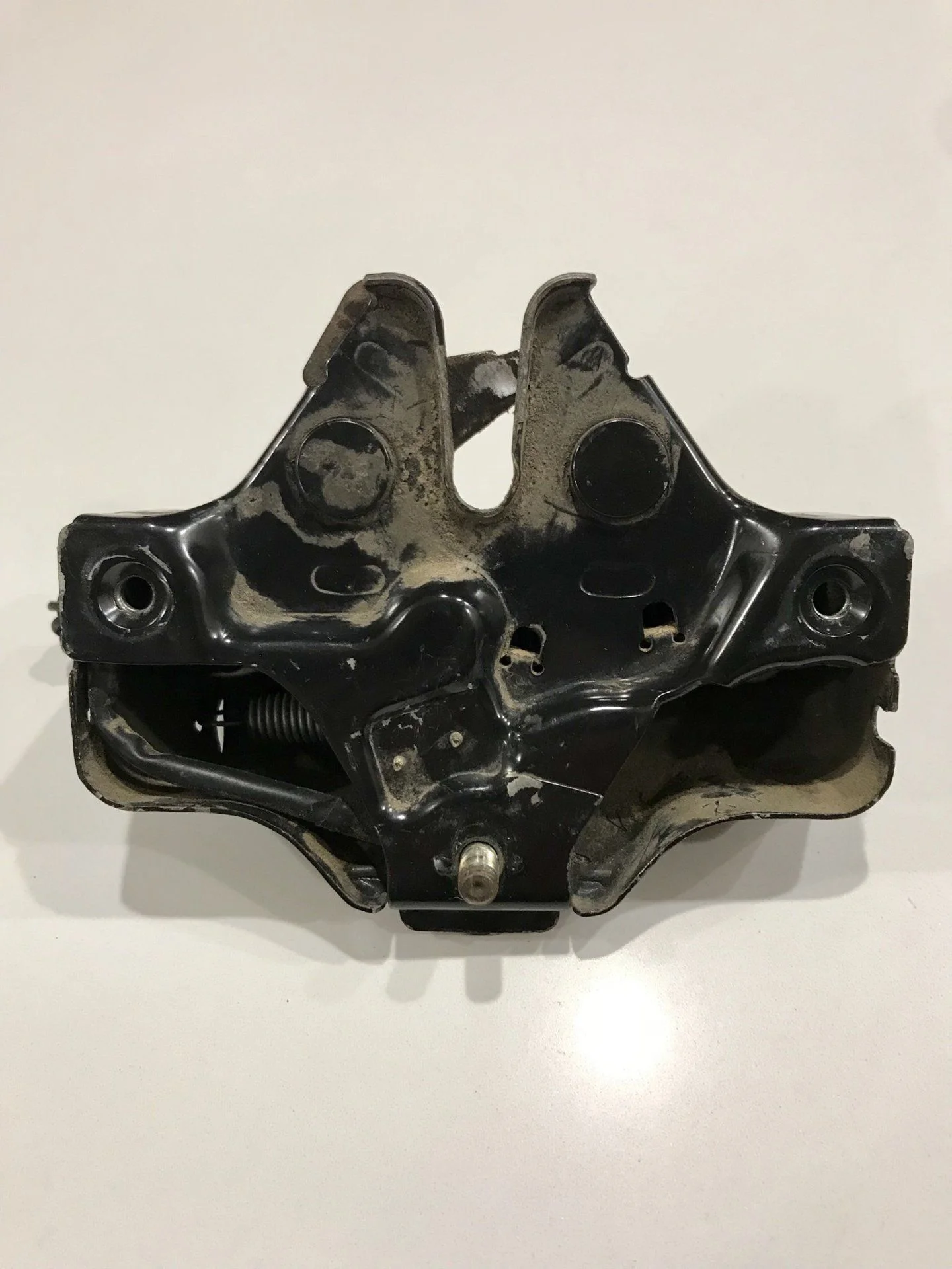

I replaced mine a few years back and recall it being three bolts facing the front bumper, as well as undoing the hood release cable and the electrical plug. If you can wait until tonight I will post up a photo of the old latch I removed and you can probably figure it out from there.
Here is a photo of the front facing side of the latch.
