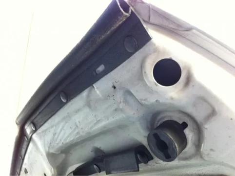

I tend to cruise a little quicker than most on the GA Highways. I get some hood flutter at high speeds. Is there a adjustment to tighten the front of the hood up? I am almost tempted to put some clear shipping tape on the gap to reduce the amount of air that can get in there.
I haven't looked at the 100, but on the FJC there are these little rubber bumper along the front under the hood (mounted to the body). They are screwed in and you can unscrew them to raise them to cause more pressure on the hood to eliminate a shaking hood. Not sure if the 100 has these but worth a look.
There is some sort of rubber bumper on them. I'm not sure if that will reduce hood flutter or push the hood up if I adjust them.
It is the rubber bump. mine is missing and my hood has fluttered for years. I replaced it once, and it fixed it, but then it fell off again.
Is the rubber gasket across the front still there? I've been 100+ on the highway numerous times and haven't experienced any hood shake. You could tape it and see what happens . Tires or front alignment maybe??
Rubber bumpers at both leading corners of the hood. Counterclockwise adds height, clockwise reduces height.

if fluttering...extend them away from mount position a little at a time. you want enough so that it has no room to wiggle the hood with their support...but not enough to put stress against it. You are just snugging them up with opposite surface....like balancing a washer or dryer from vibrating. Even pressure against hood on both sides....
