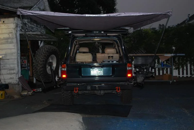

Homebrew Awning ( via swing outs ) pics.

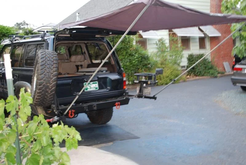

Sorry for the evening pics:

Udaman! What are you using for the support poles? Nice job!
Wow, you're a much braver soul than I, to weld on that nice bumper.

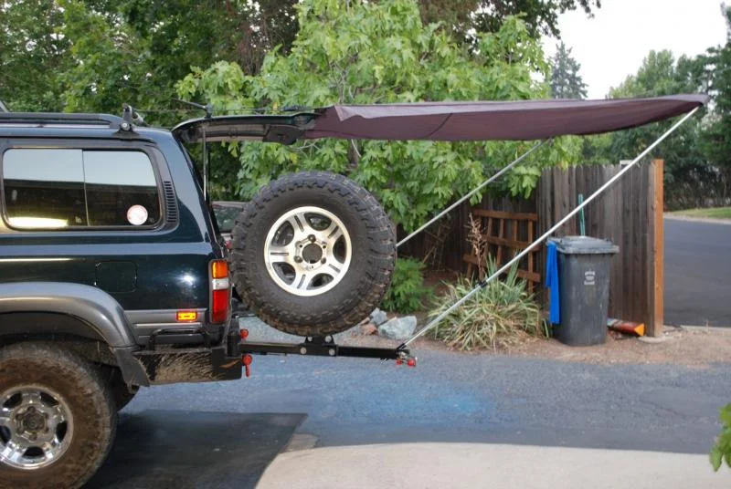

Details on attachment to roof, material type & design? Can't make out the logo in 1st shot.
The awning itself is from a little combo pack I purchased a while ago. https://forum.ih8mud.com/camping-gear-recovery/38937-gutter-mount-awning-2.html

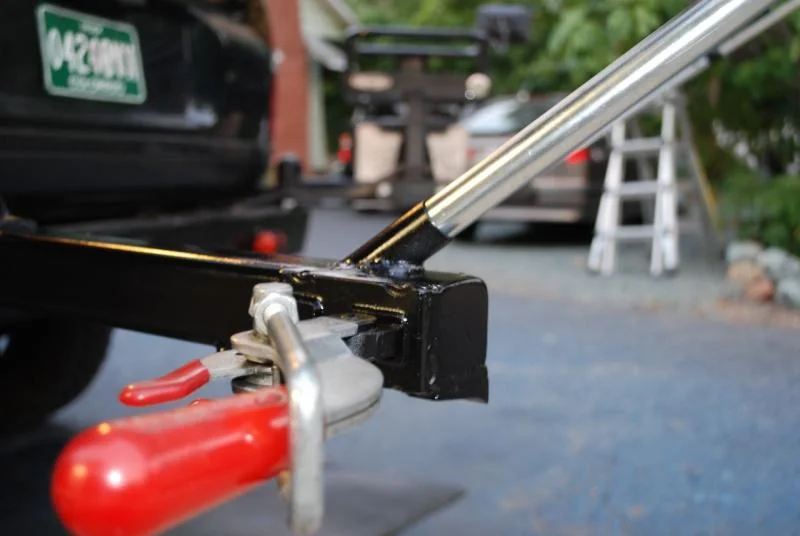

The supports are adjustable and foldable , I will get some better shots tomorrow, but the material is like a heavy tent nylon . I made some rope extentions that attach to the Yak rack and the awning attaches on to the extentions.
Naaa , dont have to be that brave to cut holes in something I created , its just a bunch of metal.

yea, I've wondered about that package, but the logo keeps putting me off. It's down to $50 though, worth it just for the chairs, if I didn't already have too many.

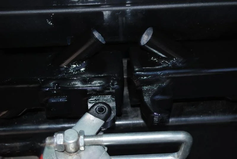

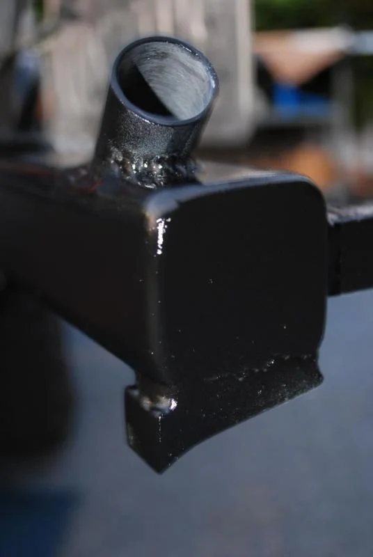

Looks great! Only thing I would suggest you add are some small holes drilled sideways as close to the bottom of the welded sockets as you can, so water drains out of them.
The receptacles on the swingarm's are totally open @ the bottom ( IH8rust )

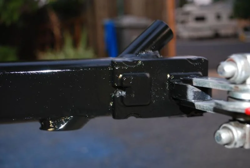

Only other thing.. Is Make sure the swing-outs lock in place when open... If they move inwards with the awning up, it'll all come crashing down.. (not sure if you have a locking pin already)

Ken, great job. This is the same set up Rick uses, his rig was the center of camp activity on the Sept. Rubicon run. It was rainy and snowy most of the time but he had a huge area where we could all congregate and drink, err I mean swap stories. :o
I think you will love it.
Got's 125 # lift struts :grinpimp: :wrench:

Nice! :cheers:How will it hold up in windy conditions?
Im not sure what a nasty wind would do to it but it cant go anywhere.
In the driveway windtunnel test's blowing 15 knots it held strong.
When I would leave it loose it had a tendency to want to lift. ( like a sail )
This weekend it will go through a full test at the beach camping on a bluff.

Maybe you could run a length of parachute cord from the top of the poles where they stick through the tarp back down to the sockets. Use a taunt line hitch to suck them tight. :idea: I might be worth adding a couple of eyes by the sockets to tie the cords off to.
