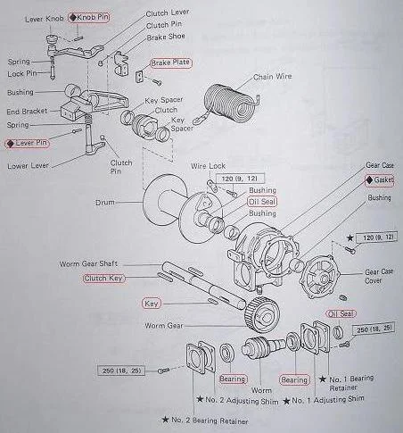

Hi I have a PTO Winch assembly from an HJ61 that I'm swapping into my FJ60 but I'm rebuilding it before I put it in. My local Toyota dealership said that if I had part numbers he'd be able to get me the Toyota parts but they're not in his computer. So I just wanted to know if anyone had the part numbers handy or had an alternative to getting them from my dealer. Below are the pictures from the body/chassis manual and the parts I need (circled in red). Thank you very much this would be incredibly helpful!

Take the seals and bearings to a local bearing house, same deal on the "O" rings. Chances are they can get the IDENTICAL parts for you. You can make gaskets if all else fails. Dust seal for the shifter and the parts for the pillow block might be a little tougher.
I've got a set of the keys (2 clutch and one for the gear) for the worm gear shaft here ($20 shipped assuming your in the states). PM if interested.
yeh i second that.. soo much easier and cheaper!
sor.com has all that stuff i recently got a pretty similiar order, cept my price was over doubled due to shipping (im in aus)
