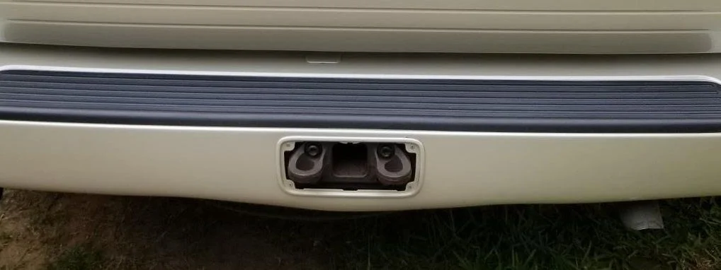

I’m looking to tow my new small bass boat (about 2,000 lbs with trailer) using the OEM crossmember towing hitch attachment on the rear bumper. However, there is a decent amount of rust on the crossmember area.
Any ideas for cleaning out the threads or whether the towing will be effected? Pics attached.

I found my wire brush and scrubbed the area well. Mostly surface rust that flaked off and the integrity of the metal seems solid.
Following up on the rusty in bumper mount area, I have the same issue, does anyone know offhand what thread size/pitch those bolts are? I have the receiver on the way and would like to chase the threads with a tap before install.
