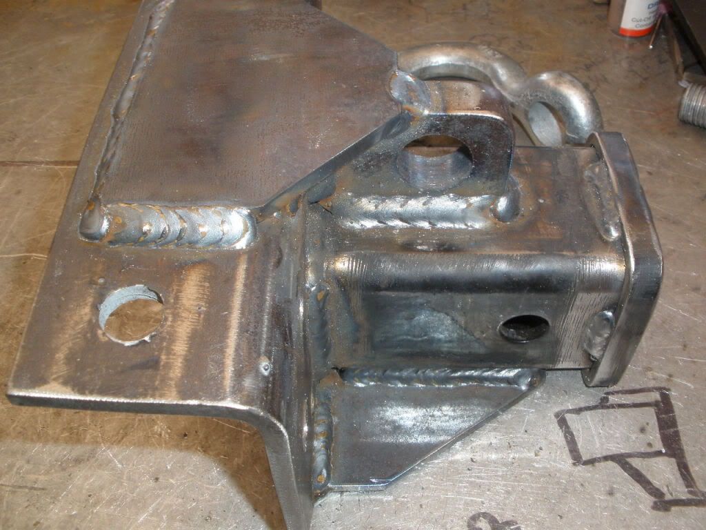

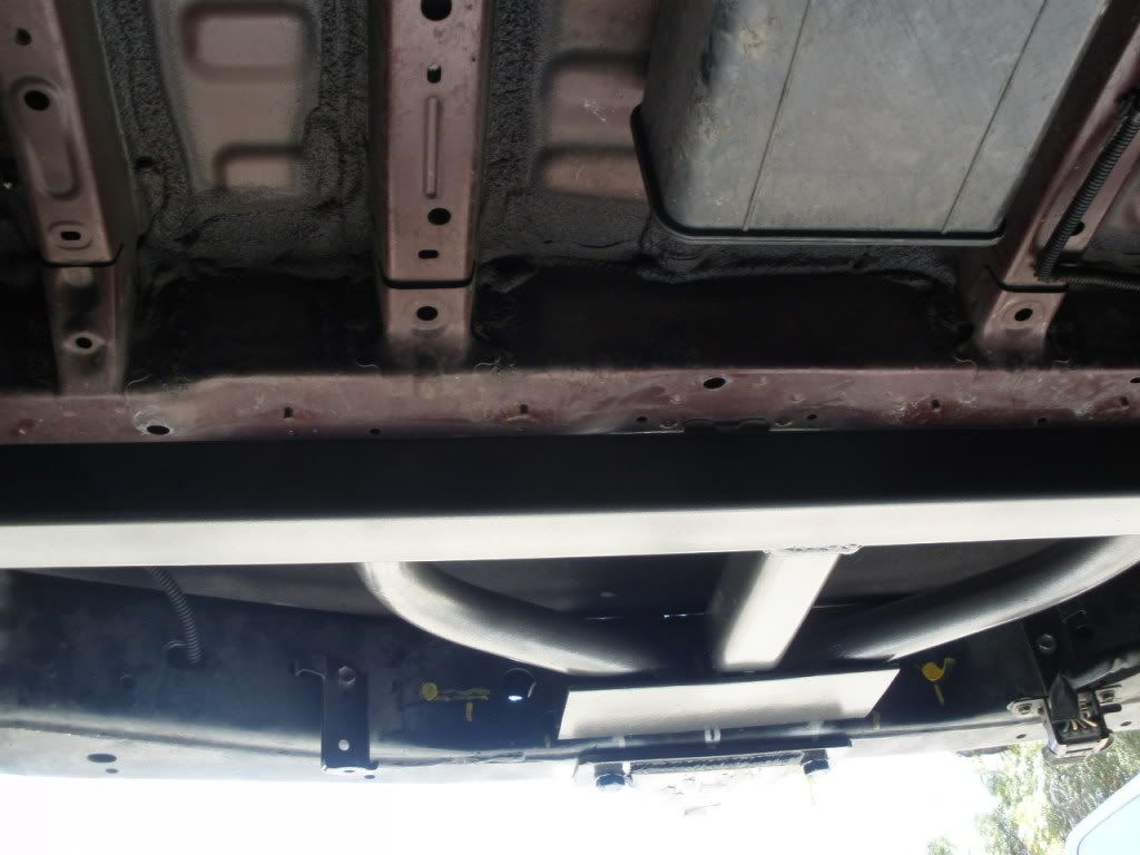

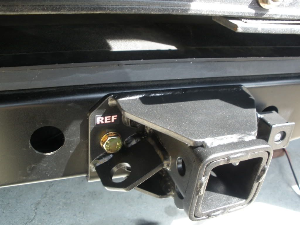

Here's a pic of what I made for our fjc and plan to do the same on the 80.
12 high stregnth bolts tieing this together.
That looks friggin' adequate, I'd say.:smokin:
Nice work. That's what will turn your LandCrusier into a real prime mover.
