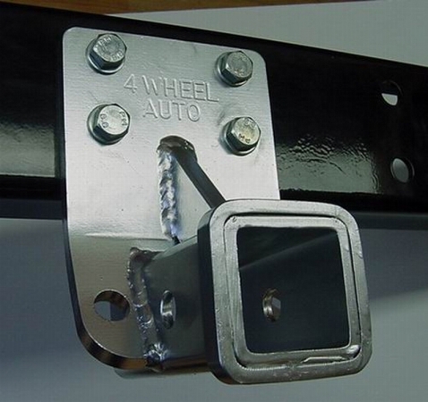

This one?
From 4 Wleel Auto in Edmonton, AB
