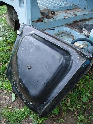

The gas tank is in good shape....... My liner is peeling in places.....
The white paint is over top of the blue.....rust proofing?

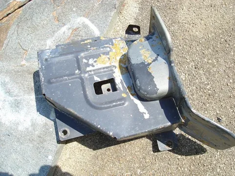

drivers side correct apron

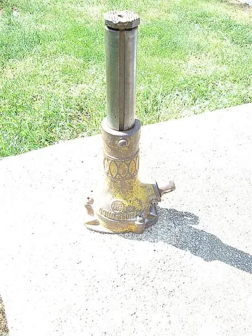

Winch: PTO/8274

I have an apron...need to check if it is in good shape.

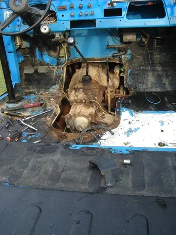

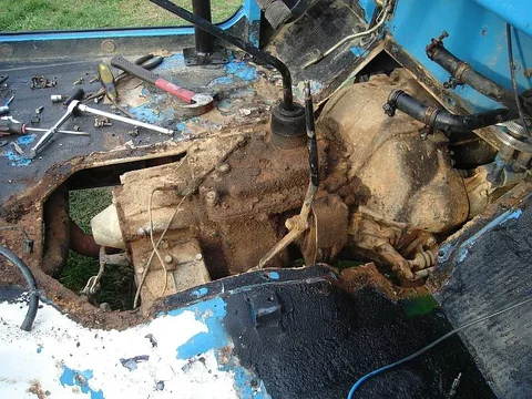

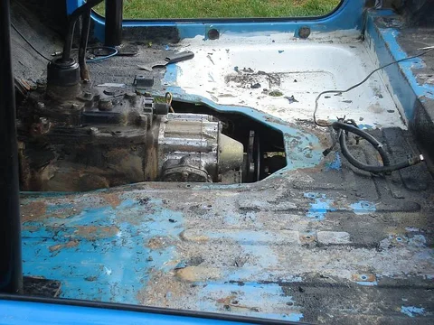

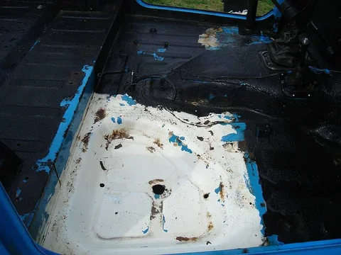

"Fiddled" around a little bit yesterday. Just generally cleaning things up, and getting to all the dirt that's trapped behind every little thing. It's been a while since most of this stuff has been taken apart. It's got several layers of gunk/paint around the floor pans and trans cover. The good news is, there is still factory paint and solid metal under the crap. There was a lot of dirt, debris, pennies, etc, caked up under there. That stuff is what concerns me the most, holding moisture, and encouraging rust. I'm a little nuts about this stuff, but I plan to keep this thing for the rest of my life!;)
The bad news is, even though some of the bedliner is peeling up cleanly, alot of it is going to be a mother to remove. There's a layer from the PO, that was kinda sloppy. And then a layer that I applied hastily. I'd love to get it all out and start fresh. I'm in the mood to go nuts on this thing and "do it right", but I don't want to rush on it to make May/June wheeling. I might just clean the tub up good, and put some black paint down for now. :meh:

It looks like there is a very good chance that I'll have the tub off for sand basting by next weekend.:rolleyes: :hillbilly:.....No really, I talked to my guy about it today.
I've spent the last couple of days pulling things apart, cleaning, scraping bedliner off, and finding new areas of surface rust left and right. IH8RUST!! I think it's time to bite the bullet and POR15 the whole dern thing. I'll never be completely satisfied until it's done right. Maybe I'm crazy. I don't mind scratches and chips so much, I just hate the thought of rust festering over time. Rust never sleeps!

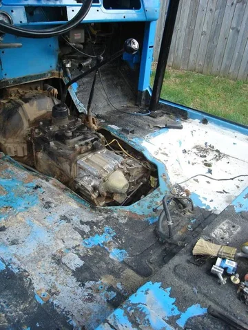

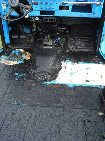

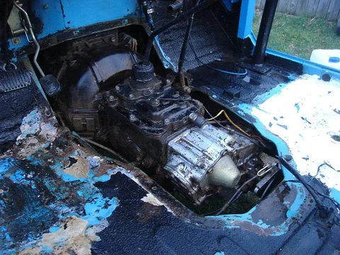

I have stripped the tub down pretty well for a good cleaning and touch up. Stripped the dash and dropped the windshield. It's kinda nice to get beneath and behind every little part for cleaning . I've gotten the majority of the bedliner scraped off.....The crappy, peeling liner was holding a lot of moisture in places, and rust was starting. I'm glad to get it off........... I think I'm developing some sort of cruiser OCD! :hhmm:
Anyway.....For the time being, I'm just going to put a coat of zinc primer and rattle can black paint in the tub to hold me through the summer wheeling.

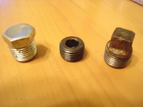

I did get two parts knocked off my list. The knuckle grease plug that I lost. Admittedly, I didn't put in a ton of research, but I had some trouble coming up with an alternative to just ordering one from SOR. [15 bucks + shipping iirc :eek:] I took mine down to Specialty fasteners, and this is what they came up with. 3/8" pipe thread. I raised an eyebrow at first, but they thread/fit perfect. :meh: I bought two of each....2 bucks. [OEM on the right] I used the allen head.

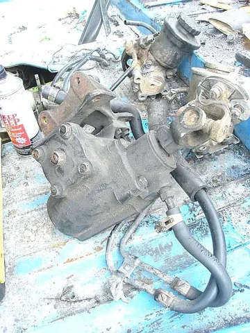

I also picked up mini truck power steering gear. [Thanks Eric!] I had that PS pump from a 2000 Tacoma in my shed. I'm wondering if I can make it work with the mini set-up??

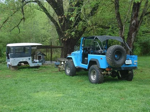

I also got the new yard ornament Saturday.:hillbilly: [Thanks again Eric!]
Good progress! If I had known you were coming to Greensboro to pick that tub up at Erics I would have given you that round bezel. I hauled that tub back for Eric a couple of years ago, it would make a great tub for strictly a trail truck, Good find.
:doh: Crap! I didn't even notice that you were in Greensboro before. It was kind of a rush decision to go down. I had intended to make it earlier in the month, but ran into some issues that delayed me. I promised to have it out of his yard by the end of the month, and it crept up on me pretty fast!
I really don't have any immediate plans for the tub. I'm a sucker for free parts. :hillbilly: I'll definitely find a good use for it. Trailer?, dedicated trail rig?, patch panels?, big flower pot?...... In the mean time, it makes a great hard top stand.:grinpimp:
As many cheap/free body parts as I see popping up, I'm tempted to use this as a welding/body work training piece and make a decent complete tub. :hhmm: The floors and wheel wells are actually pretty damn nice.

I've gotten almost all of the old bedliner out of the inside of the tub. Unfortunately I found two rust holes/patches that a previous owner did a terrific job of hiding with fiber glass resin, bondo, and then bedliner.
Nothing major, one about the size of a silver dollar where the trans tunnel meets the lower fire wall on the driver side.....That area of the trans tunnel is eaten away some too.... And another small area in the back of the tub floor, right against the wheel well.
The good news is the rust was really localized, and what ever the p.o. did to treat it, completely stopped it from progressing. Since I'm planning to do a full paint job later this summer/fall, I'm just going to leave it alone for now. When I prep for paint, I'll cut it out, and weld in some clean patch panels. I'd like to find a nice rust free trans tunnel to replace mine with too.
There's been a coat of bedliner inside the tub since I've owned it, so this is the first time I've seen bare metal inside the tub. It surprised me to find the rust because I've worked under the tub quite a bit, and the underside appeared to be pretty close to pristine. Nothing hiding.....only the factory dry flaky undercoating, and where it was gone, very clean factory paint was visible. No cancer anywhere underneath. All the body mounts and seams, and just about everything look almost as good as new underneath.
Anyway, for the time being I'm just primering the inside of the tub until I can do it right, and putting it back together.

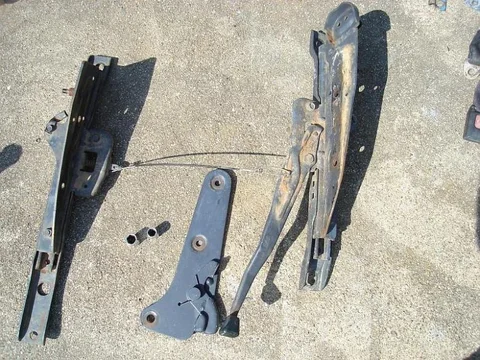

Since I've been on this restoration kick lately, I've turned my attention to some other little things that are showing their age due to repeated exposure to dirt, mud and water.....soooo I went to work on the gas tank, seat frames, seat back covers, factory jack, and gas filler cover. [yeah, I know I'm a nut. ;p] I've dismantled everything completely, and am hand sanding/wire brushing smooth...several coats of primer and paint. Not looking for perfect....just nice and clean.
