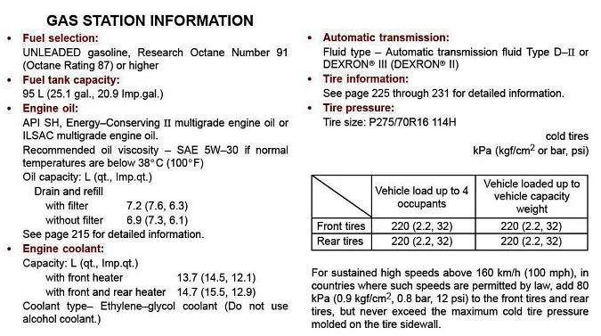

OK, I was right before I was wrong. :D
I recalled a thread a while back (~18 months) where Bear80 stated the Lexus OM specified premium fuel (it does not.)
Then I recalled that Doug had stated that Lexus specified premium across all their products. (See above link by Curtis)
I was somehow convinced that the LX450 OM also specified premium.
attachment.php
Soooo.... Nevermind. :sheepishgrin:

I still swear the LX450 I had for a while, had it printed for 93 octane and I know I didn't confuse the Research Octane with the Ocatne rating. Maybe it was something printed by Lexus or the dealer along the lines of what Doug pointed out.
