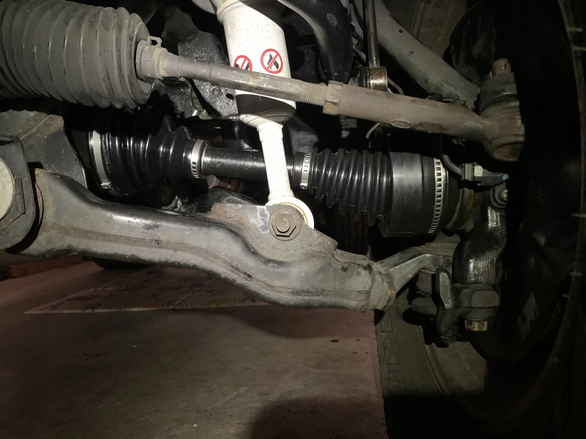

Nice. Here was my Allpro boots once I was finished. I probably could’ve stretched the outer just a tad.
