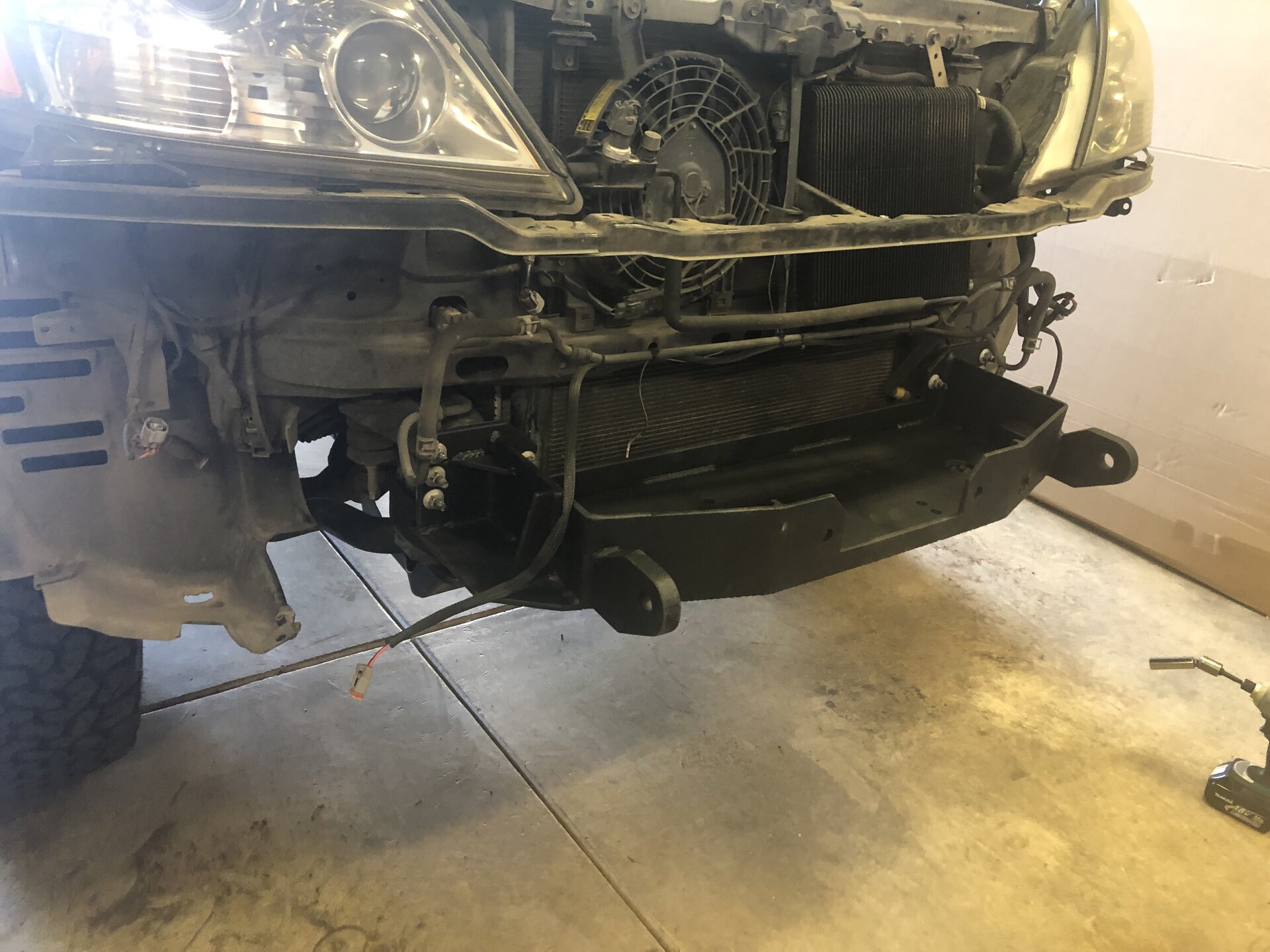

The winch plate is extremely strong, with 1/4” steel, beefy recovery points, beautiful welds and plenty of gussets and structure. Weighing in at about 60 lbs and attaching to the frame rails with 10 bolts, this thing is hell-for-stout, yet everything lined up perfectly. Install was a breeze.

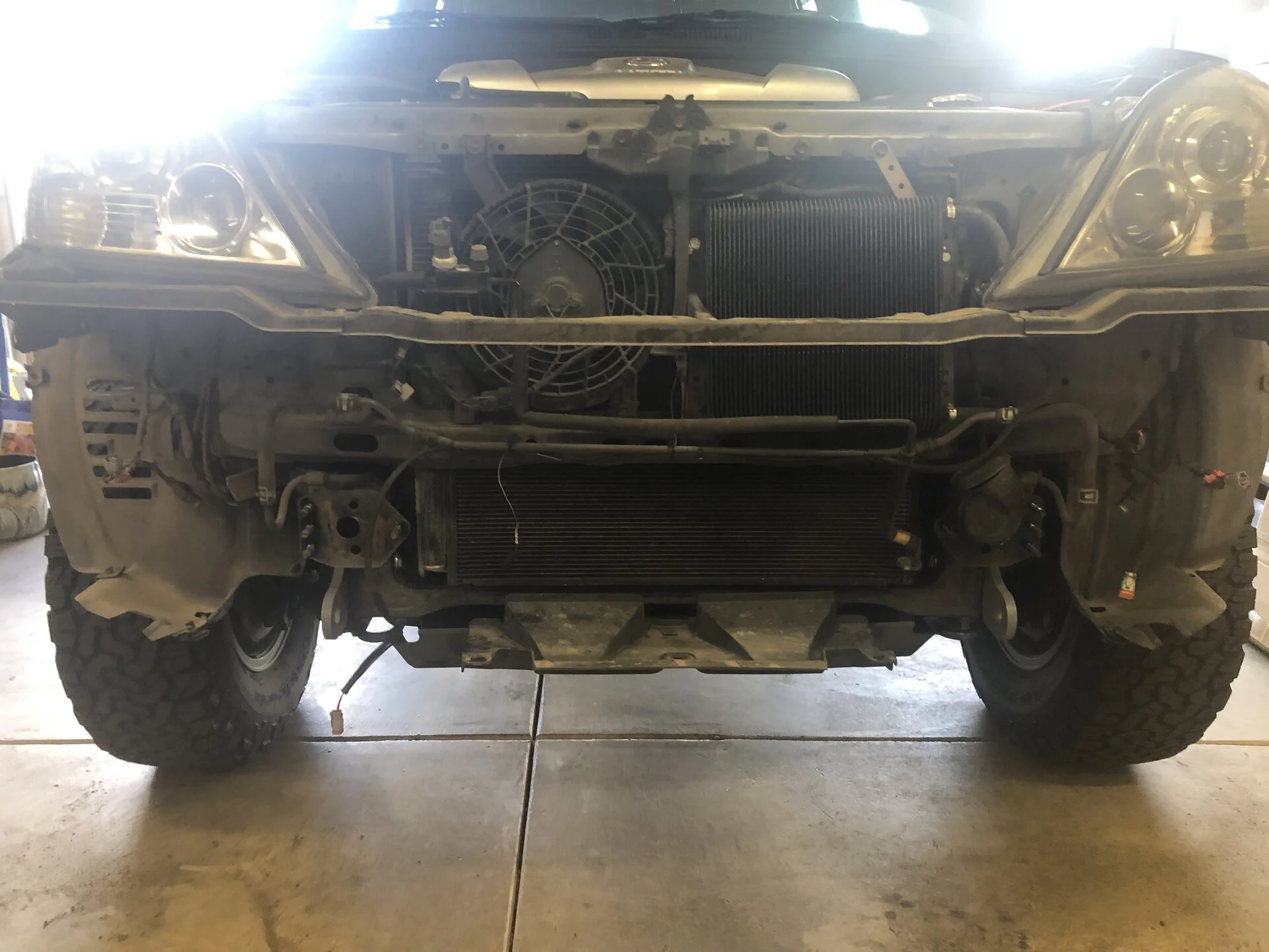

After removing the bumper fascia, my buddy and I removed the front crash bar. This gets discarded, but the hardware gets re-used.
The HK winch plate installs on the frame rails using that hardware.

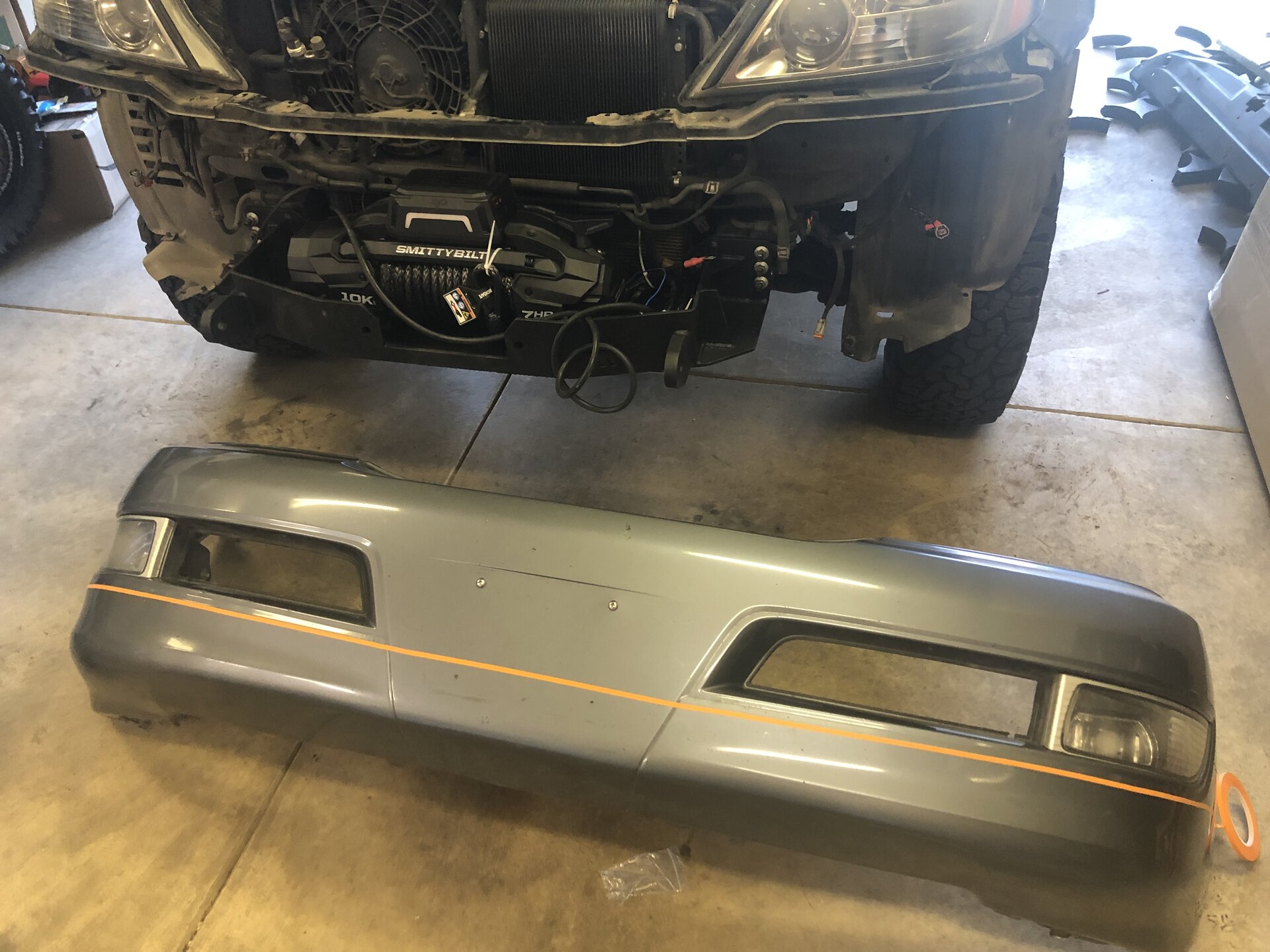

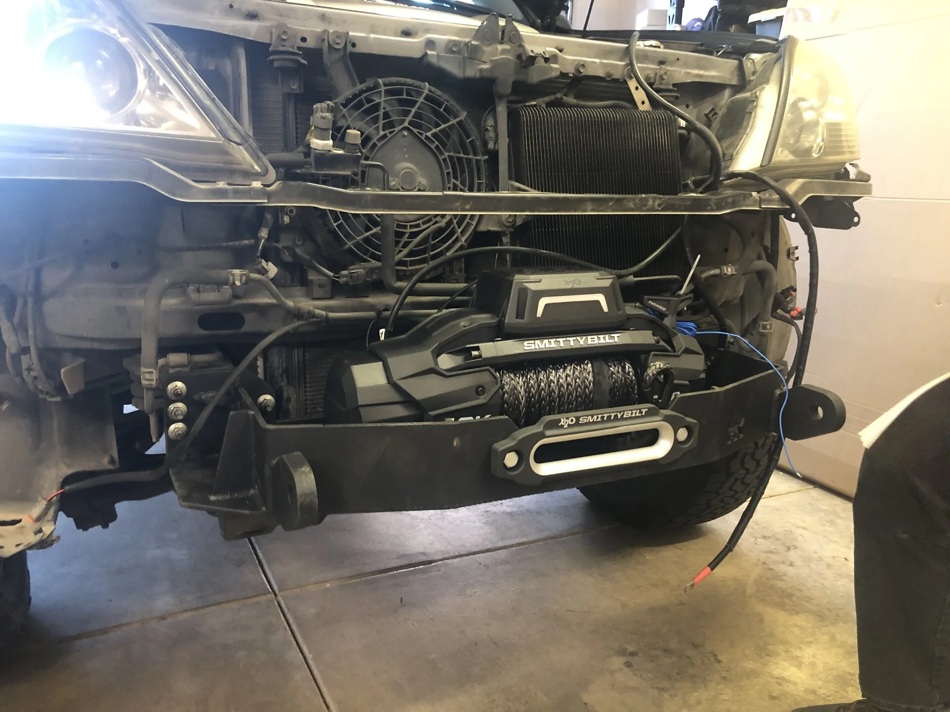

Once the plate was secure, we bolted a Smittybuilt X2O 10k winch to it and wired it up. Everything was very straightforward.

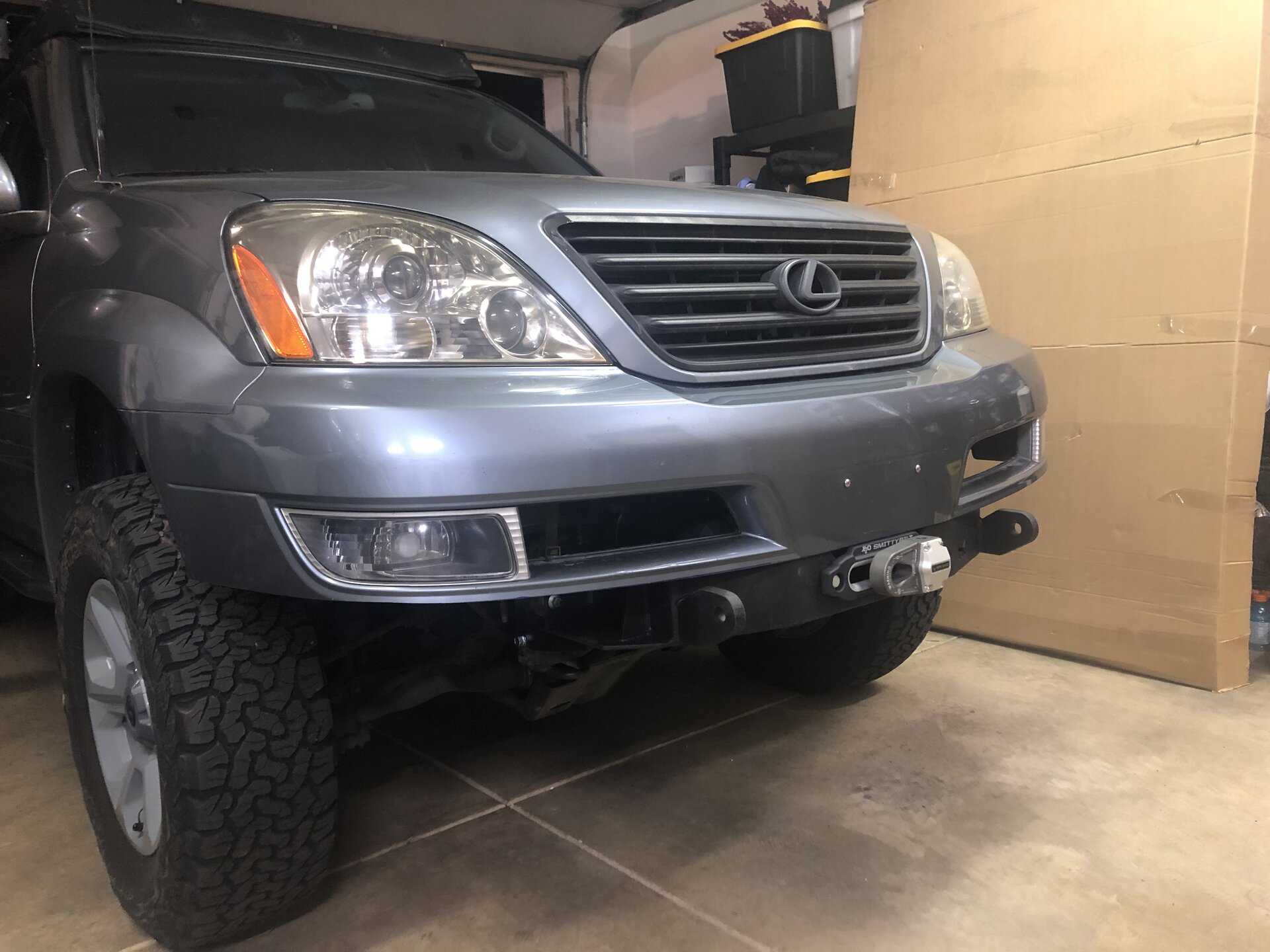

Bash has some installation pics on his site…one of them shows a rig that had the bumper nicely trimmed…it looked great!
So, out came the grinder, and 10 minutes later I had a bobbed bumper and a not-so-hidden winch. But it looks just right and I’m very happy we went that direction with it.
