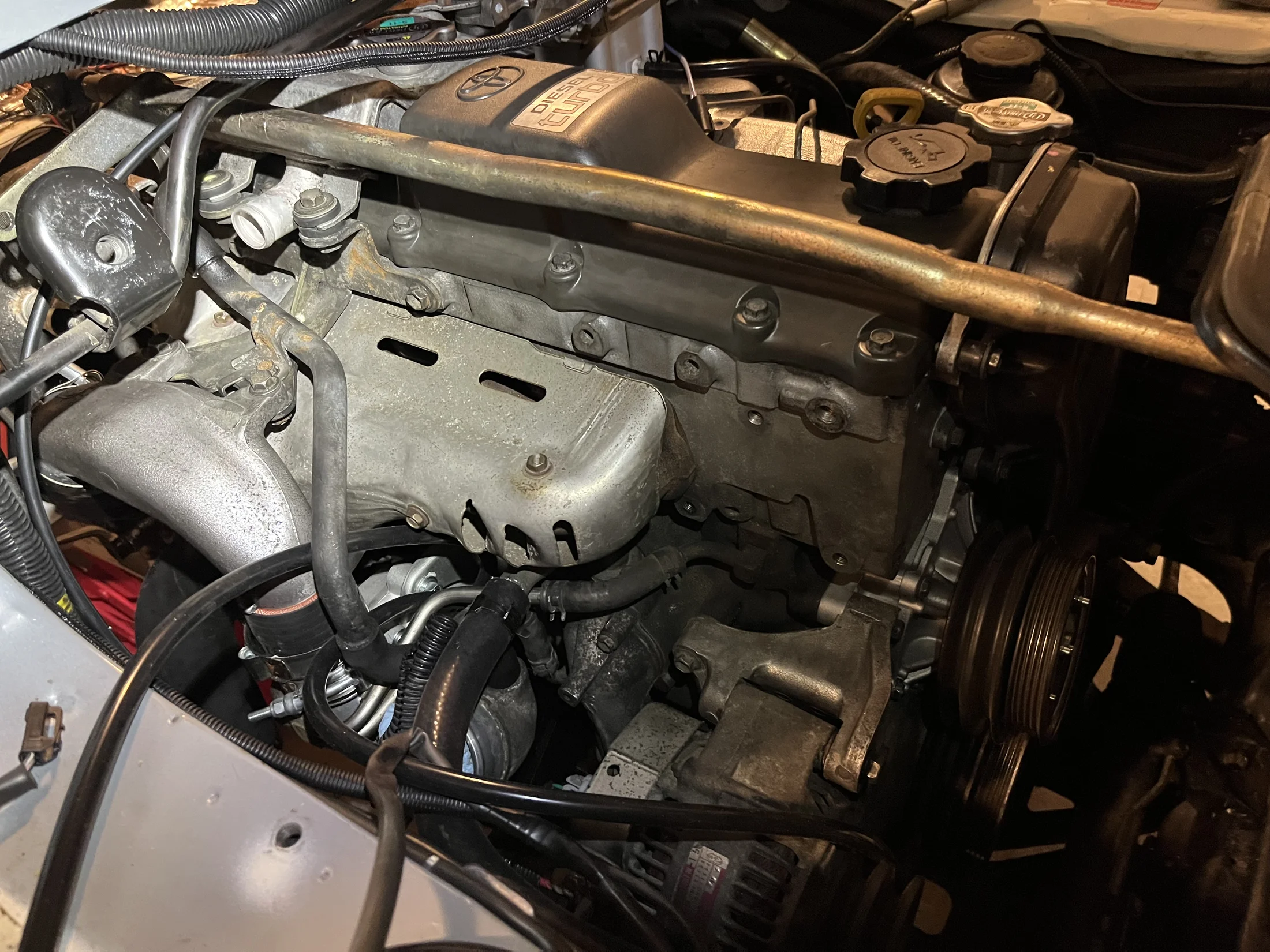

I started out by slapping a turbo on the original motor — and to be fair, it actually woke the truck up pretty nicely in terms of power. But the install was a pain. The tight cabover layout combined with the manual shifter linkages made the packaging super awkward. Everything felt crammed, and it never quite fit right. In the end, the whole setup pushed the little engine past its limits — ended up popping it and losing compression on cylinder #4. So yeah… good power, but not worth the headache or the blown motor.
Looking back, I kind of wish I’d just gone straight to an engine swap from the start. Would’ve saved some time, money, and a blown motor. There’s basically zero solid info out there on engine swaps for these cabover trucks — it’s a bit of a black hole. That said, I did find a few threads about folks going from L series to 1KZ or 1KD in Hiluxes, and a couple of mentions of it being done in vans. Nothing detailed though.

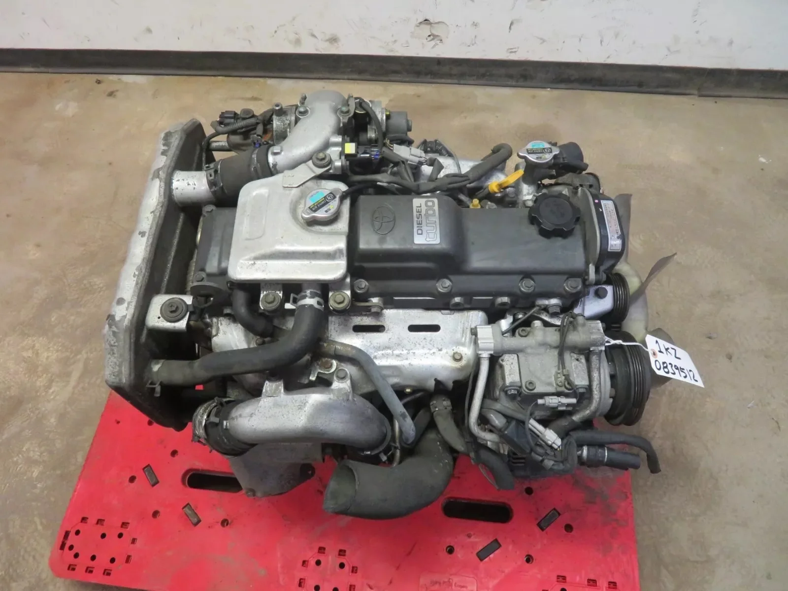

Sourced a later-model Hiace 1KZ with the factory water-to-air intercooler (bonus!) for a very reasonable price.

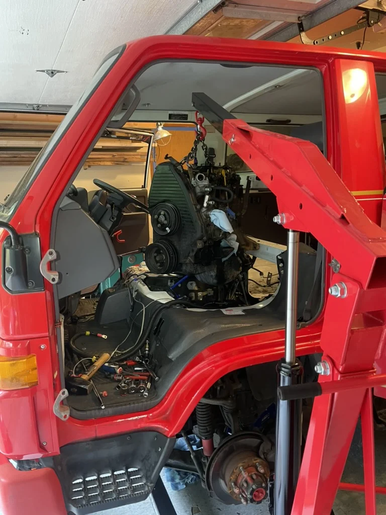

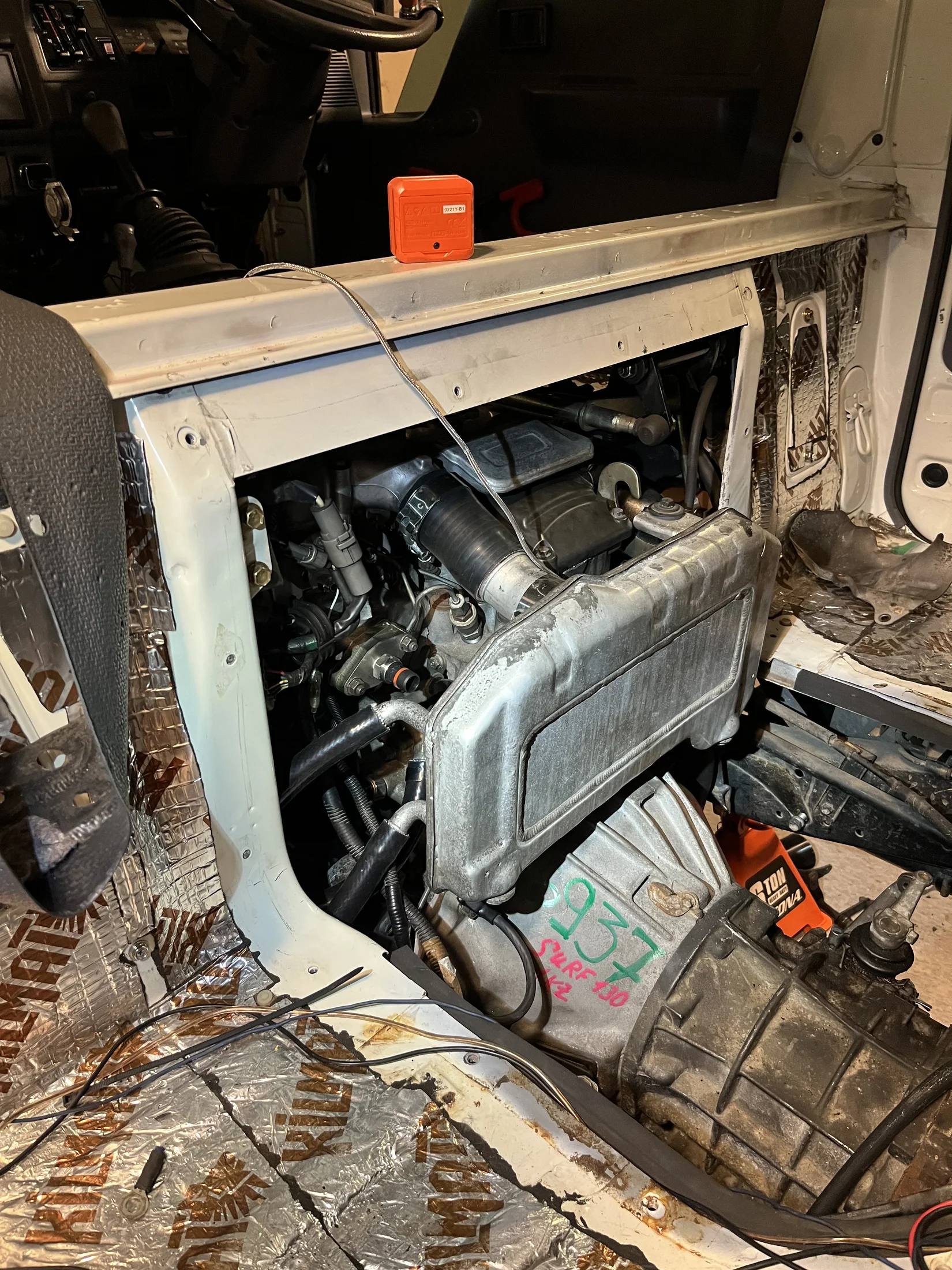

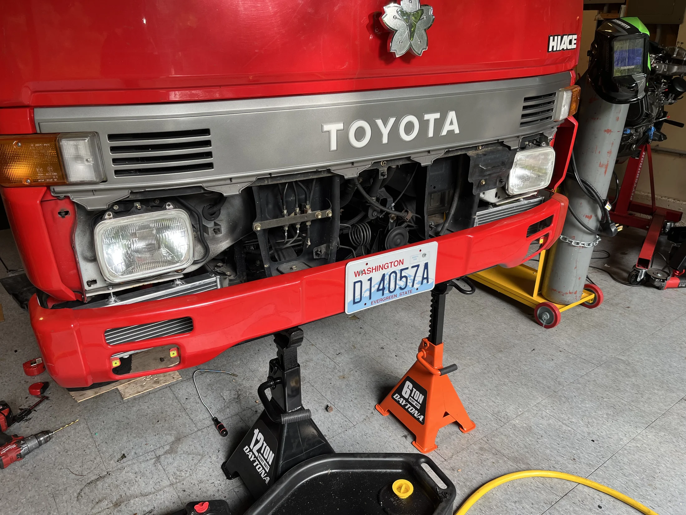

I was dreading having to pull the engine from this truck, but it actually ended up being way easier than I imagined. Although you need to pull it out through the passenger door, everything is easily accessible and very straightforward. A 2 ton crane with the exteneded reach and a swivel hook is definitely necessary.
Next step was to make the engine mounts. I decided to design them, then test with 3D printed mounts before ordering the steel from Send Cut Send and welding them up.
I knew the Hilux guys had it easy — swap from L series to 1KZ usually just means shifting the mounts 40mm. Was hoping for the same… no such luck.
The Hiace 1KZ mounts I got are wider and identical left/right, while my chassis needs different spacing/height for each side. I started out by designing some mounts that would position the block with the top mount holes at the same position as the stock 2L. After a test fitment, this was definitely too low. I raised the block 25mm, and the fitment seems bang on. Plenty of clearance on top and the engine sits at the same 4.5 degree tilt I measured on the stock one:
I was a little nervous trusting any weight on the 3D printed mounts, but they actually held up pretty well and allowed me to bolt up the transmission and verify alignment was good.

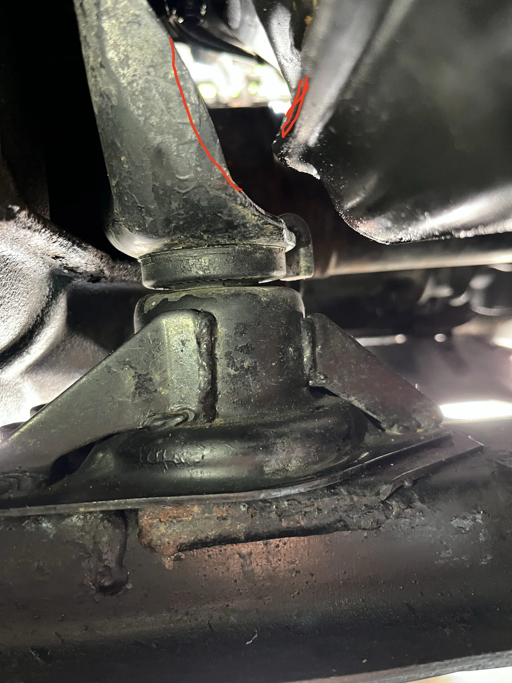

The only issue is the oil pan almost touches the front diff mount at the points marked below (note, I have the engine shifted over a bit in the picture, but it's closer when mounted):
I'm planning on grinding out that marked area on the diff mount. If anyone thinks thats a terrible idea, or has suggestions on strengthening it, let me know.

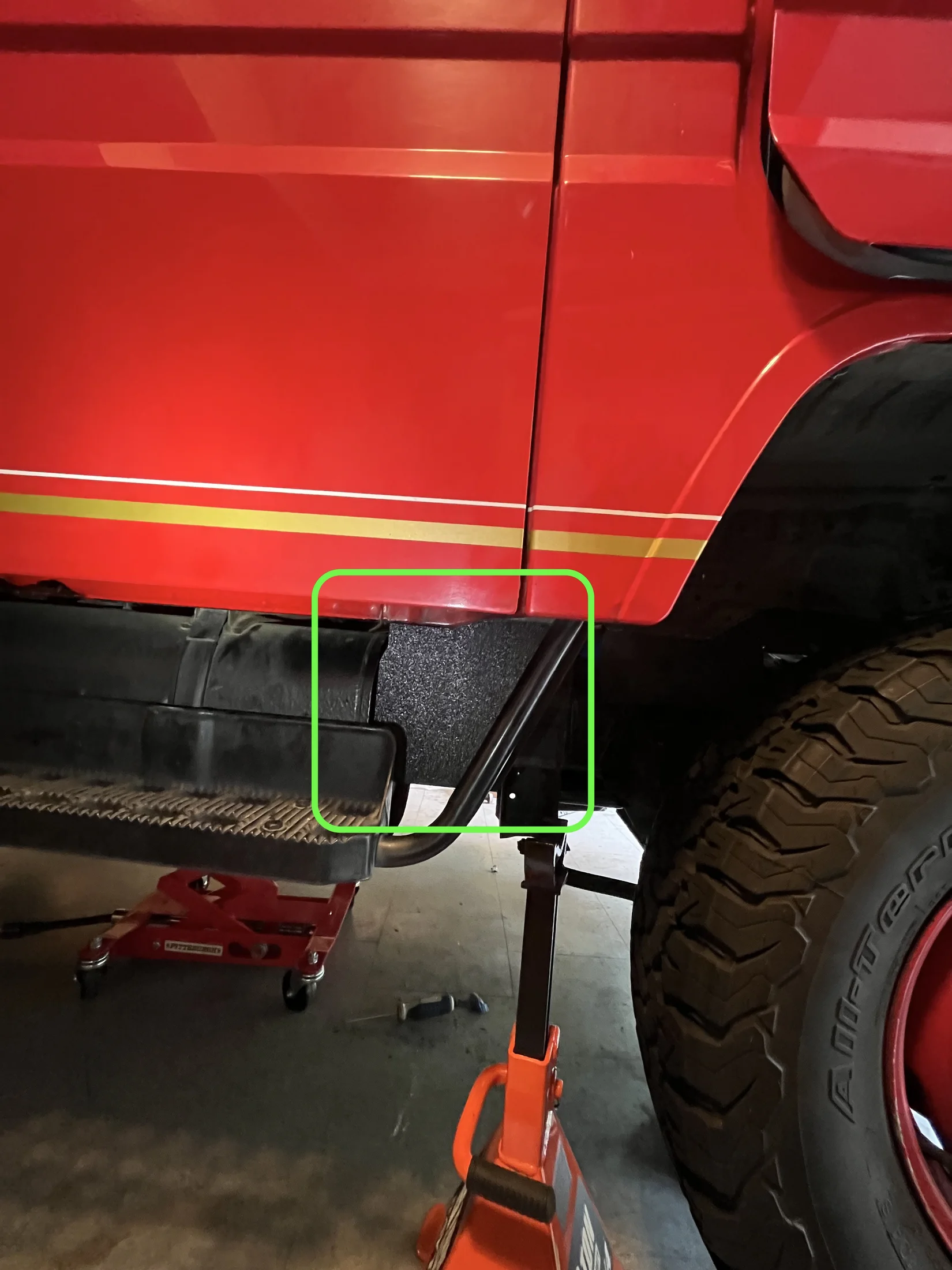

  • Water-to-air intercooler sits high/rear — going to have to trim the rear hatch panel above the bellhousing for clearance.

I don't think the slight trimming of that mount would be a problem.

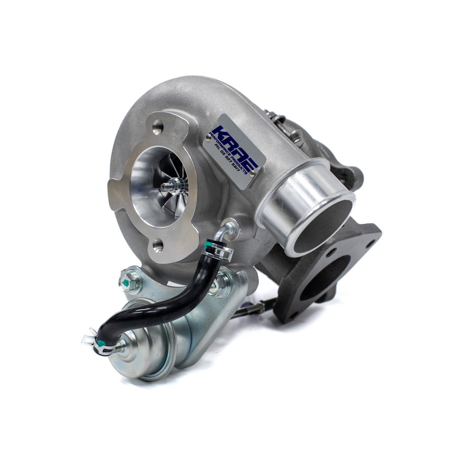

What's this "high flow" turbo? The stock turbo is a CT12B which is based on the MHI turbos but has a really old and inefficient turbine design. That's the part that needs fixed. A bigger compressor will just risk surge.
The turbo I'm using is this one:
It's from the same company I ordered the mechanical pump from. I spoke with them, and they’ve had direct experience with the factory water-to-air intercooler I'll be running. So I figured I’d let them set the pump based on their experience and the build notes I sent over — at least as a baseline.
I was kind of on the fence about the turbo, but since it's a drop-in replacement and supposedly a more modern, efficient design, I figured I might as well upgrade while everything’s apart.

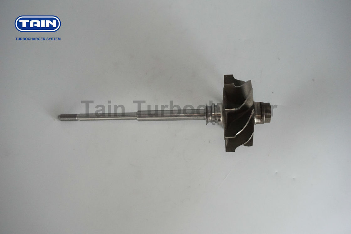

Sounds like they've just put a bigger compressor in it. I think you can do better than that. The turbine will still be old and inefficient and that's where your response comes from:
Here's a CT12B turbine. It's a paddle wheel from generation 1:
A MHI TDO4 turbo will give you a gen2 turbine which is much better at a lower cost. A gen3 11 blade TD04HL turbine wheel will do even better.

Probably similar to the one I have on my Dmax. That one overboosts to almost 30psi on hard acceleration. Which is interesting but not a big deal. Steady state load it's only ~15psi.
Interestingly fixed geometry turbines are more efficient than variable vane ones.

Been a while since I’ve posted an update. I’ve been puttering along slowly while waiting for parts to come in from around the world.
All the important stuff is finally here and I was able to drop the engine in, hopefully for the last time, and start working through the smaller details.

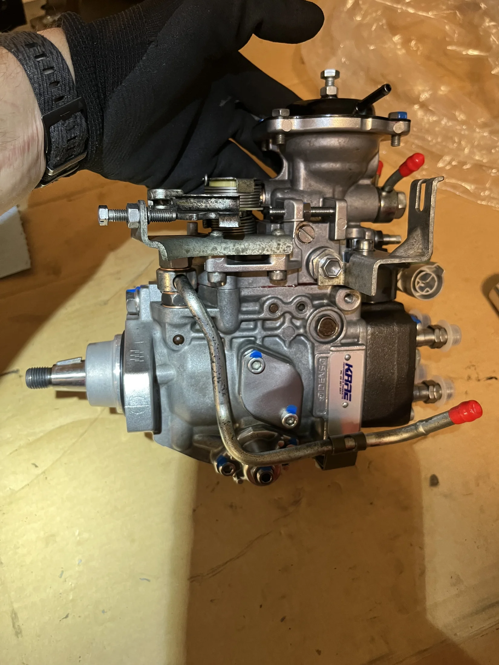

I got my mechanical pump, turbo, and injectors from KRAE in New Zealand. Installed the pump and timed it to their recommended spec. While I was at it, I also replaced the water pump, timing belt, valve cover gasket, and thermostat. Tried figuring out if the turbo's turbine is an upgraded gen 2 or not, but I couldn't tell. It didn't look like there was a paddlewheel, but it was hard to tell.

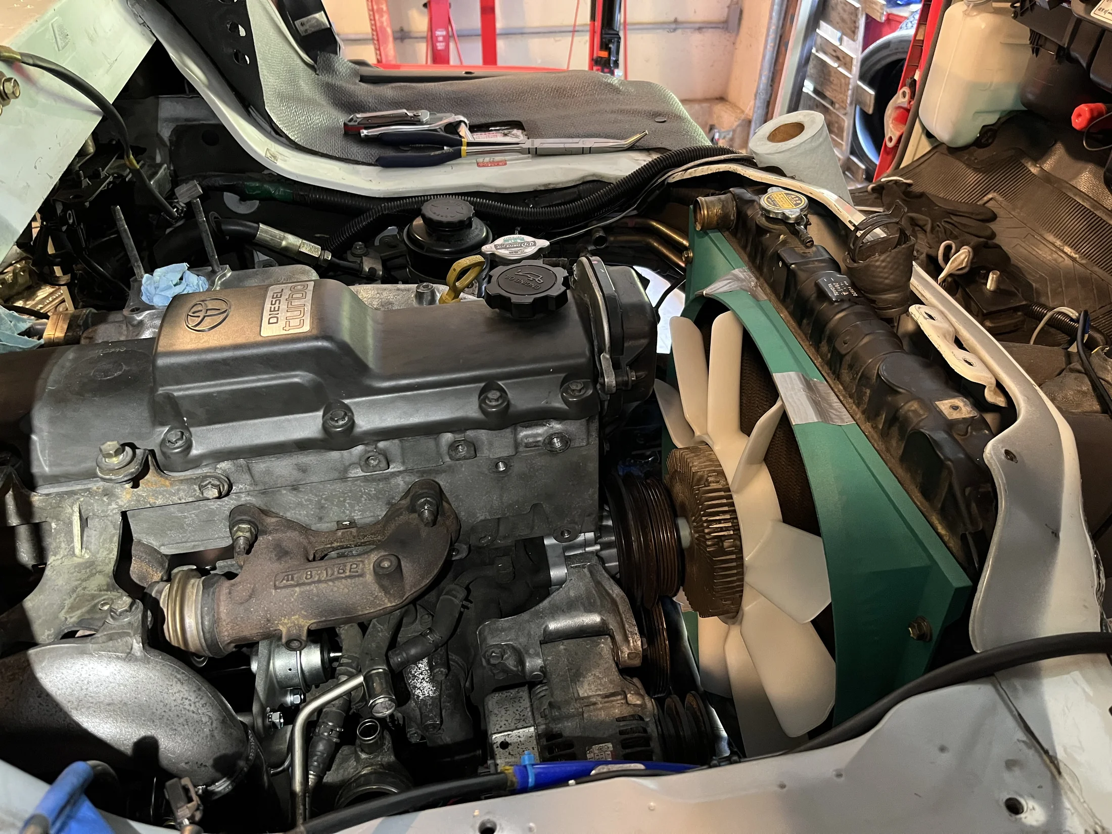

I’ve decided to place the airbox behind the front wheel well, in front of the fuel tank. This avoids having to cut the body for the snorkel and air intake. I still think the spot where the stock overflow tank sits might look cleaner and more OEM, but I’d have to use a smaller air filter and cut a big hole in the truck. That might be a later project. For now, I’m using a foam filter from UniFilter Australia. It’s 5.5" in diameter, 5.5" long, with a 3" flange. I printed a mock-up airbox that’s about as small as I could reasonably make it. I could move the fuel tank back about an inch if needed, but I think it fits well as-is. I’ll be 3D printing the final version in ASA-CF. I think 3D printed ASA should be fine since it will be placed behind the wheel arch cover and protected from rocks flung by the tires.
Radiator
I’ve got the radiator moved forward a bit and in a good place. I also 3D printed a mock-up radiator fan shroud. It still needs a few revisions, but I’ll have the final version printed in nylon by an online service since it’s too big for my printer. Still not sure if I'm going to go through the trouble of having a radiator shop place larger inlet/outlets and move the outlet from the front to the rear. I'm also not sure about the best way to go with the upper/lower radiator hoses. Seems like my options are to bend a wire of the routing I want and try to find a random oem hose that matches, or get a muffler shop to bend some aluminum tubing. From what I can tell, there aren't really any good DIY custom coolant hose options. If anyone has suggestions or recs, I'm all ears.
Intercooler
For the water to air intercooler, I've decided to use two small radiators instead of one large radiator. I wanted to avoid blocking the main radiator and I found a motorcycle radiator that fits in the left and right corners of the bumper. I know it won't be as efficient, but I'm hoping they'll do for my needs.

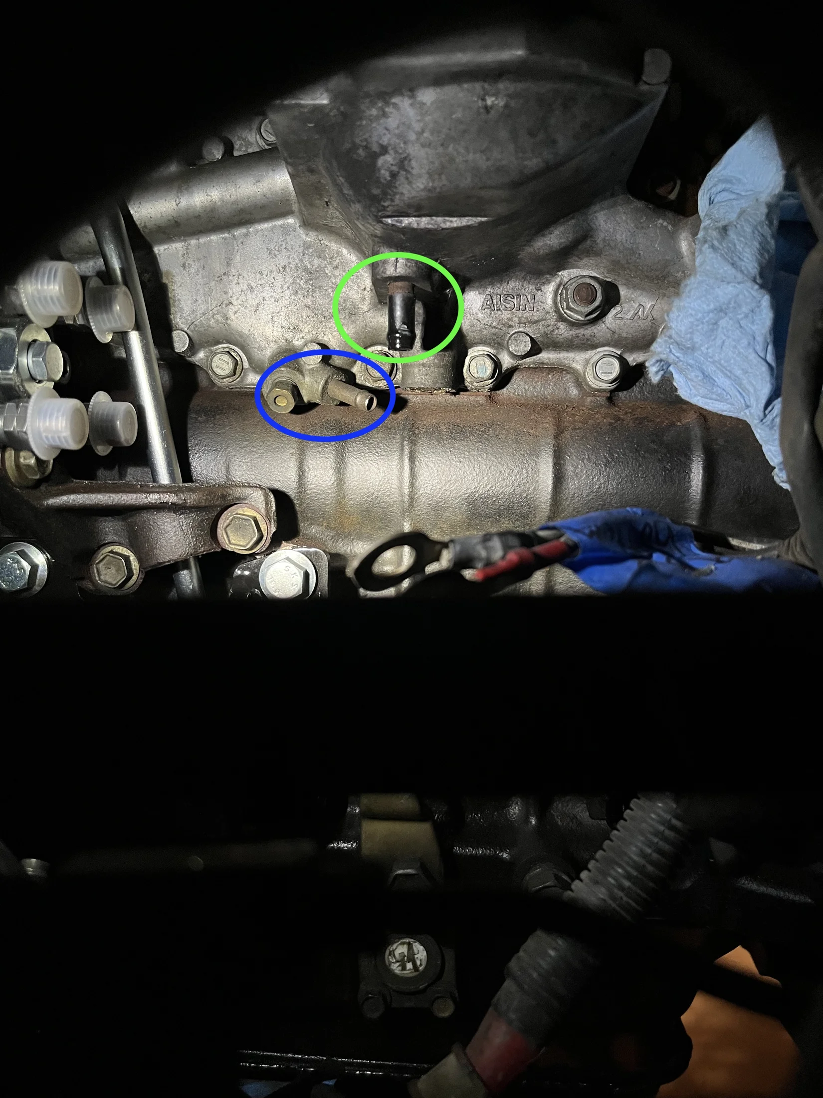

I also wanted to ask if anyone knows what the nipple in the blue circle is for? This is on the oil cooler/filter area.
I know the green circle is an oil drain, in the manual it explains to use it to drain residual oil during oil filter changes, so pretty sure I can leave that uncapped. However, I haven't been able to find any info on the other nipple. It looks like it might be coolant or vac, hoping I can just cap it off.

the blue circle is a coolant drain. loosen that bolt right next to it and coolant will drain out.

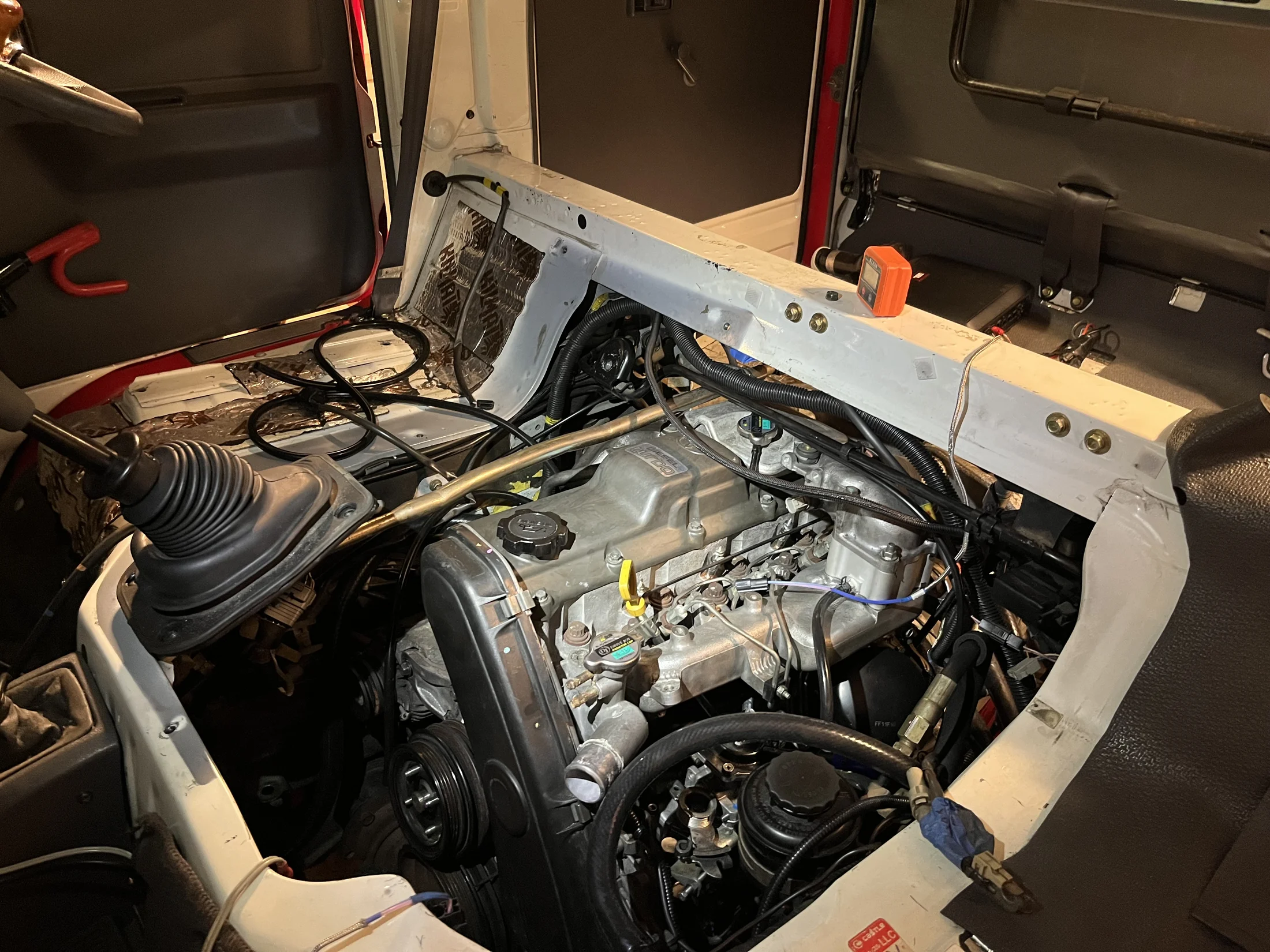

Finally had a free weekend to work on the truck. I haven’t been great with updates here, it takes time, but figured I’d give a quick rundown of where I’m at.
I decided to get my radiator recored and the end tanks modified so the inlet/outlet match the new engine (1.5"). I’m also having the outlet moved to the opposite side and clocked toward the engine. That’ll take a few weeks, and I’ve got other projects to juggle over the next month or so, so I spent the holiday weekend getting the engine as prepped as I could.
Electrical
I’ve got all of the electrical sorted at this point, other than the glow plugs. Converting from an externally regulated alternator to an internally regulated one was actually really simple. The new alternator needs three wires: L (lamp), S (sense), and IG (ignition). The external regulator has six wires, the three you need for the new alternator plus the three that went to the original alternator plug. I just snipped the wires at the regulator and crimped them together so the correct wires land at the new alternator. Then just snip off the old connector and crimp on the new one. At the regulator: solid white is Sense, yellow is Lamp, and white/red is Ignition.
The oil pressure sensor was the correct thread for the 1KZ-T’s sensor port, although it’s on the opposite side of the engine, so I had to extend the wiring.
The coolant temp sensor needed an adapter (M12 to M16) and also needed its wiring extended.
The original starter plug works with the new starter. The main cable was long enough to reach, but I did need to extend the smaller wire.
I ran out of time before getting to the glow plugs, but there’s a good thread on the super glow system: 2lt super glow wiring - https://forum.ih8mud.com/threads/2lt-super-glow-wiring.1323302/
Essentially, it supplies a full 12V for ~10 seconds via a timer, then drops to ~6V until the coolant reaches a certain temp. I might just wire the full 12V for now and revisit if cold starts are rough.

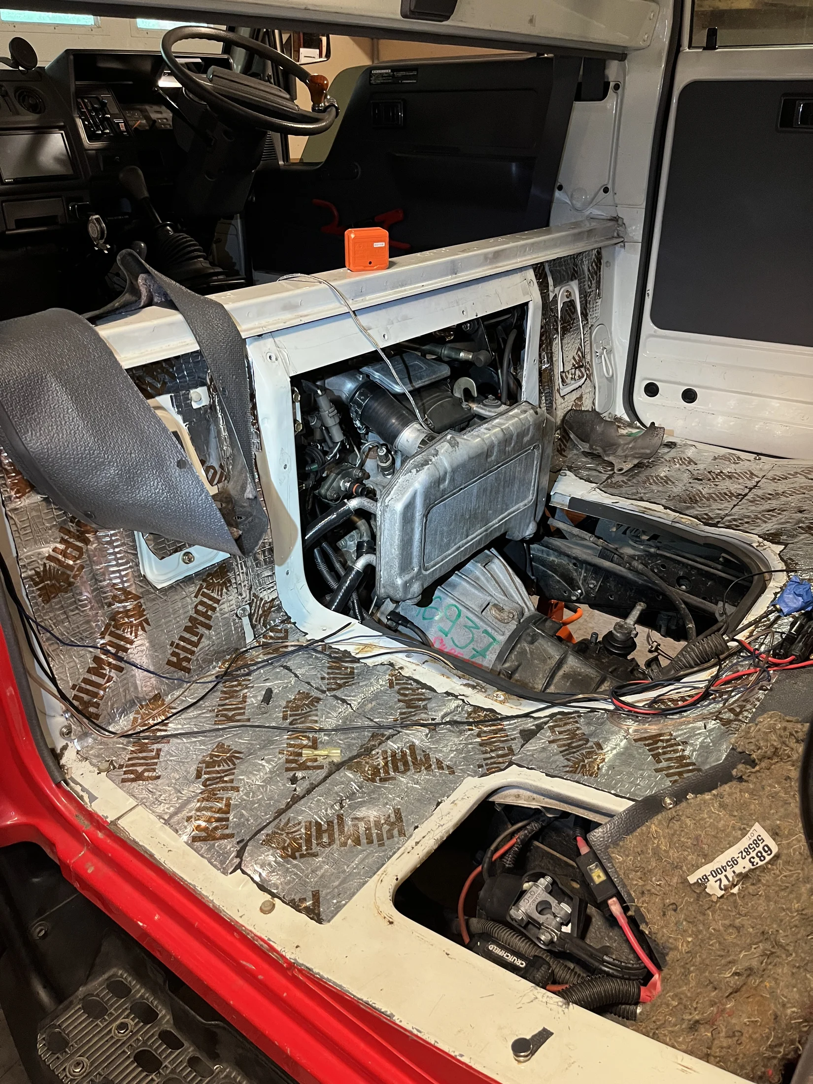

Here are a few pictures showing where I’m at. Ignore the general mess—I’ll be trimming some hose lengths and tidying things up.
Electrical
Miscellaneous
I put together a new throttle cable using aircraft-control components. The housing is pretty flexible and feels nice. I got the housing and cable from Aircraft Parts and Pilot Supplies | Wicks Aircraft - https://www.wicksaircraft.com/ and the cable ends from Cable Parts - https://www.flanderscompany.com/collections/cable-parts
I had a throttle-body adapter CNC’d for a very reasonable cost. It’s the same height as the original for clearance with the injector lines and glow plugs, but I added two NPT ports. I'm using one for the boost compensator connection and one for the intake temp sensor. After ditching the EGR, I added stainless block-off plates with NPT ports in each. I’ll put the EGT sensor on the exhaust side and the boost sensor on the intake side.
I was originally going to have the fan shroud 3D-printed by a third-party service, but the size made it way too expensive. I added lap joints to the design and printed it in sections with PPA-CF. The sections will be joined with small fasteners and DP420 epoxy. I forgot to take a picture, but it turned out great. I’ll do a final revision and reprint once the radiator is back and I can test-fit everything.
I was also planning to ditch the intercooler reservoir that came with the engine, I was sure it wouldn’t fit, but it looks like it’ll fit great if I move one of the shifter brackets over a bit. I wanted to do that anyway to get more room by the downpipe. That’s an exciting win and should keep the whole package pretty clean and factory.
The power-steering return hose was a smidge too short. I tried a few different hose options and ended up settling on transmission-cooling hose; it was the most flexible and let me get the bends right.
At this point, I’ve got all the electrical (minus glow plugs) sorted, all the coolant lines run (minus the main radiator hoses), the intercooler mounted, the intercooler radiators mounted, all the fuel lines connected, etc. I still need to mount the intercooler electric pump, plumb it, and wire it.
Here are a few pictures showing where I’m at. Ignore the general mess—I’ll be trimming some hose lengths and tidying things up. View attachment 3984896
have to be creative for the rear engine cover. You are using a hiace late model 1kz that is with water cooled. It is a serious challenge to put 1kz into LH80 .
