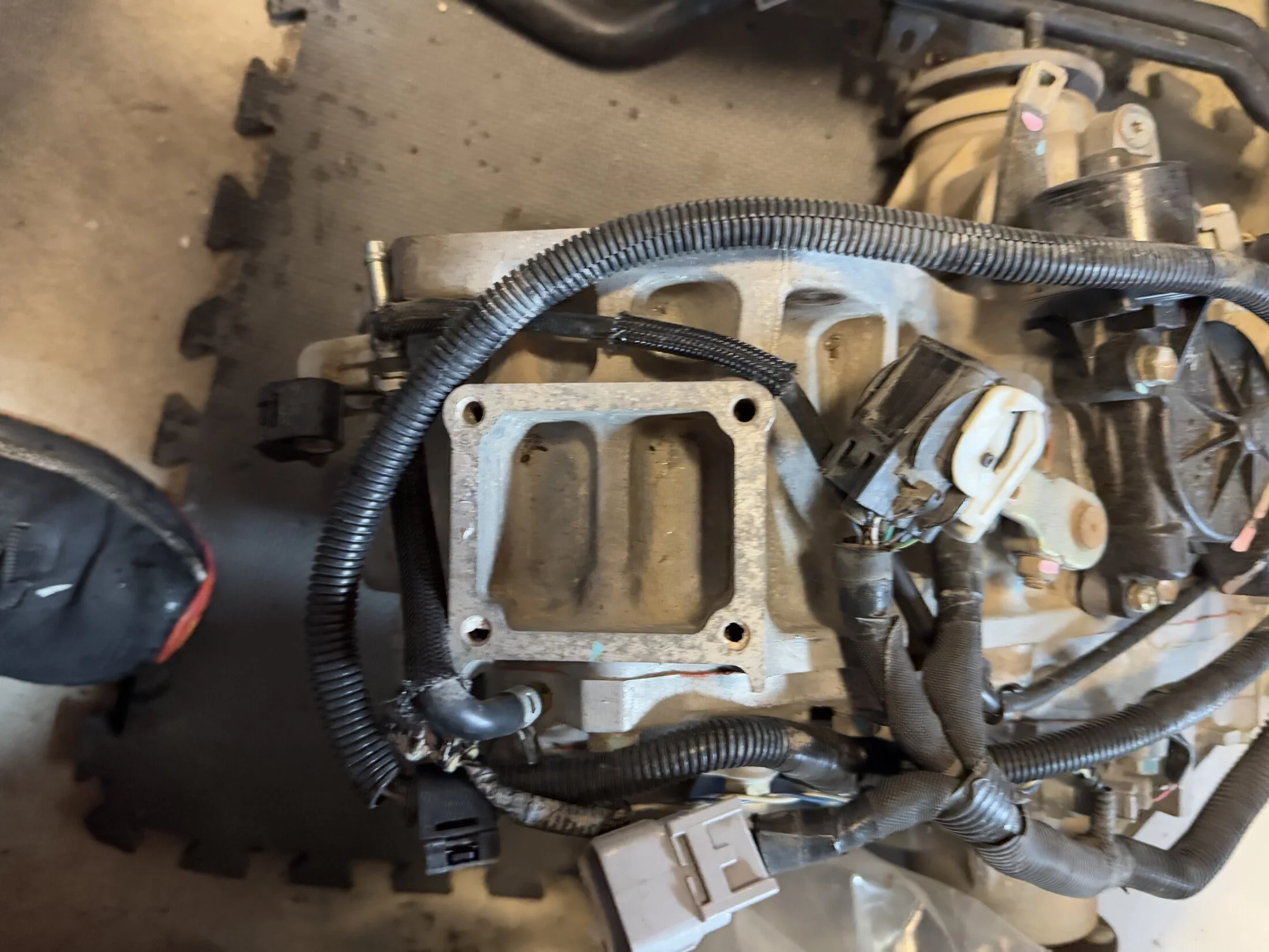

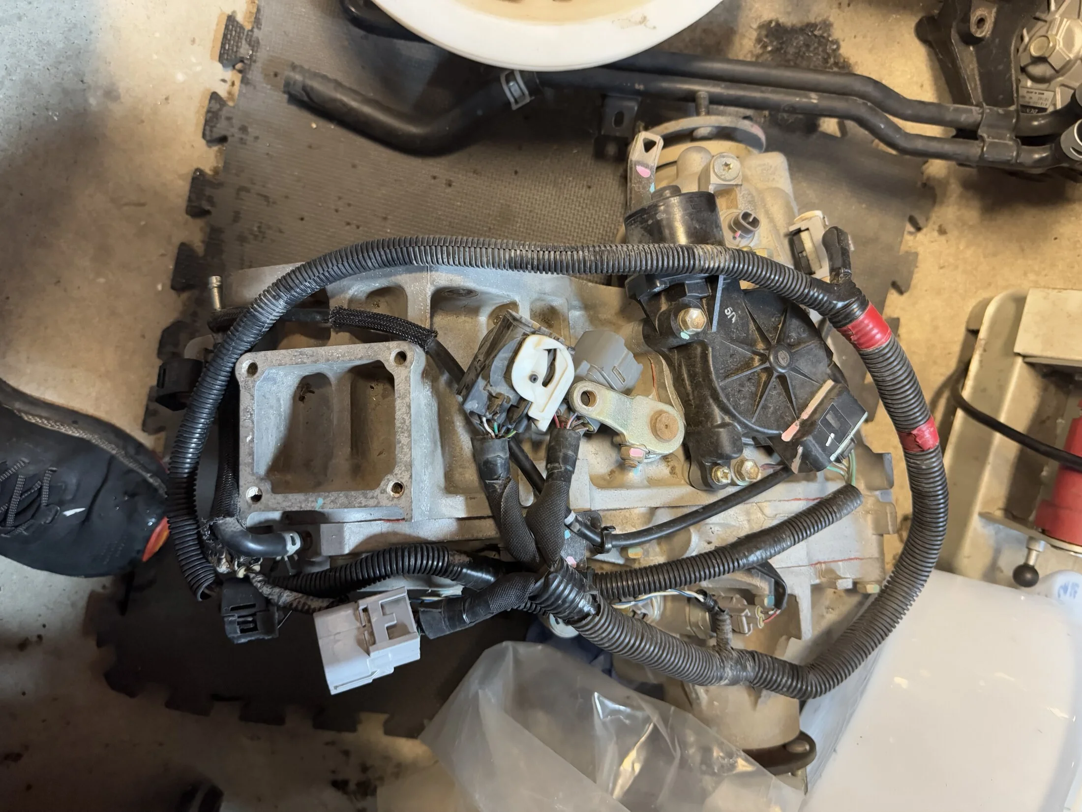

Do you have a photo of 36120-60520 by any chance? Unfortunately I need one that is compatible with the 100 series, which requires the square shifter mount on the casing (which I believe Toyota deleted on later 70 series T cases...)
Nick,

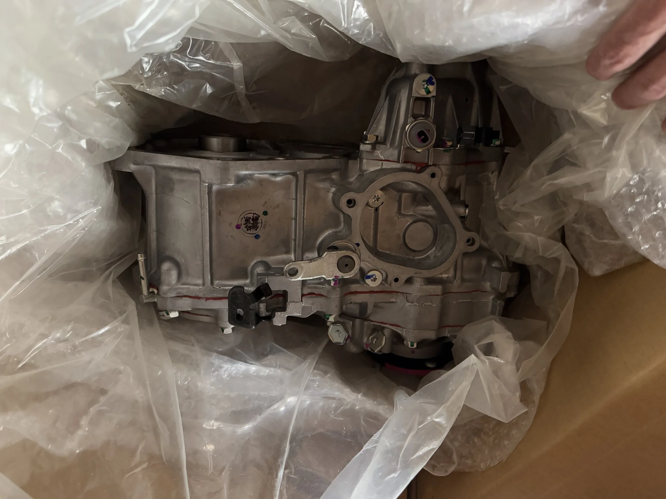

I have a couple of different cases apparently. I have a 36120-60351 from Partsouq, but no shifter mount.
I wonder if you can mix and match case sections like from a 100 series HF2a - use the center case with the shifter mount and the rest of the native 70 series HF1a. @Mr Cimarron did this with converting full manual HF1a to electrically shifter HF1a.
100 series case from HDJ100.
70 series case. 36120-60351.
Looking up GCC spec FZJ100's....could you use a center case section 36036-60290? Partsouq has 4...but no pictures.
