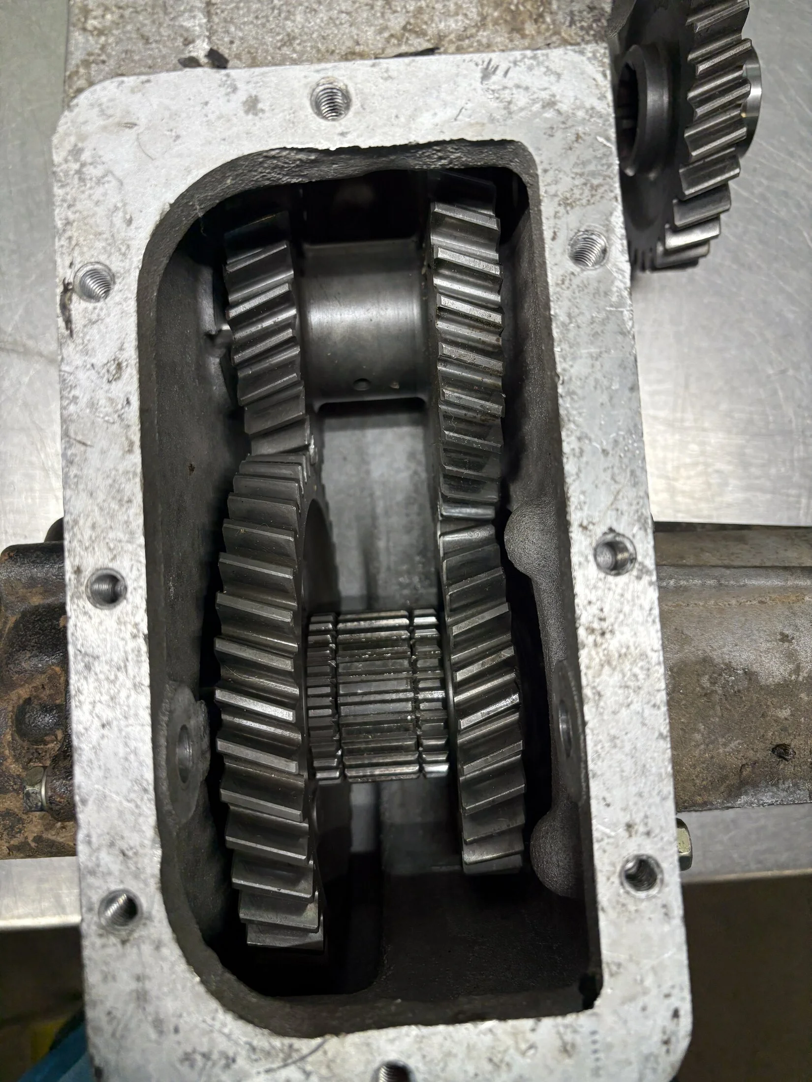

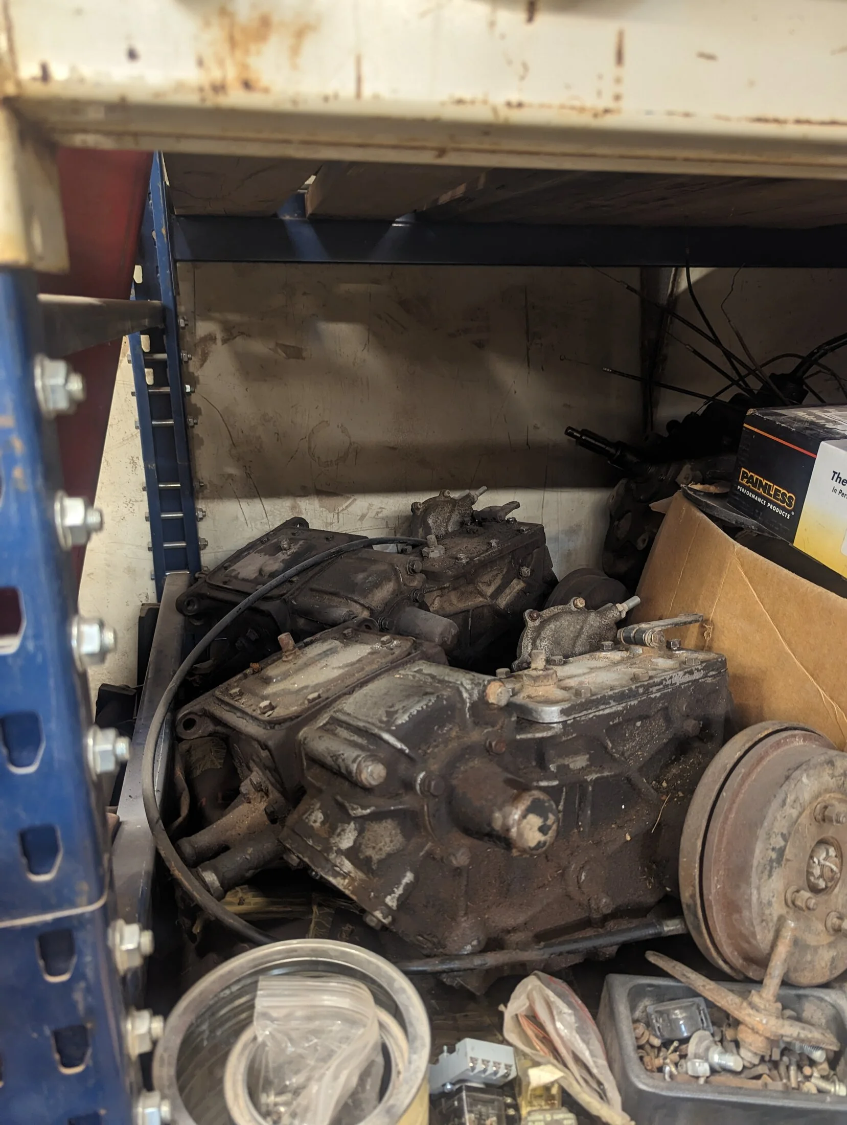

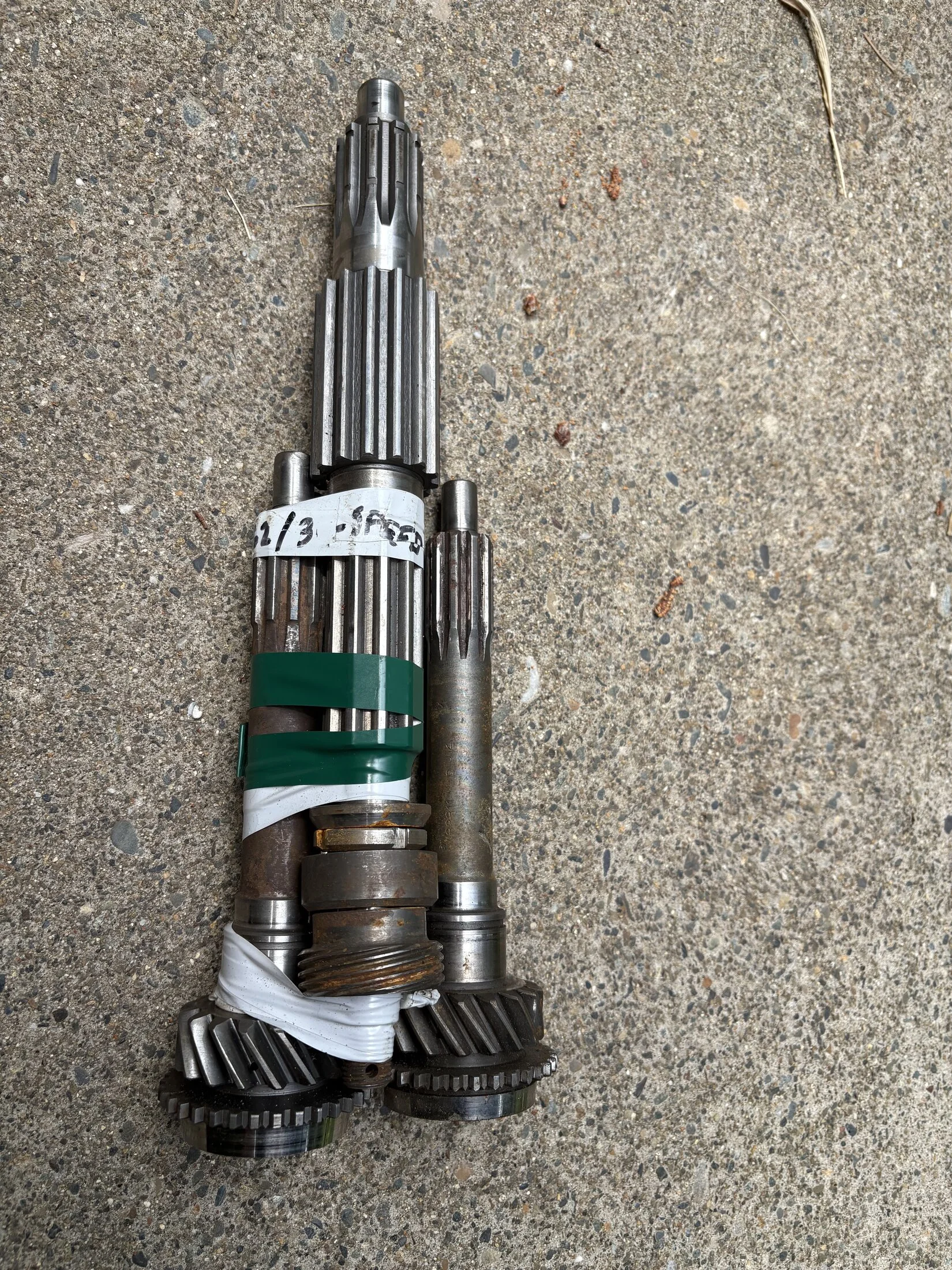

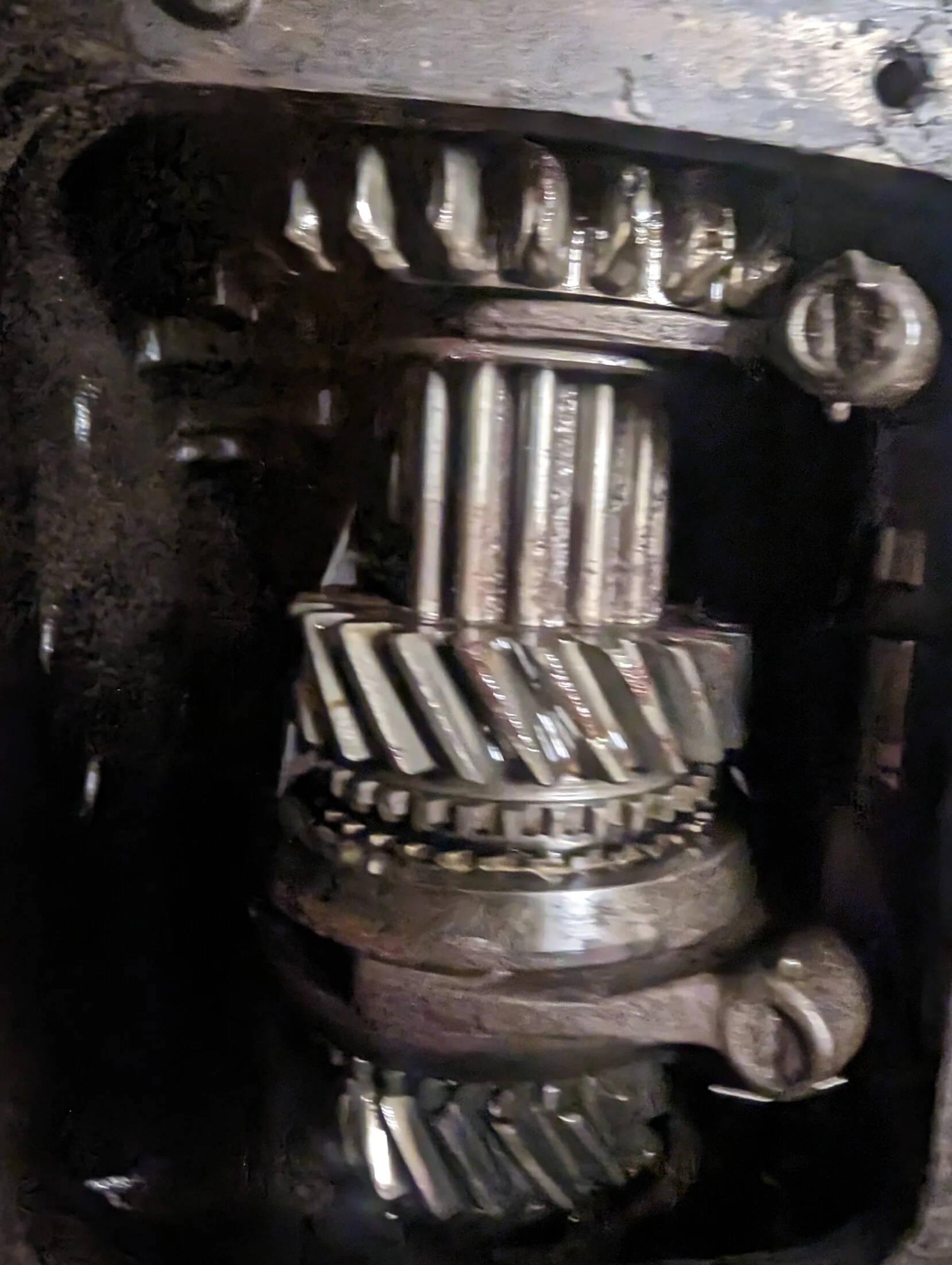

@Living in the Past Thank you for the pictures. Looks exactly like what I need. Let me know what you need to make it worth your time to part with it.
That was two different transmission transfer case setups. I know I have a third one. Can see the transmission gears are better in one. The third one was in very good shape. I posted pictures of that one in the 25 section probably close to twenty years ago. Have no idea the value of these. Had them all at least fifteen years ago.
I’m pretty sure that I sold my last one just a few years ago, either to @tahoe40/45 or @scoobiedubes. They can tell you what one is worth.😉

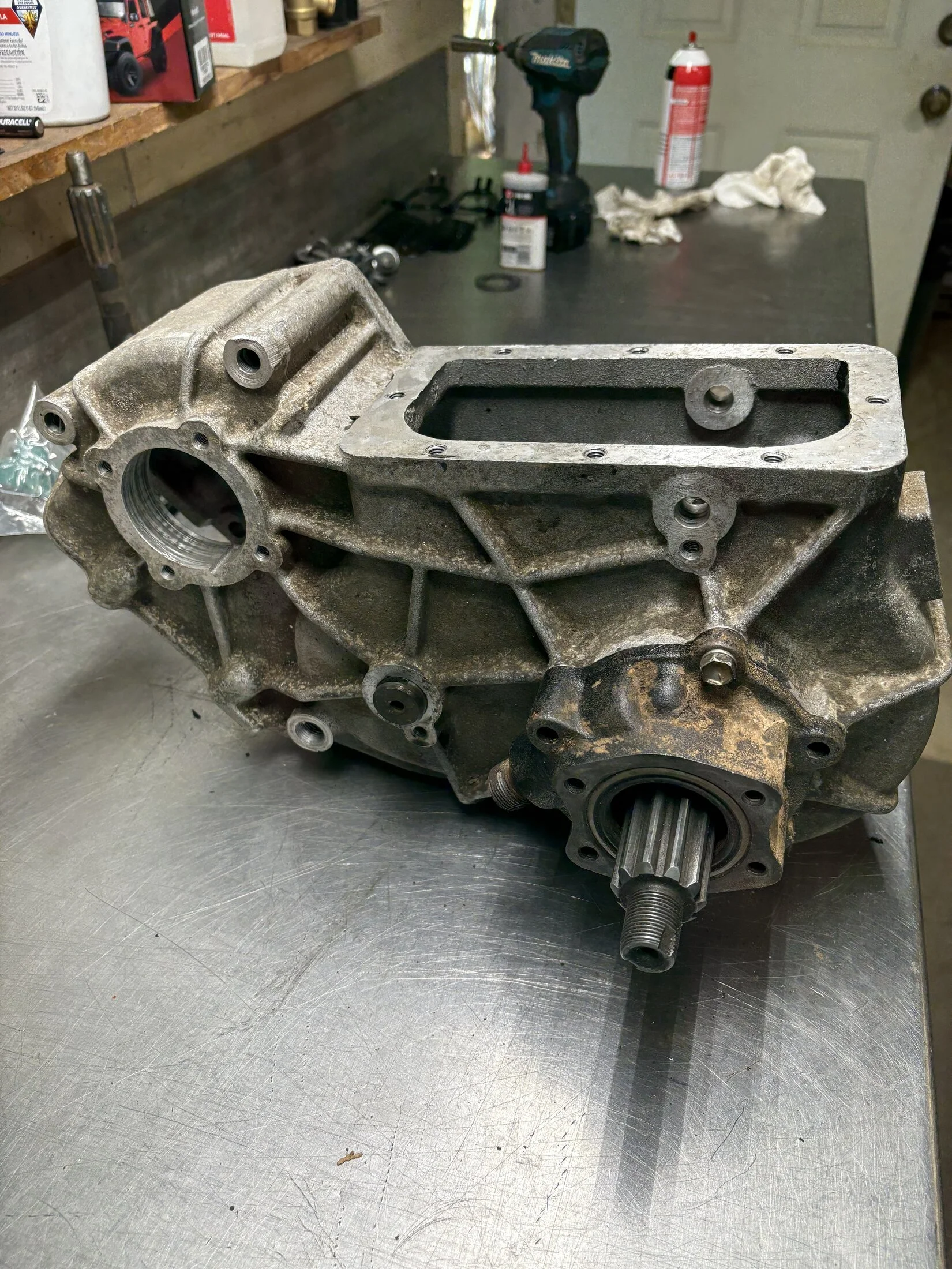

I also do have a good bare transfer case.
Thanks, John. My transfer case looks to be in good shape. It's all the guts that got stripped out of it, unfortunately. I sent you a PM on the shafts.
