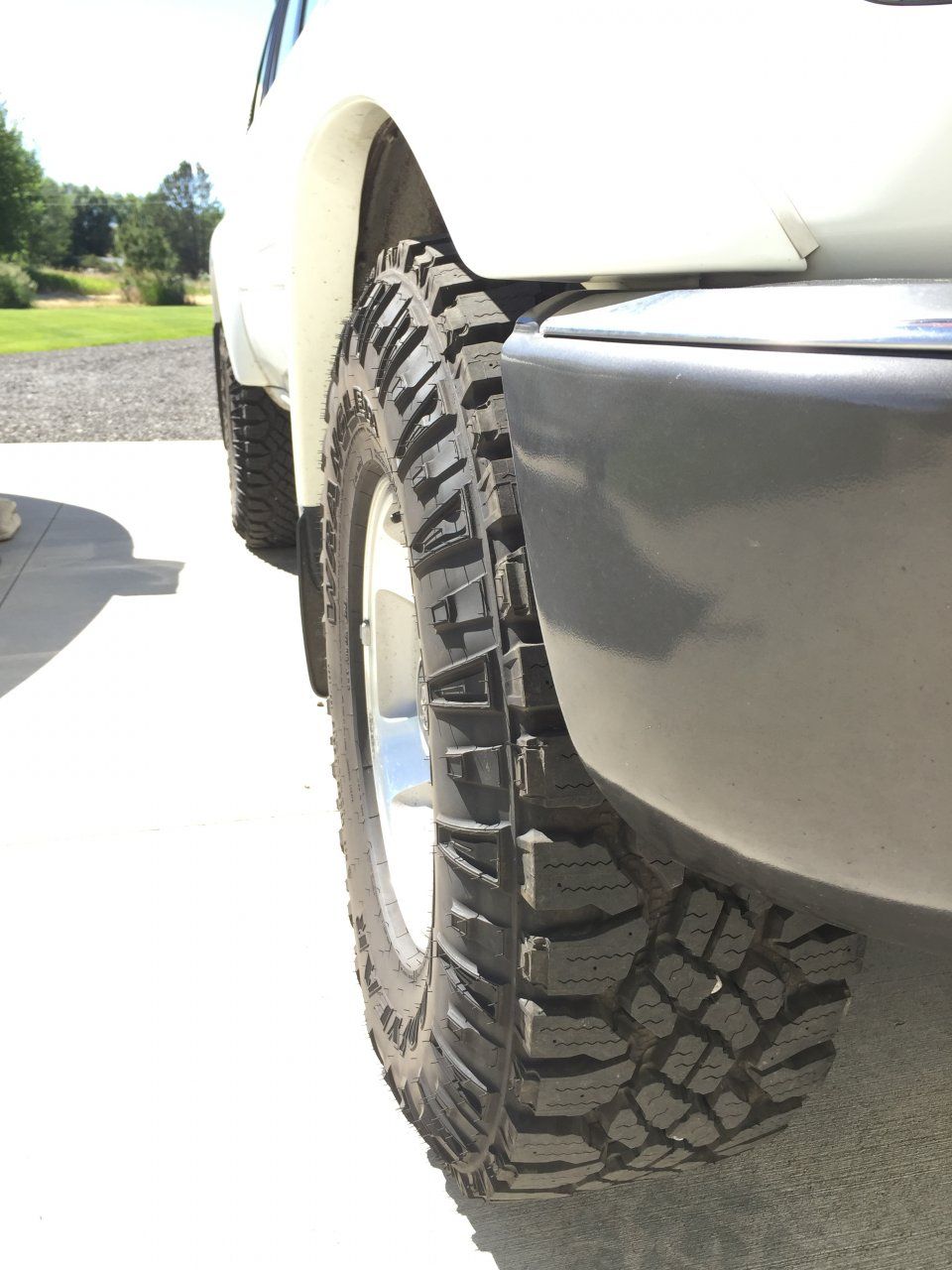

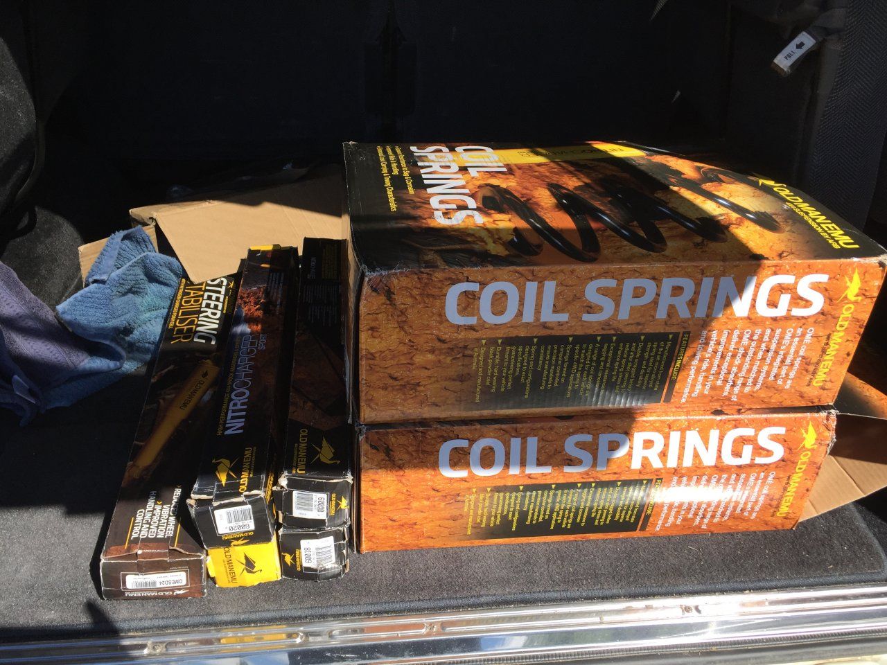

Here she is! Last week she got new 285/75 duratracs, and fedex dropped off my order from Slee, a stock height replacement kit. Wanted to keep her pretty much stock as its cherry! Cheers.
