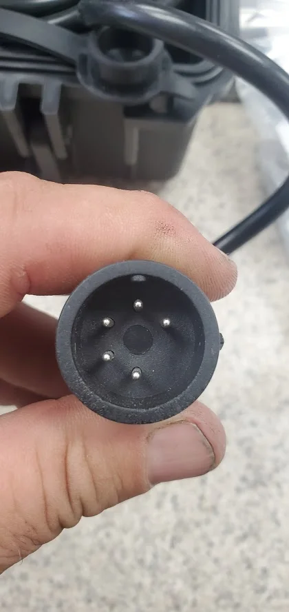

I purchased a second hand 8274. I am replacing the solenoids with a Warn 81400 "albright" style contactor. I also am replacing the socket and remote. The socket I bought is a Warn 39886. The remote I bought is a Harbor Freight 56504. I downloaded the wiring diagram and my socket is off a little bit. The wiring are different colors. I have black, white, brown, red, and green. Also, the notches are different than whats pictured. It shows 2 notches, and mine only has 1, in a different orientation. So, I'm not sure how to orient this socket to wire it properly. I attached pictures of everything, if you guys could let me know how to wire it, or a way to test what wire does what once hooked up I'd appreciate it.

Also, can you share a pic of your socket on your winch, showing where the notch is?
No picture but my notch is at 6 o’clock.
After some reverse engineering using your diagram, description, and colors, I was able to make it work! Well, with a standard wired Warn remote, on a bench, with just the solenoid. Clicks both ways in and out so I assume it will work on the winch.
