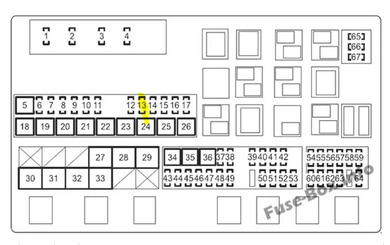

Here is the fuse location for the fogs. The OEM circuit is only 7.5 amps and the aftermarket fogs could be more than that. Mine is set up with an inline fuse and relay triggered by the OEM circuit. You will have to figure out how your is wired.
