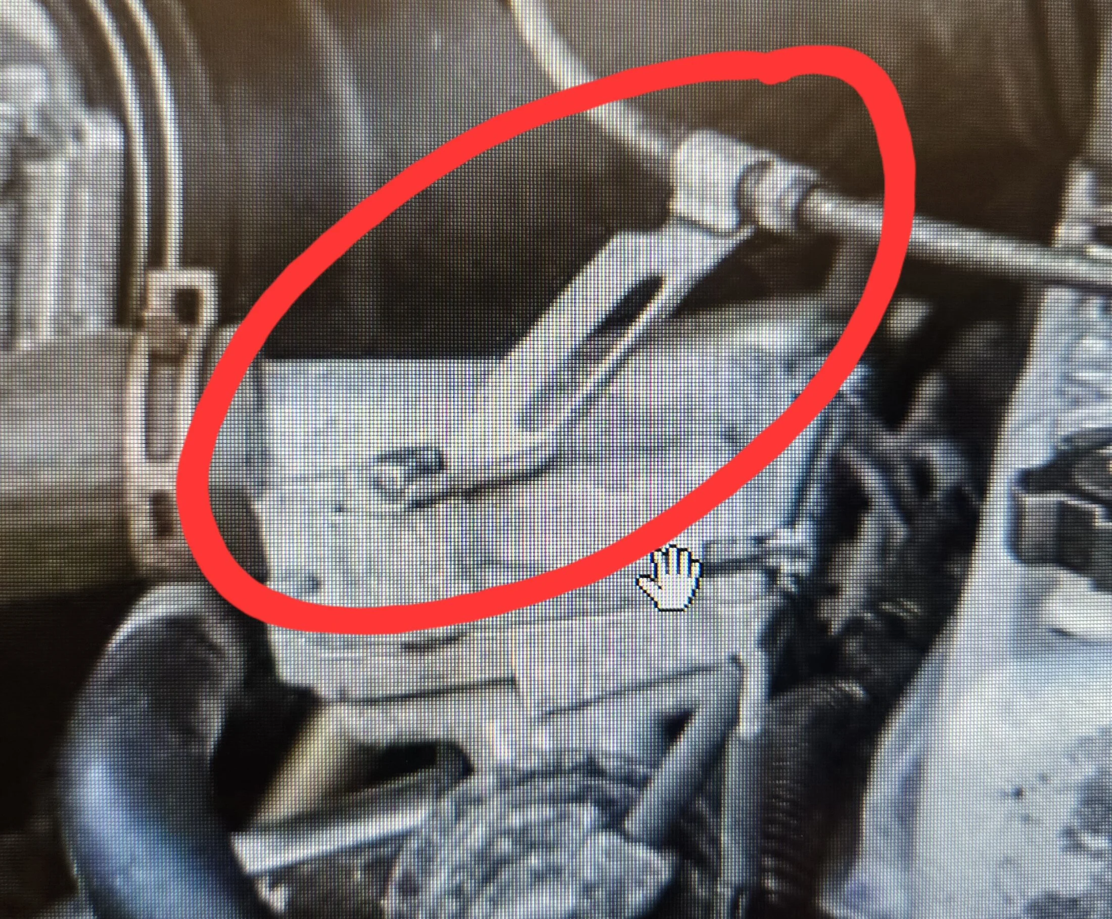

Hi All.
Can someone help identify this part. Mine appears to be missing on my 1994.
Thanks much!!
Is your pair valve deleted? That big box under the throttle cable bracket.
On the later models there's a slightly different bracket attached to the right side of the head designed to hold the accelerator cable higher up so it doesn't droop onto the valve cover. You could probably find either type of bracket (used) in the Parting Out section.
That's one of the accelerator cable brackets. Should be 78185-60040 for a '94. You'll have to find a used one if you want to replace it.
I have several of the 94 brackets if you need one, none of the 95+ currently.
Do you know the part number for the 95+ so he could order it?
