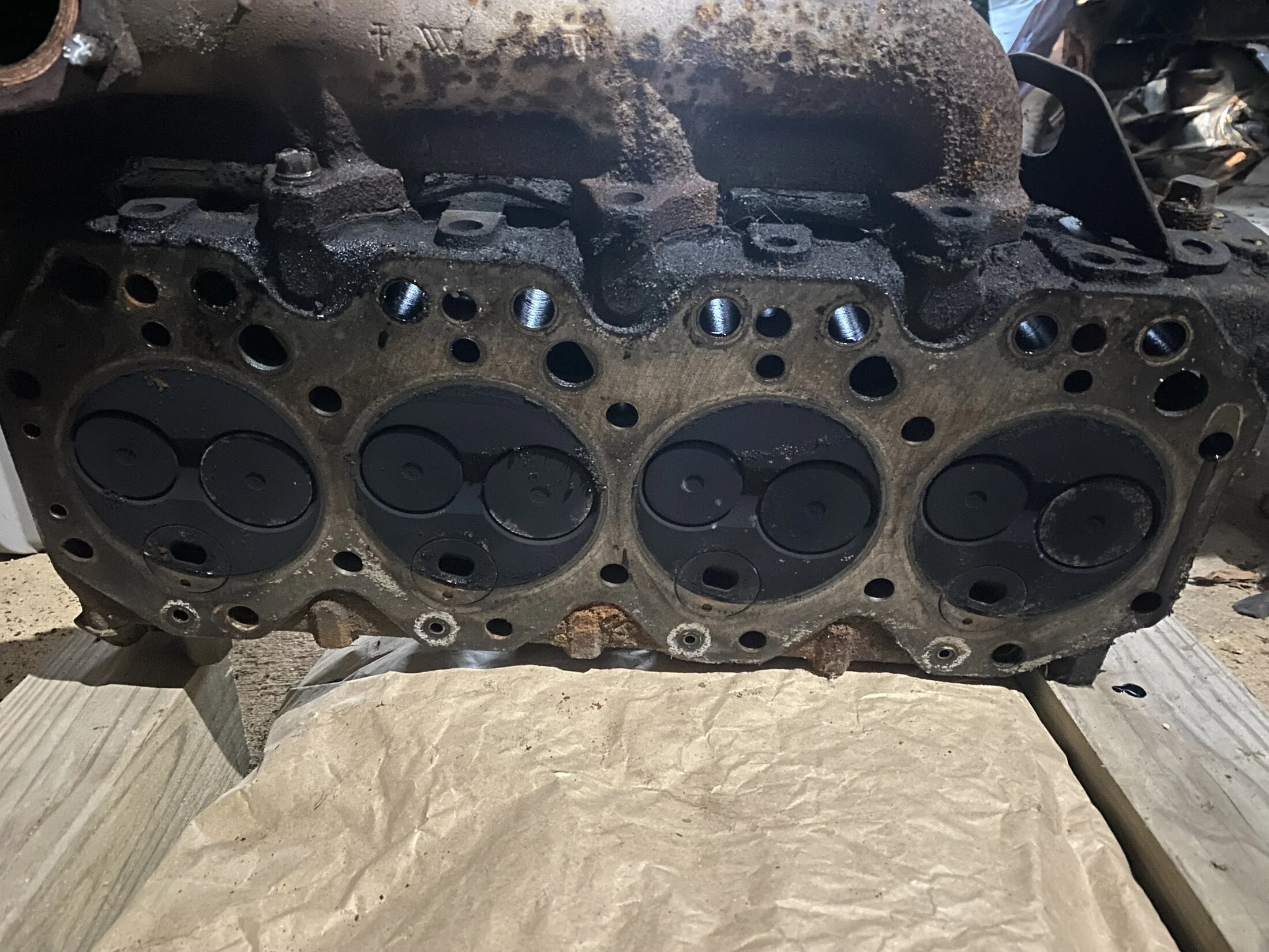

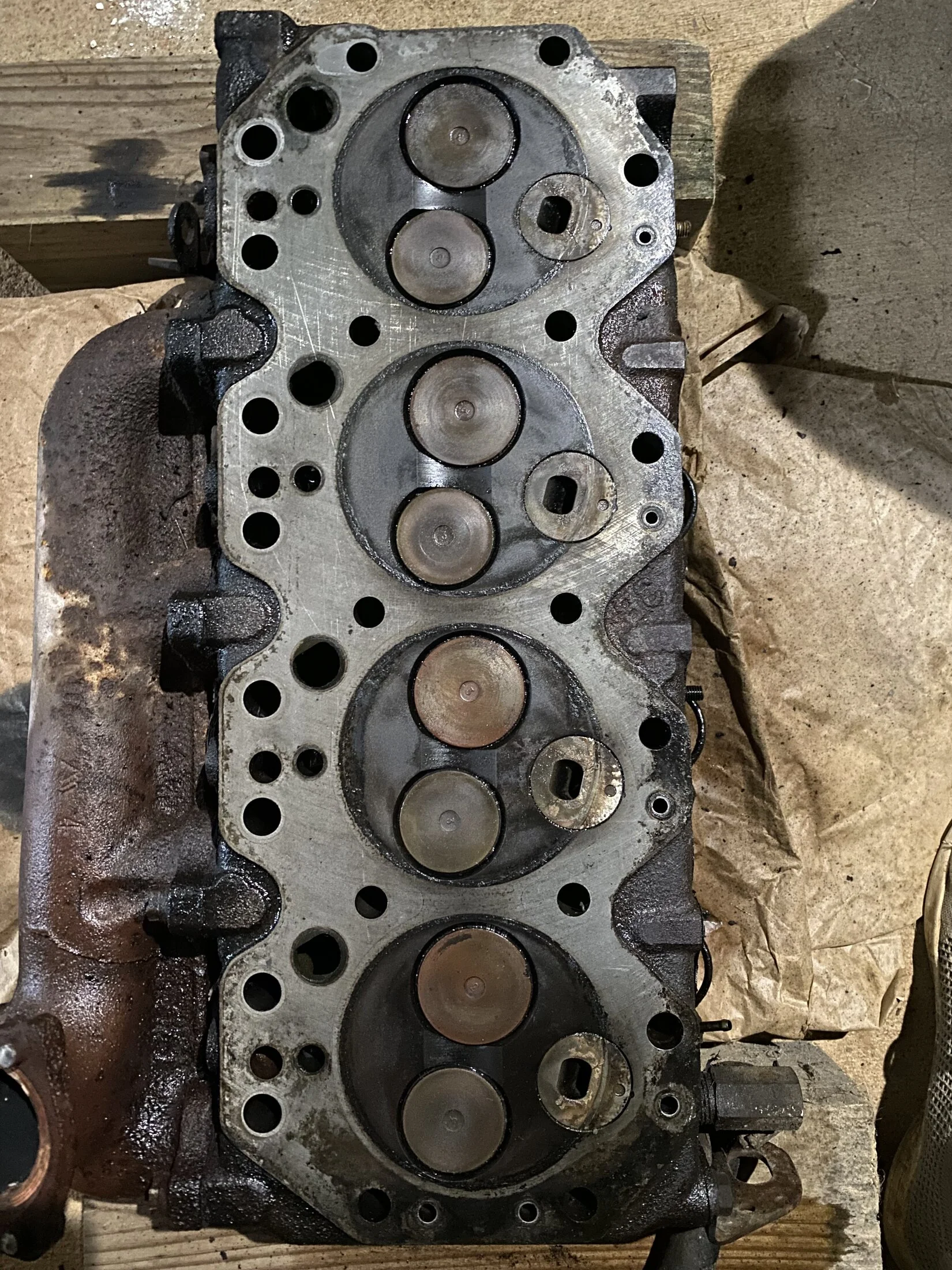

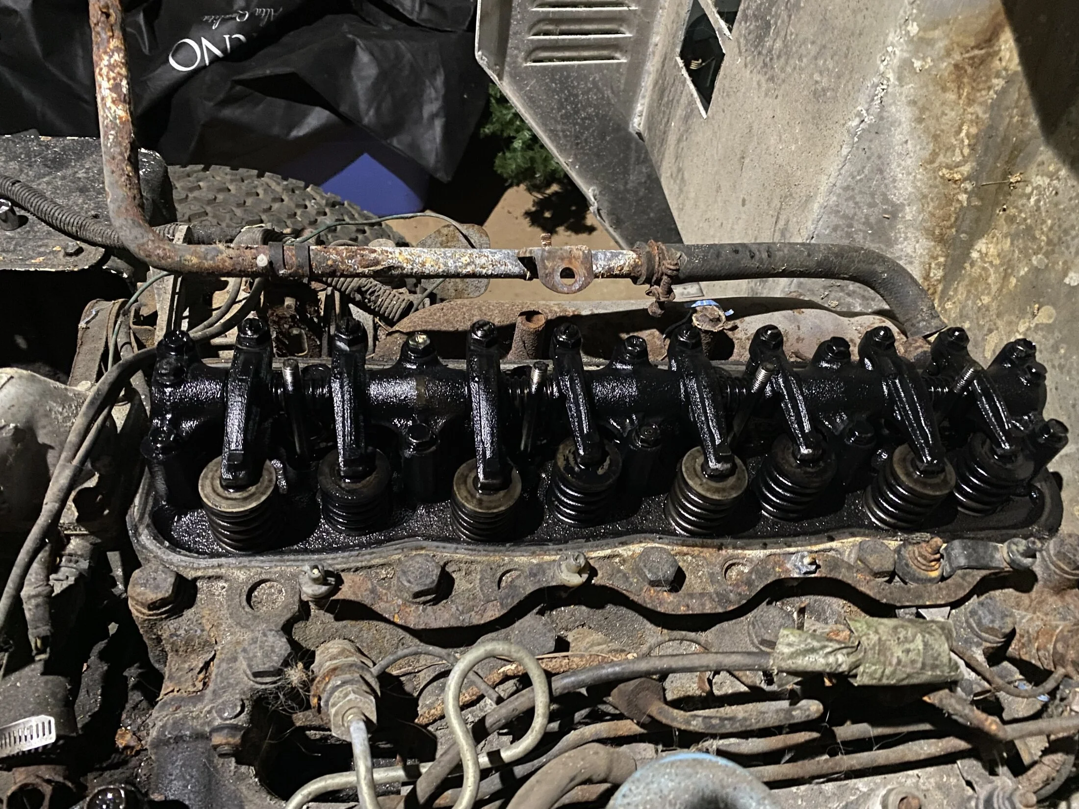

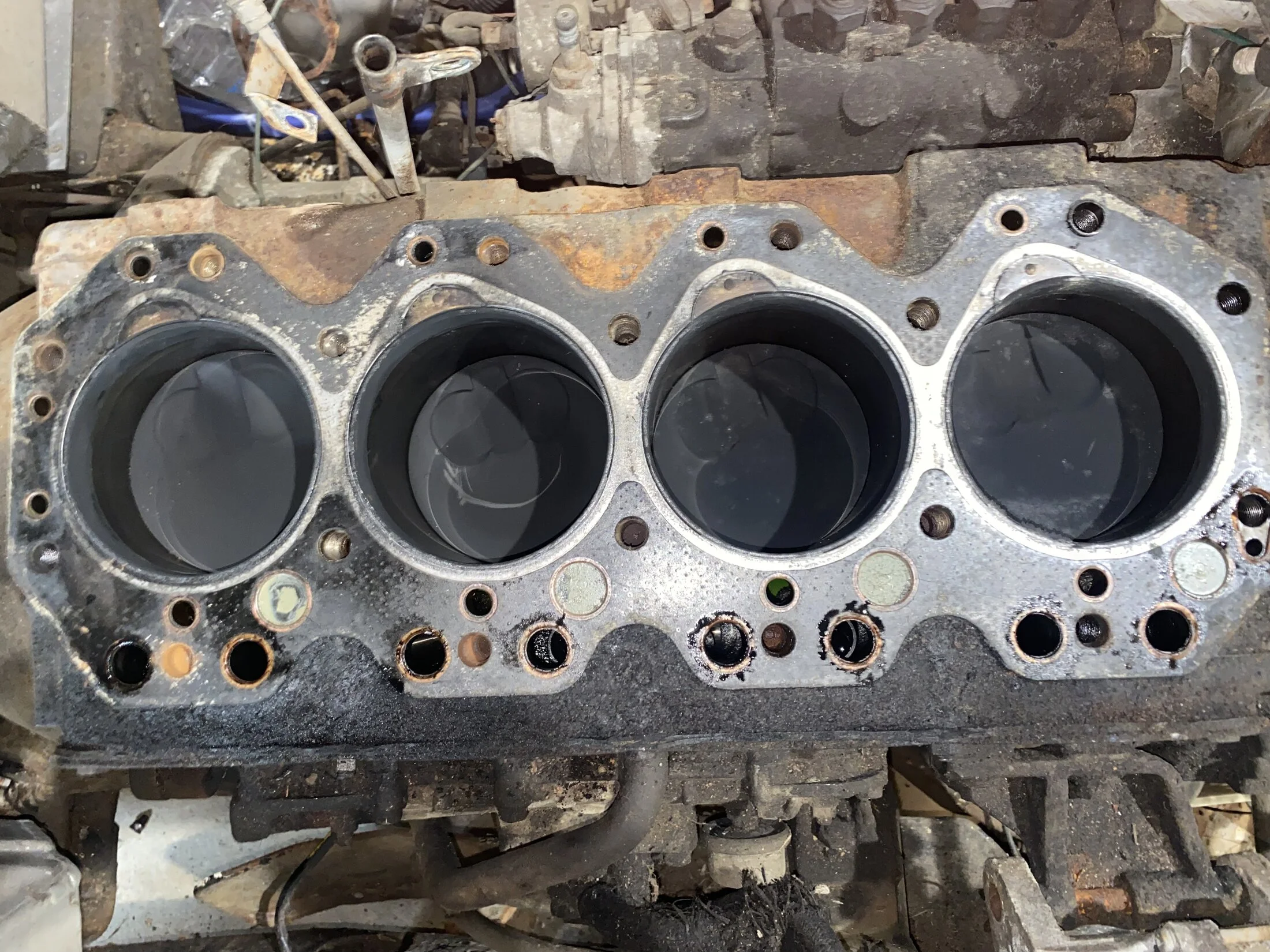

Thanks for the guidance from everyone. I’d like to do this right, so I’m going to try the rebuild (at least in part). I got the engine manual and followed the steps to take off the head to inspect the valve seats and cylinders. I haven’t done any precise measurements, but everything appears to be in pretty good shape to my untrained eye (see photos below). What should be my next step from here?
On first sight that looks very good - the cylinders are all dry, no apparent damage to pistons and head. The head surface looks clean and clearly shows the original machining marks. Looks like that head gasket was not on for long as it is almost intact where it sits on the head.
I would clean up the head surface to look for cracks in between the valves in each cylinder, cracks between valves and pre-combustion chamber, and cracks in the pre-combustion chambers themselves (which are very common). Then valves out to look at valve seats and margins.

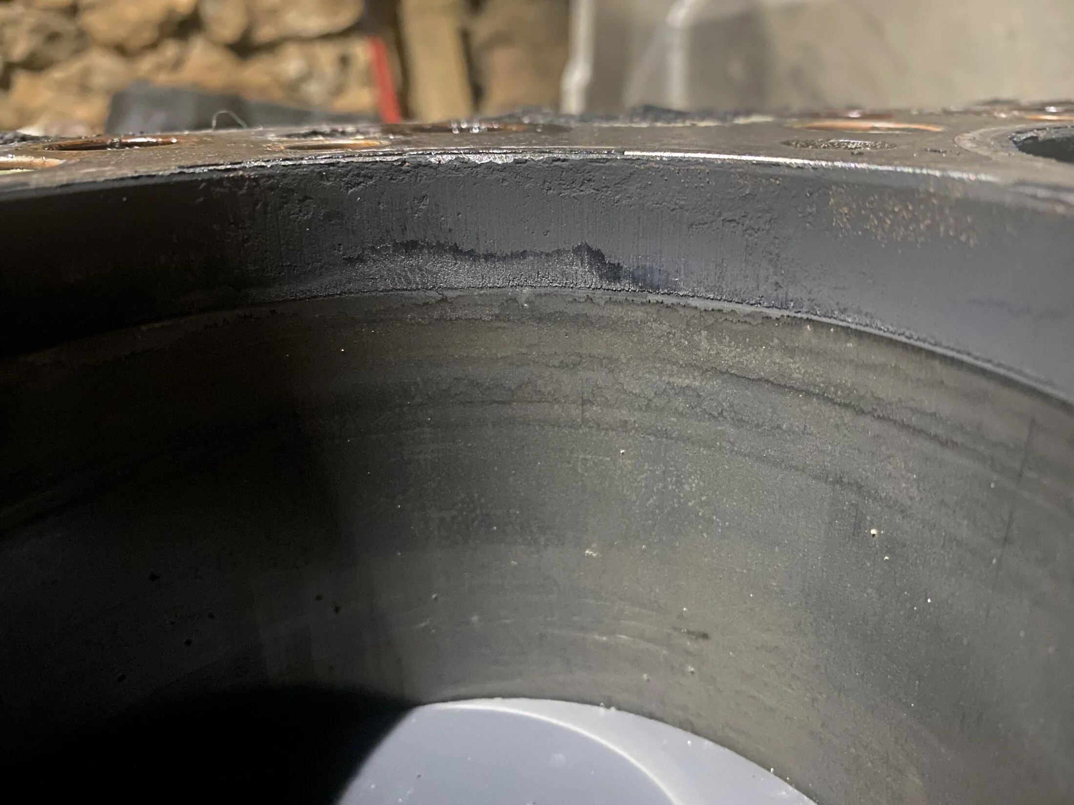

If you turn the engine over, what do the bores look like? Is there a ridge around the top of each cylinder (where the rings don't reach), are there still cross-hatch marks on the cylinder walls?
Engine turns over pretty easily. Looks like there is a small ridge at the top of each cylinder and no cross-hatch marks that I can see (see pic below). Any recommendations for what to use to clean up the head surface?
Clean with a scraper, maybe a brass wire brush to get rid of any harder carbon deposits. Use petrol (gasoline) or something similar if needed. No power tools.

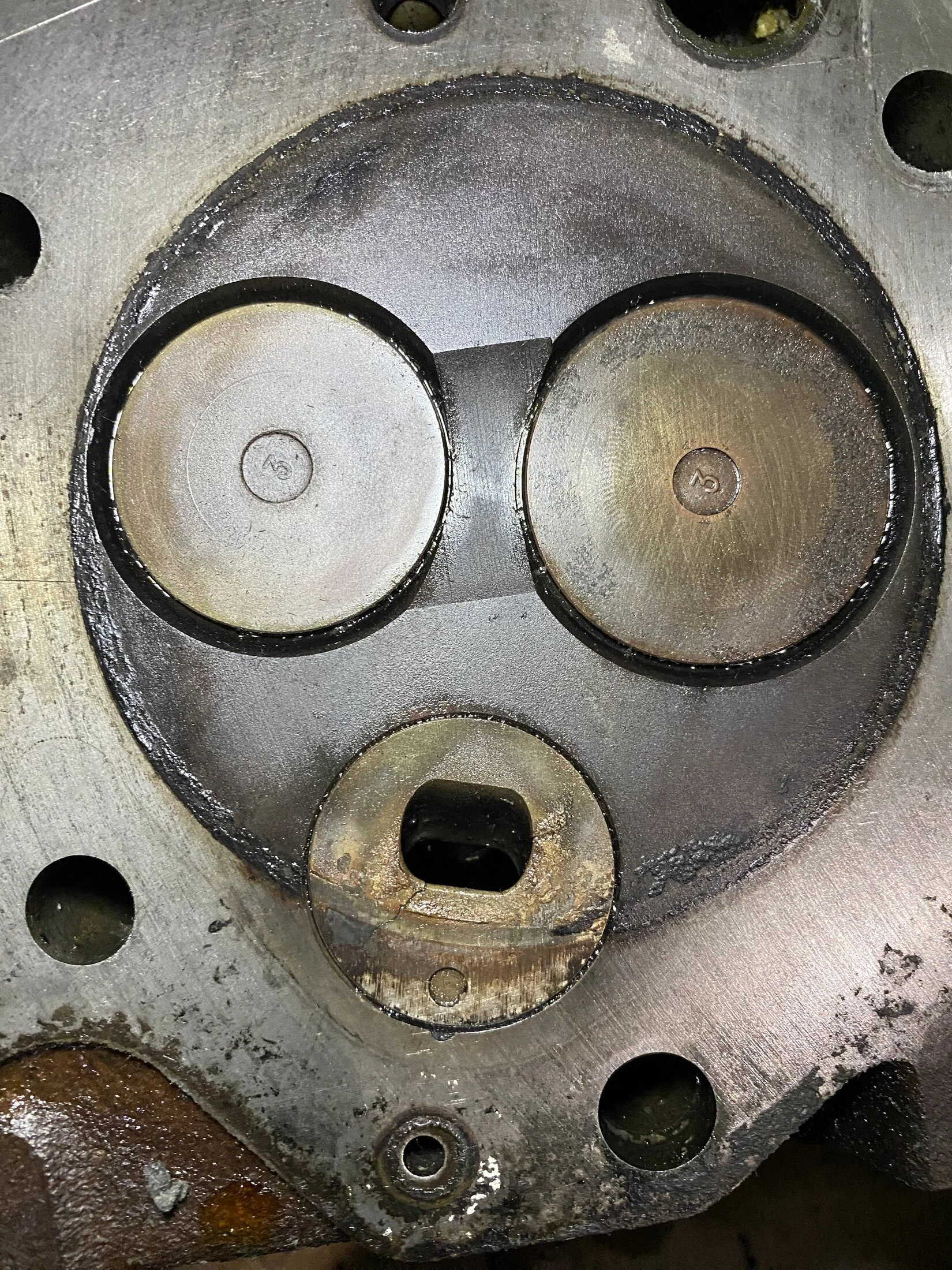

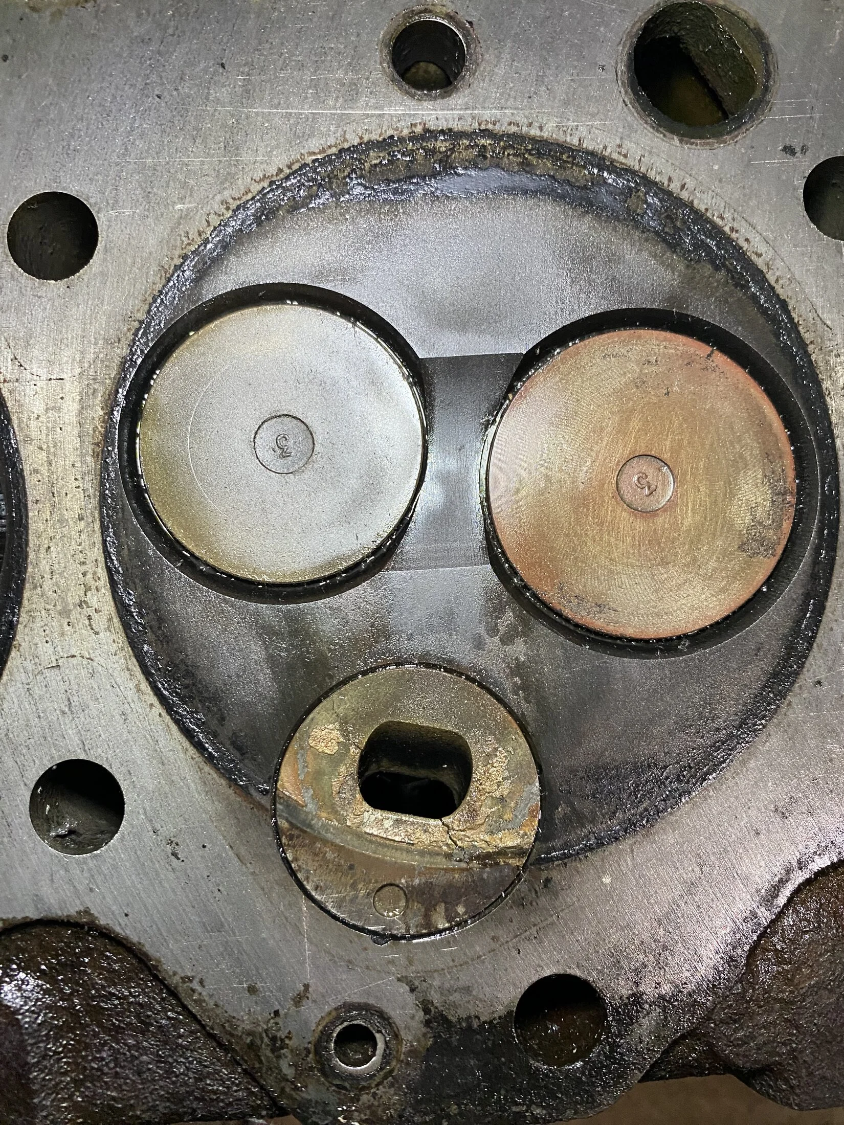

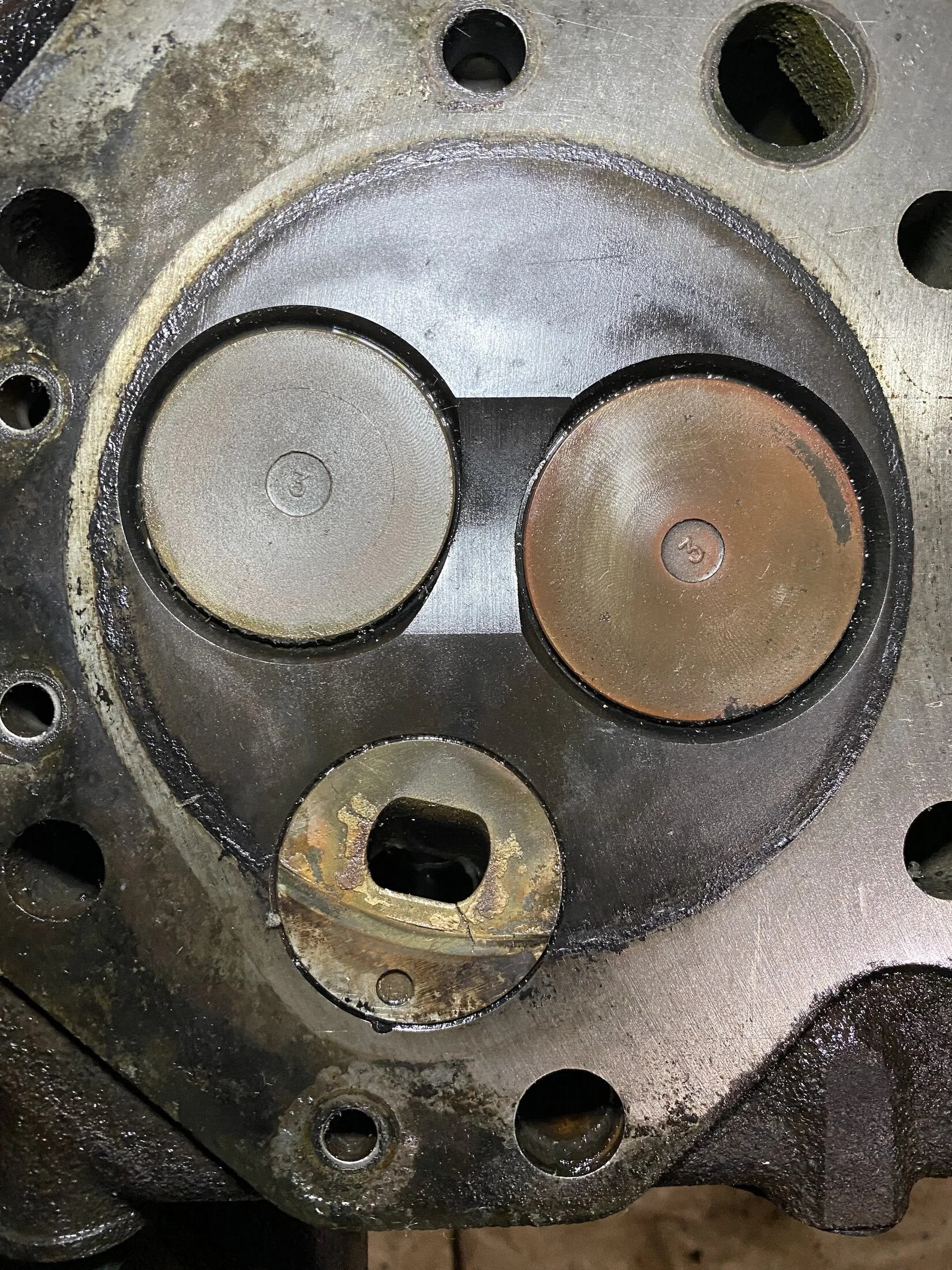

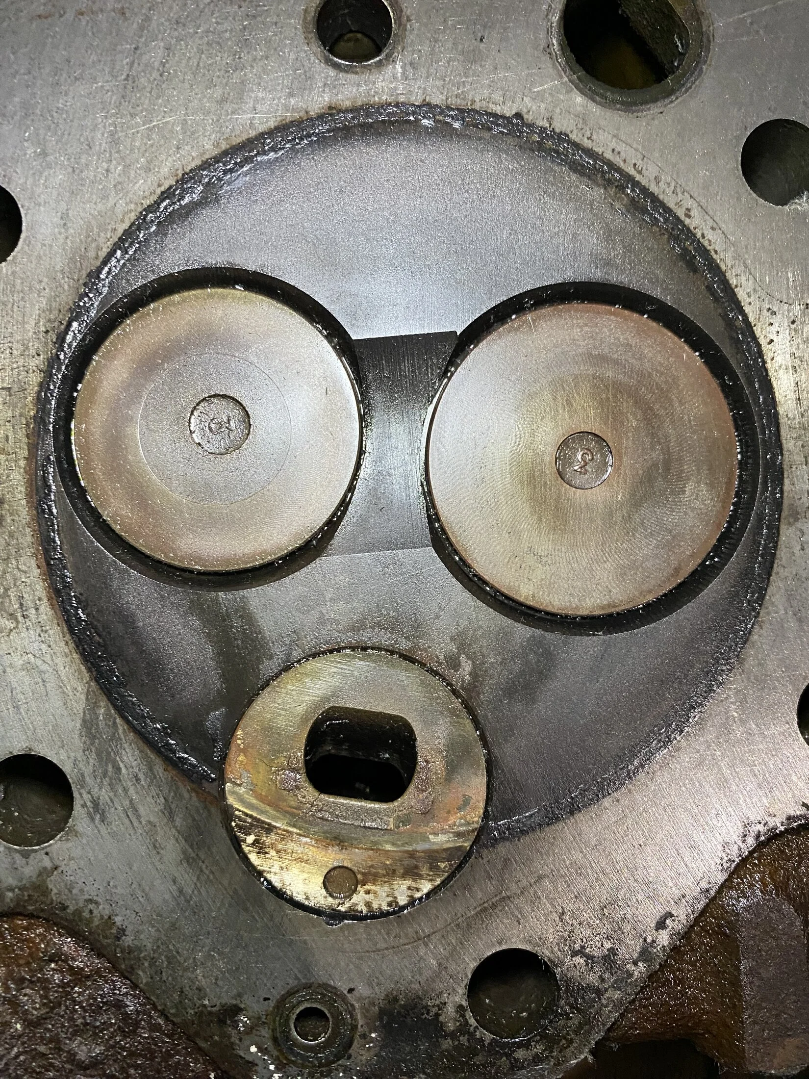

I gave the head a preliminary cleaning, and the only cracks I can find are in the precombustion chambers. I’m guessing these will all need to be replaced, but I guess my next step is to remove and inspect the valves? Here are some pics of the head:
