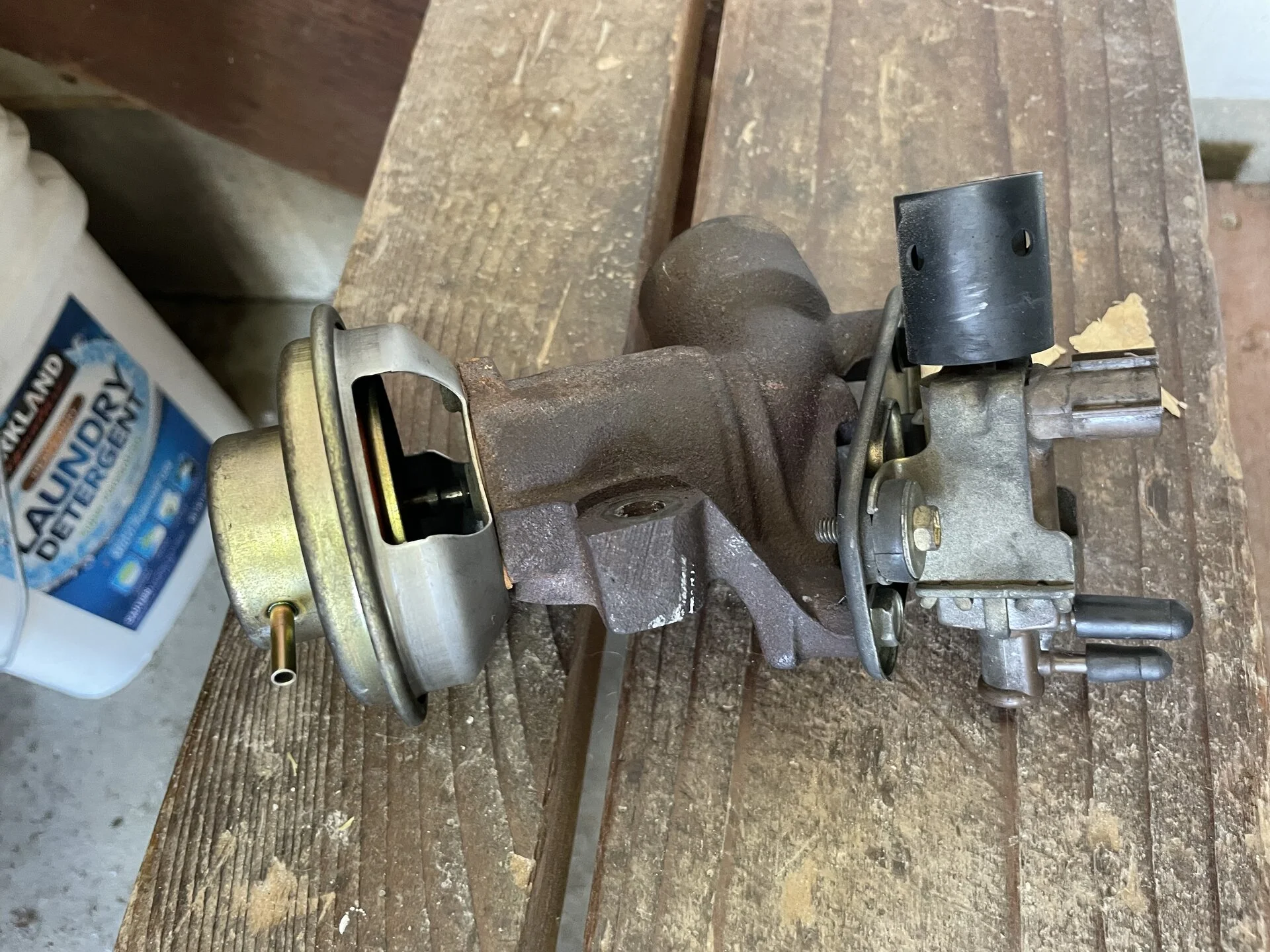

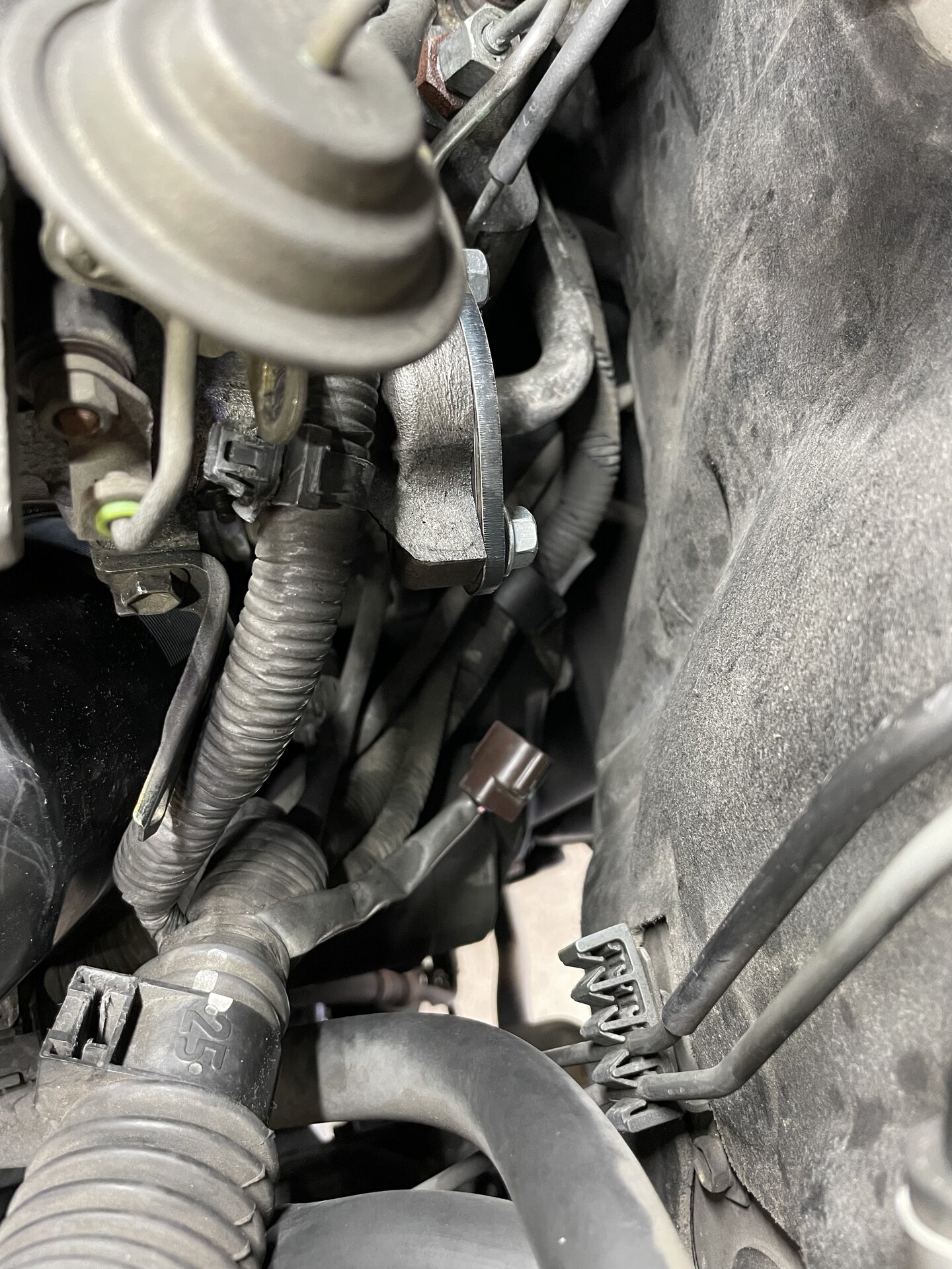

Hey everyone
I just got done deleting the Egr on my 1997 hilux surf with the 3.0td and factory inter cooler. I used the blockoff kit from vanlife northwest and installed an egt temp probe on the exhaust plate. I cleaned a ton of carbon buildup out of the intake manifold and intake ports. I bled the injector fuel lines by cracking them open at idle for a couple seconds.
The truck idles at 900rpm now instead of the 700 it used to be at.
Any help would be greatly appreciated, the truck was running great prior to the delete with no tick or anything.
