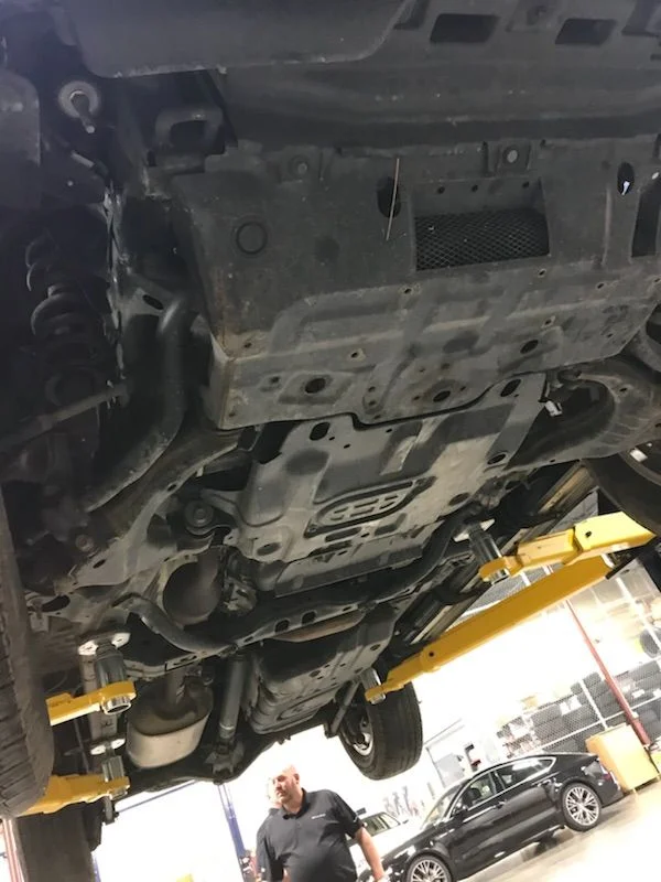

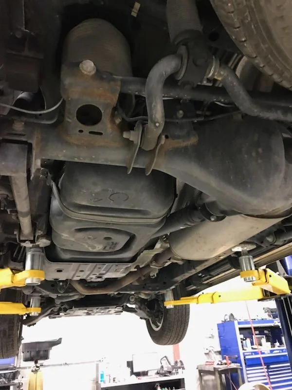

Looking to buy this 2010 Premium today and curious how you guys would rate this undercarriage. Is it clean enough? It's one of two in the color I've been looking for and is low mileage. Thanks in advance!
Looks fine to me. I have some of those rust stains on my rear axle weld seams as well. I haven't done anything about it yet, but you could throw some rust preventer on those seams and then top it with some fresh paint if you want.
I would say that is pretty clean for a 7 year old vehicle, might want to look under the plastic skid plates and stuff but based on the rest I doubt you would find any surprises.
